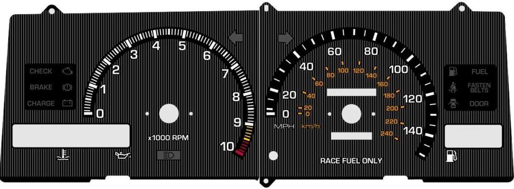

In the meantime I'm researching options to have some alternative gauge faces produced (not just an overlay).
Drawing some inspiration from WWII aircraft cockpits:
[Image: AEU86 AE86 - Analog gauge cluster tech]
I have some OEM style ones in the works.. and perhaps kouki-style pinstripes will also follow.
This might be an alternative solution for those with inaccurate speedometers due to gearbox / final drive swaps, I can create just about any scale you can think up.. just needs some careful measuring for solid reference points.

Kouki 10k has been done before.. I'm not a big fan of the pinstripe myself but it should end up looking roughly like this:

(02-01-2015 01:49 PM)Ivan141 Wrote: [ -> ]Kouki 10k has been done before.. I'm not a big fan of the pinstripe myself but it should end up looking roughly like this:
Not a huge fan either but that's what I've got and the speed side is fine being EU kmh spec
Who made these and can I order one?

A Club4AG member had these made for about 150 dollars I believe... in decent quality I might add. Can't remember which shop produced them though.

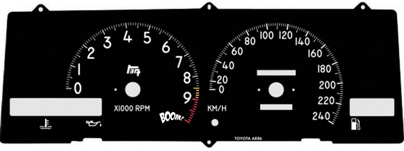

02-05-2015, 07:00 PM (This post was last modified: 02-05-2015 07:00 PM by d3nso.)
Something like this as EU Spec for the right money and I'm in Thumbs up!

02-05-2015, 10:53 PM
Producing something like this in acceptable quality is not very easy.. I still need to speak to some acquaintances who are in the graphical business to discuss the options (avoid finding out the hard way what wont work).

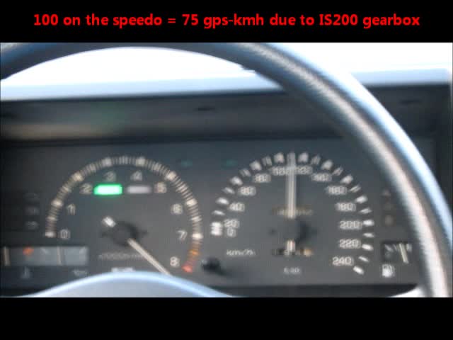

Hi Ivan
I would be very interested in a custom gauge. 10K scale with 9k redline and 8500-9000 yellow zone. Also running the IS200 gearbox my speed is off. 100kmh equal 75kmh gps.
The rpm obviously need to be recalibrated but I don't care much about the speed.
Two quick ideas. Second one would probably be jinxing it Confused
