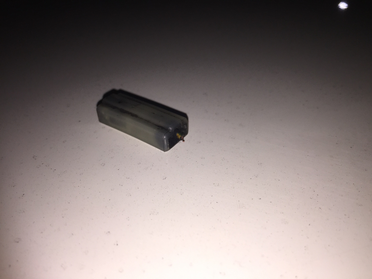

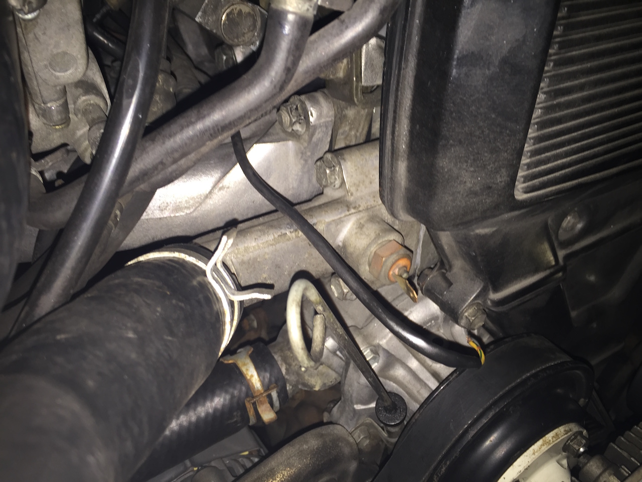

The car has got a replacement engine after a head gasket problem. Today I received it with high hopes to this weekend the water temperature reading stopped working. The wire to the Water Temperature Sender Gauge has been disconnected by heat. Any known causes for this? I suspect a loose connection which produced heat.
I should be able to diagnose if the sensor is still working with a meter, but maybe all I need is a clean new connector?

get a crimp blade connector an reattach the wire Smile

The cable most probably gave up because of fatigue if anything. Just like d3nso wrote, just crimp on a new connector.

Thank you. The funny thing is, the car has been checked by Carland86 before delivery a few weeks ago. Then the replacement engine by KMS. One would think the wire would fail at their garages, not hours after delivery. What a bad luck. Tongue
What about heat isolation for the wire? Is that sort of measure necessary to avoid similar future problems?
Thank you very much.
12-06-2017, 10:30 AM (This post was last modified: 12-06-2017 10:30 AM by d3nso.)
Water Temperature Instrument not moving - Sender Gauge
Isolation against heat isn't needed a quick wrap with electrical tape does the job if your're paranoid Tongue

I fixed the connector, the gauge is moving up.
