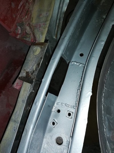

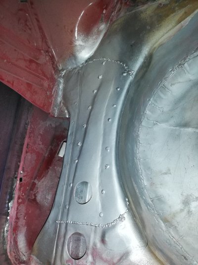

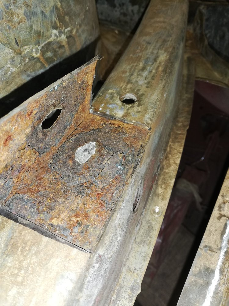

Yep, drilled them off & hammered them out.... One was a bit torn, but no corrosion so just mig'd the tear & plug welded it back on with epoxy primer inside.[Image: AEU86 AE86 - AE86 booter]

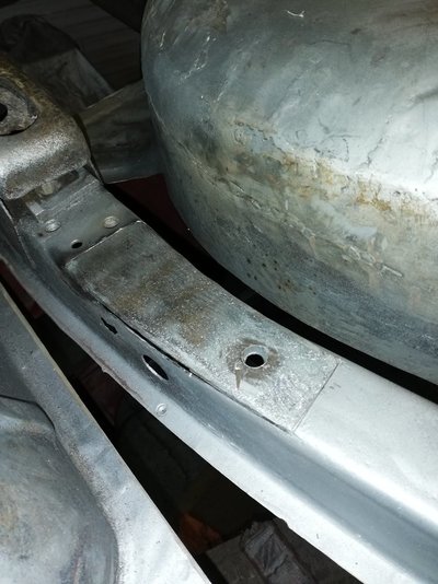

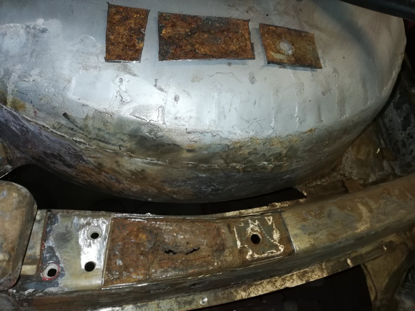

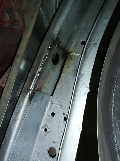

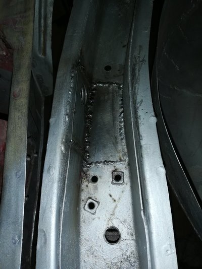

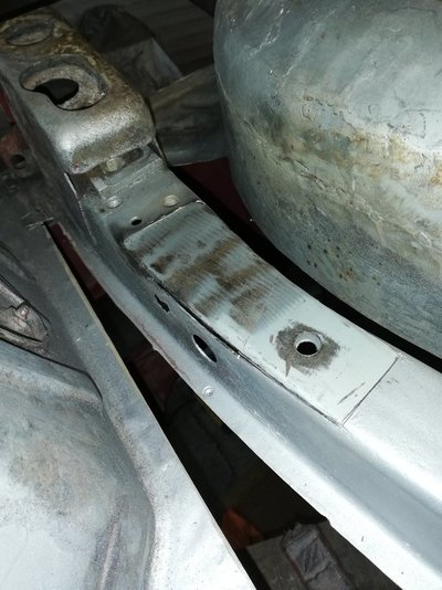

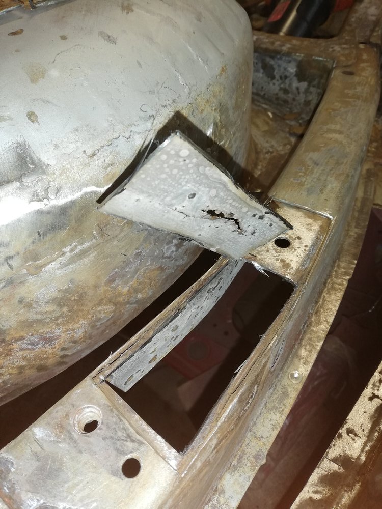

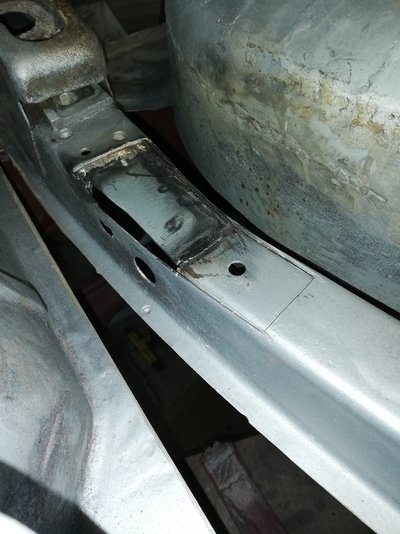

Also decided to open up a scab about the size of a thumbnail on one of the rear chassis rails:
[Image: AEU86 AE86 - AE86 booter][Image: AEU86 AE86 - AE86 booter][Image: AEU86 AE86 - AE86 booter][Image: AEU86 AE86 - AE86 booter]
[Image: AEU86 AE86 - AE86 booter][Image: AEU86 AE86 - AE86 booter][Image: AEU86 AE86 - AE86 booter][Image: AEU86 AE86 - AE86 booter][Image: AEU86 AE86 - AE86 booter][Image: AEU86 AE86 - AE86 booter][Image: AEU86 AE86 - AE86 booter][Image: AEU86 AE86 - AE86 booter][Image: AEU86 AE86 - AE86 booter]
...there! I'm happy with that
