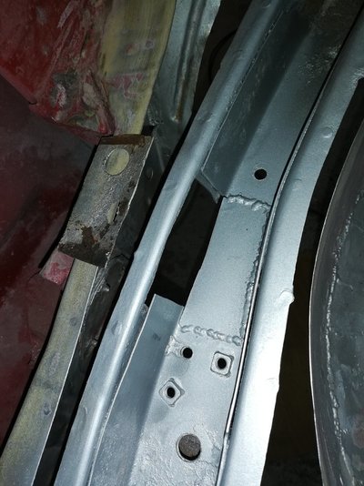

Yep, drilled them off & hammered them out.... One was a bit torn, but no corrosion so just mig'd the tear & plug welded it back on with epoxy primer inside.[Image: AEU86 AE86 - AE86 booter]

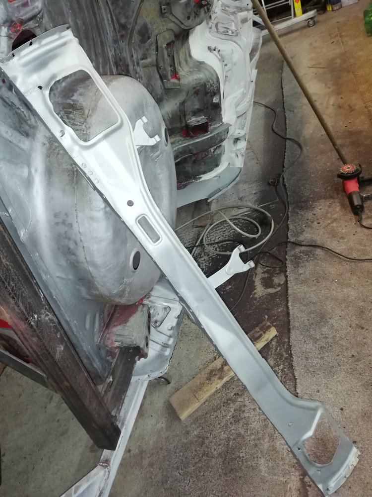

Rear valance removed and repaired, ready to reinstall[Image: AEU86 AE86 - AE86 booter]
Sent from my ANE-LX1 using Tapatalk

Probably about time I updated this thread....Rear valence now ready for installation[Image: AEU86 AE86 - AE86 booter]

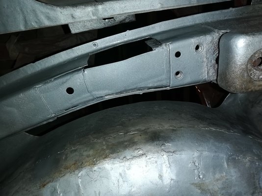

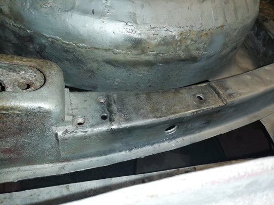

Also decided to open up a scab about the size of a thumbnail on one of the rear chassis rails:
[Image: AEU86 AE86 - AE86 booter][Image: AEU86 AE86 - AE86 booter][Image: AEU86 AE86 - AE86 booter][Image: AEU86 AE86 - AE86 booter]
[Image: AEU86 AE86 - AE86 booter][Image: AEU86 AE86 - AE86 booter][Image: AEU86 AE86 - AE86 booter][Image: AEU86 AE86 - AE86 booter][Image: AEU86 AE86 - AE86 booter][Image: AEU86 AE86 - AE86 booter][Image: AEU86 AE86 - AE86 booter][Image: AEU86 AE86 - AE86 booter][Image: AEU86 AE86 - AE86 booter]
...there! I'm happy with that
