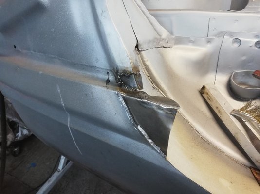

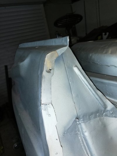

[Image: AEU86 AE86 - AE86 booter]
outside and in....

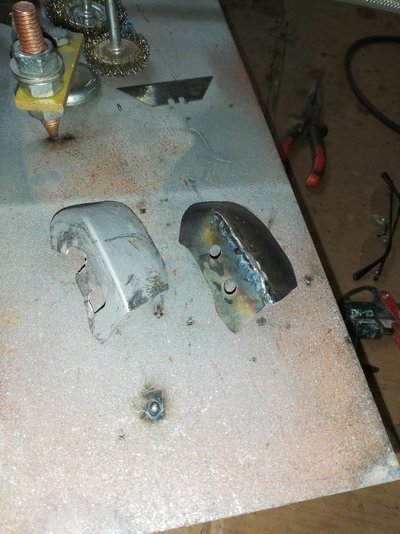

[Image: AEU86 AE86 - AE86 booter][Image: AEU86 AE86 - AE86 booter][Image: AEU86 AE86 - AE86 booter][Image: AEU86 AE86 - AE86 booter]
....and nearly there

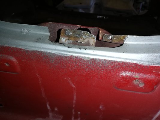

And finally (?) a niggling little whole at the bootlid catch area...

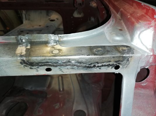

And of course, more niggly little bits...

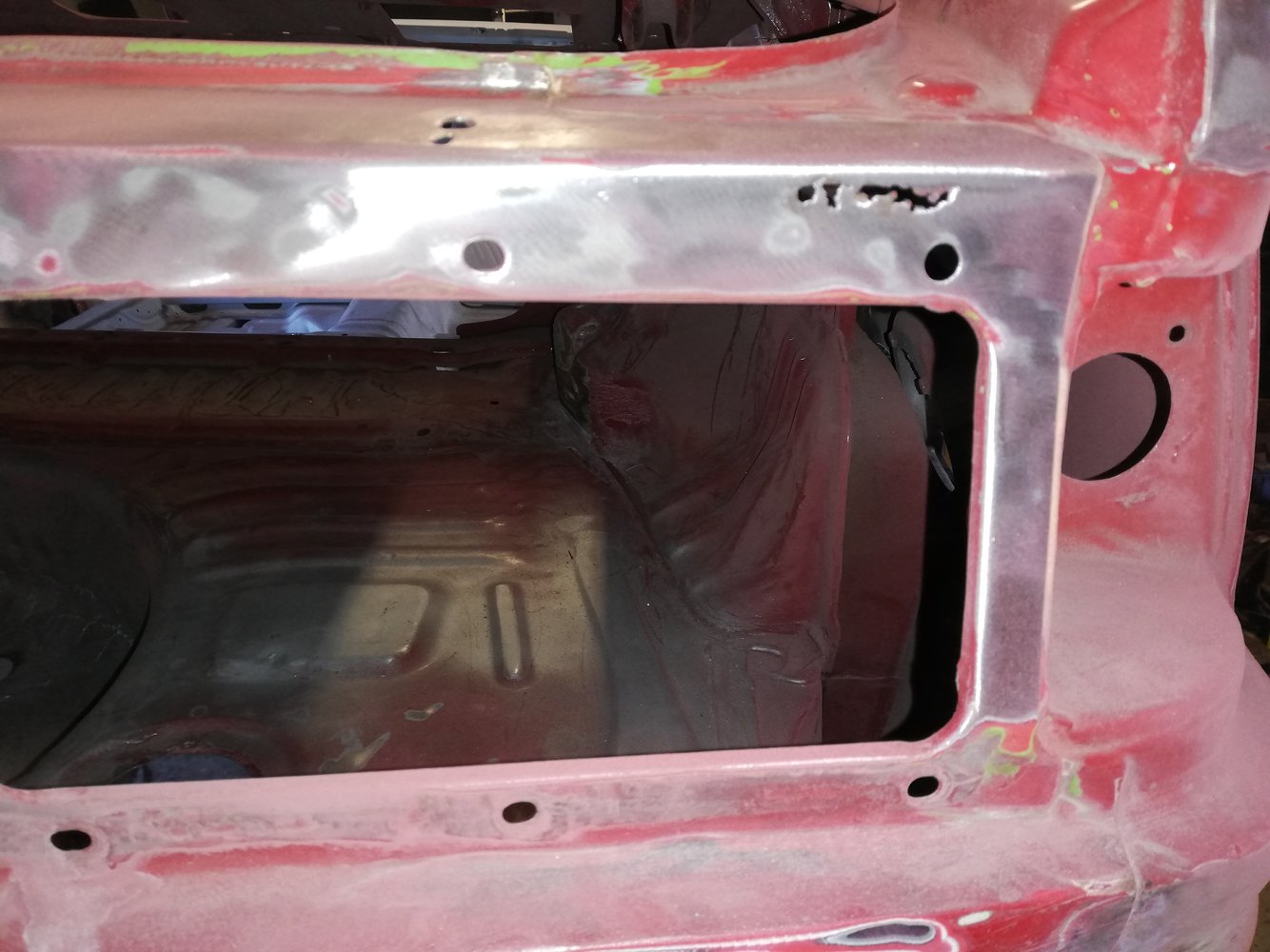

At this stage I thought I was ready to `key`the epoxy primer on the underside and finish with a final coat over the entire underside. However, things took a serious turn for the worst....
I spotted this:
Which when I investigated further with a razorblade turned into this:

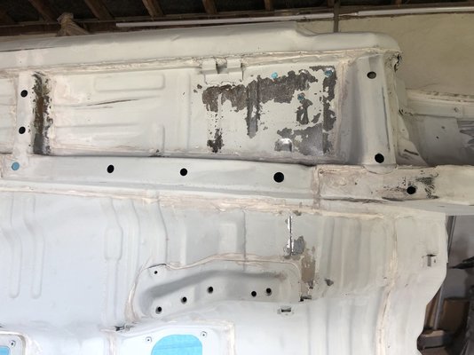

So I then tackled it with a needle-gun to reveal more

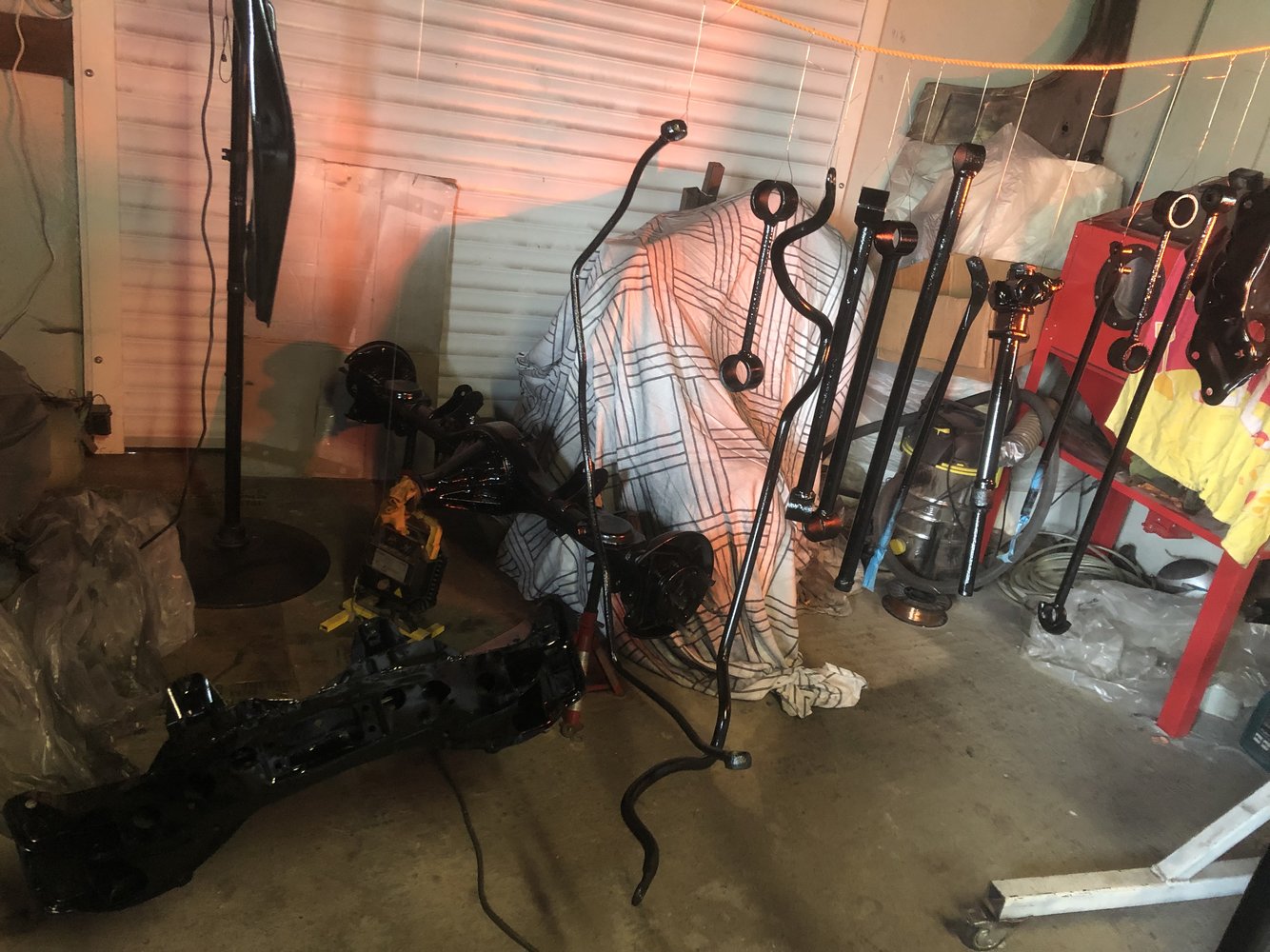

So while contemplating what to do, I found a local blasting firm and got the axle, front subframe and various suspension rods and links blasted
All elevated and ready for spraying. I used Rustbusters epoxy mastic in black; EM121
Not perfect, but it won't be seen that easily as it all goes underneath the car. I found that even though I had thinned and preheated the paint, it started to go off in the gun after a period of time, so it needed to be further thinned..

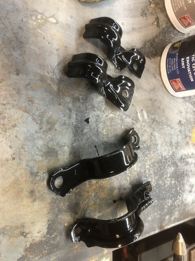

I thought I may as well do the steering rack brackets and the radiator brackets while I had paint in the gun...

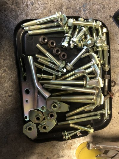

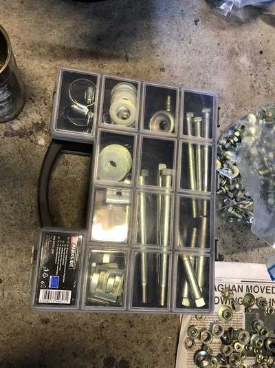

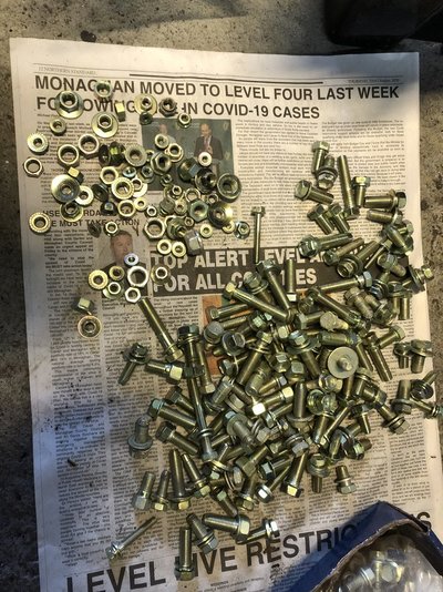

...My project didn't come with much in the way of bolts or fasteners, but I happened across a guy breaking an ae86 & he was good enough to sell me his bucket of bolts:

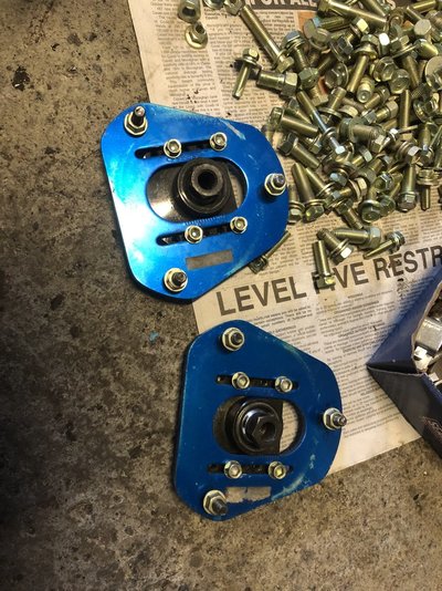

The camber plates benefitted from some new pillowball bearings and plated hardware:
