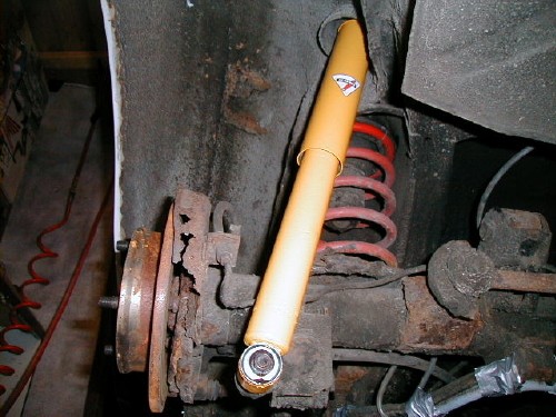

04-10-2005, 11:03 PM
Suspension modification
my rear set up...
KONI yellows set to 85% of max, twin swaybars

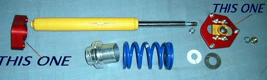

Hey guys when the car is lowered is it necessary that we install both the items i show in the picture? If yes or no please explain and name these items please... Respect!
