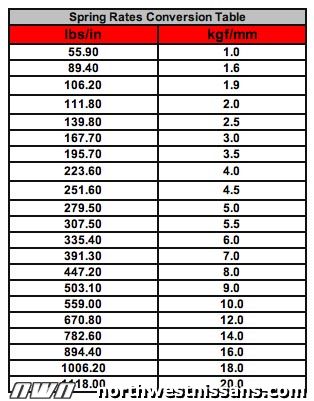

Mux213 Wrote:Note that many US based guys use the LBS notation, there is a formula for going from kg/mm to LBS in the technical FAQ.

Cj,
Handy little table Thumbs up! Thumbs up! Thumbs up!
