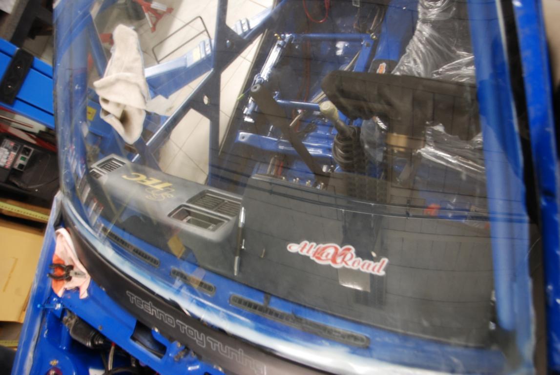

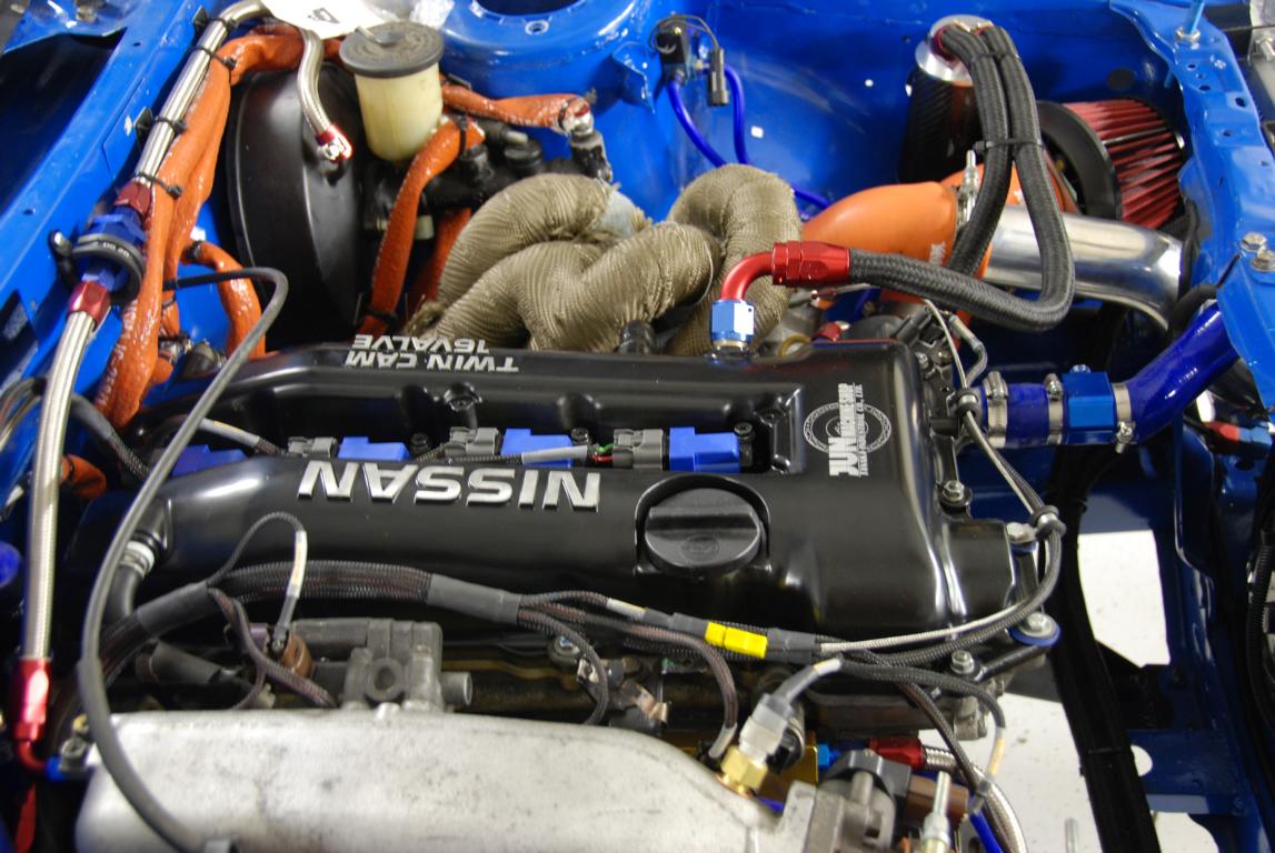

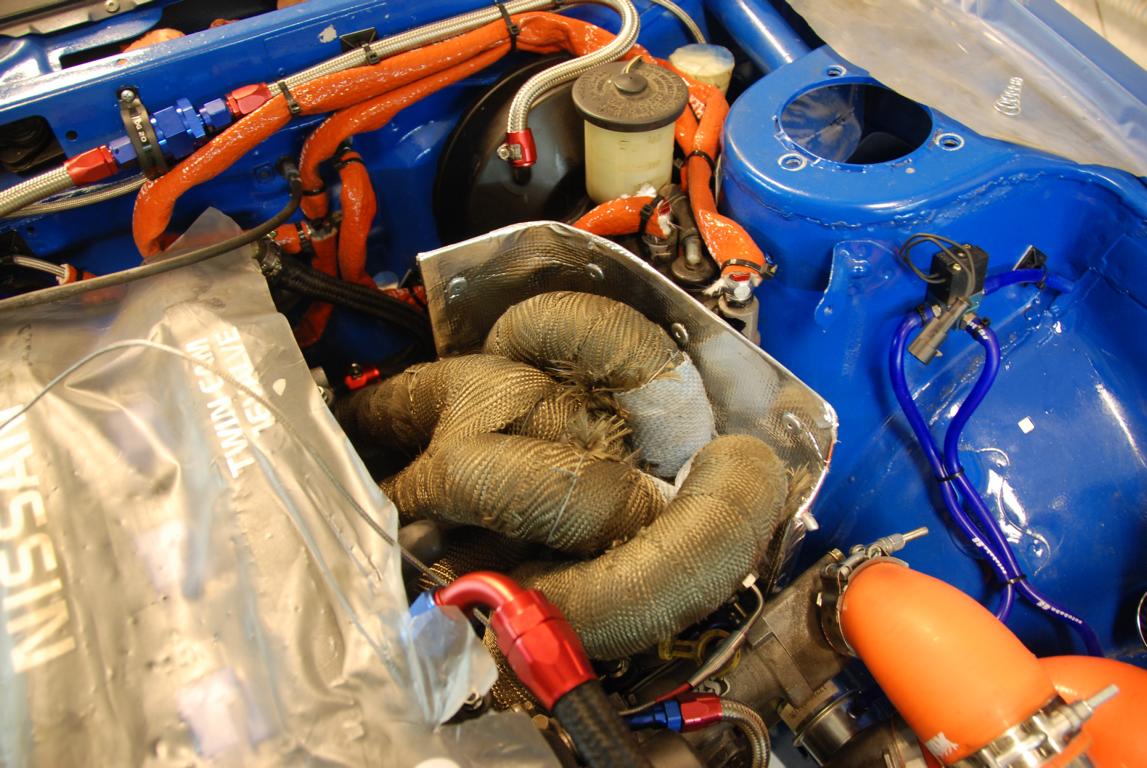

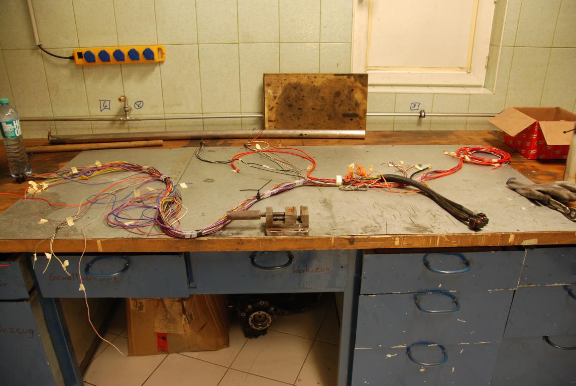

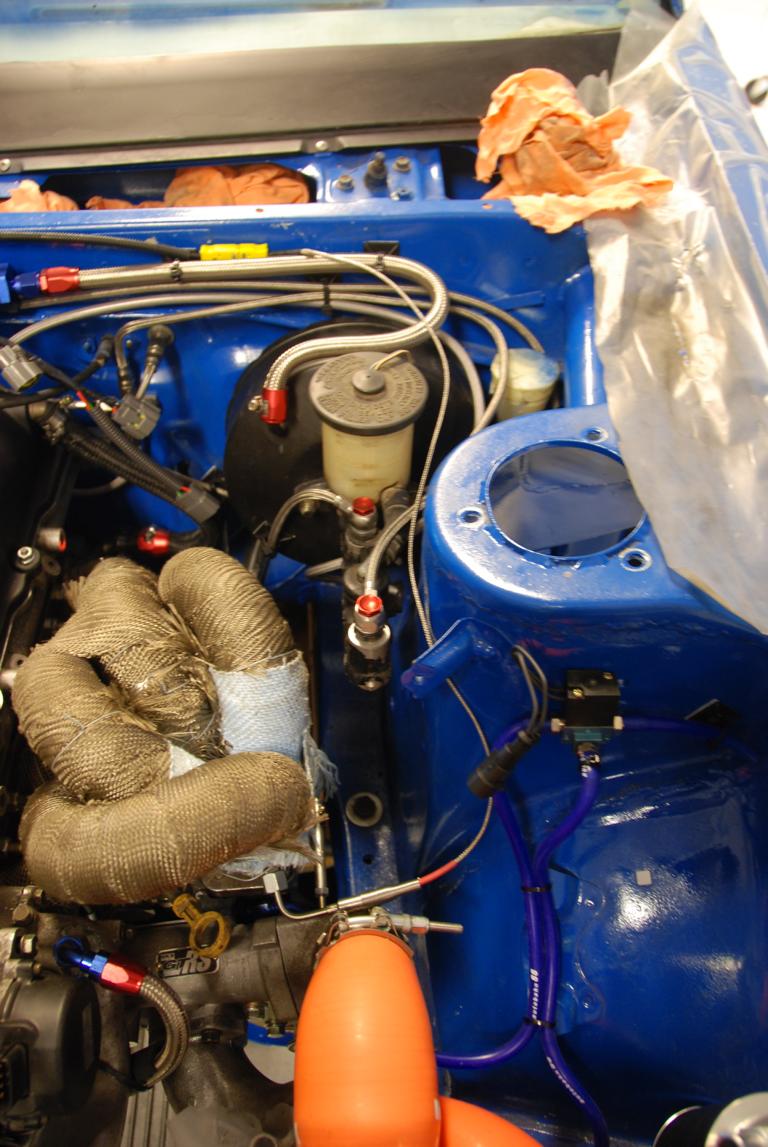

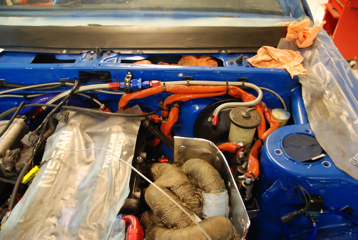

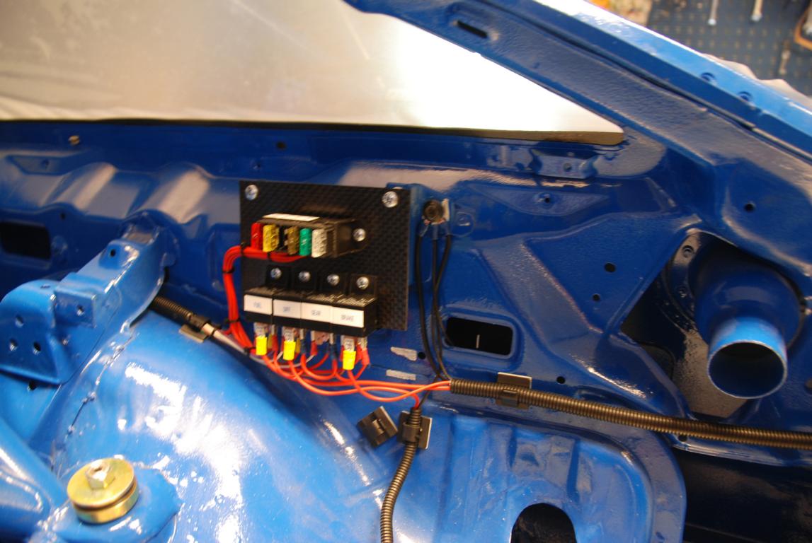

So, the car is almost finished. We are now making the wiring harness. Starting froma open loom haltech harness, we soon realized, that regarding the custom work we have to do, it is nearly the same amount of work, to make the harness all new from the beginning. Fortunately, a friend of mine has all the equipment and knowledge to do this work on high level quality. In the meantime I made some heat shielding for the brake lines and the brake master cylinder.

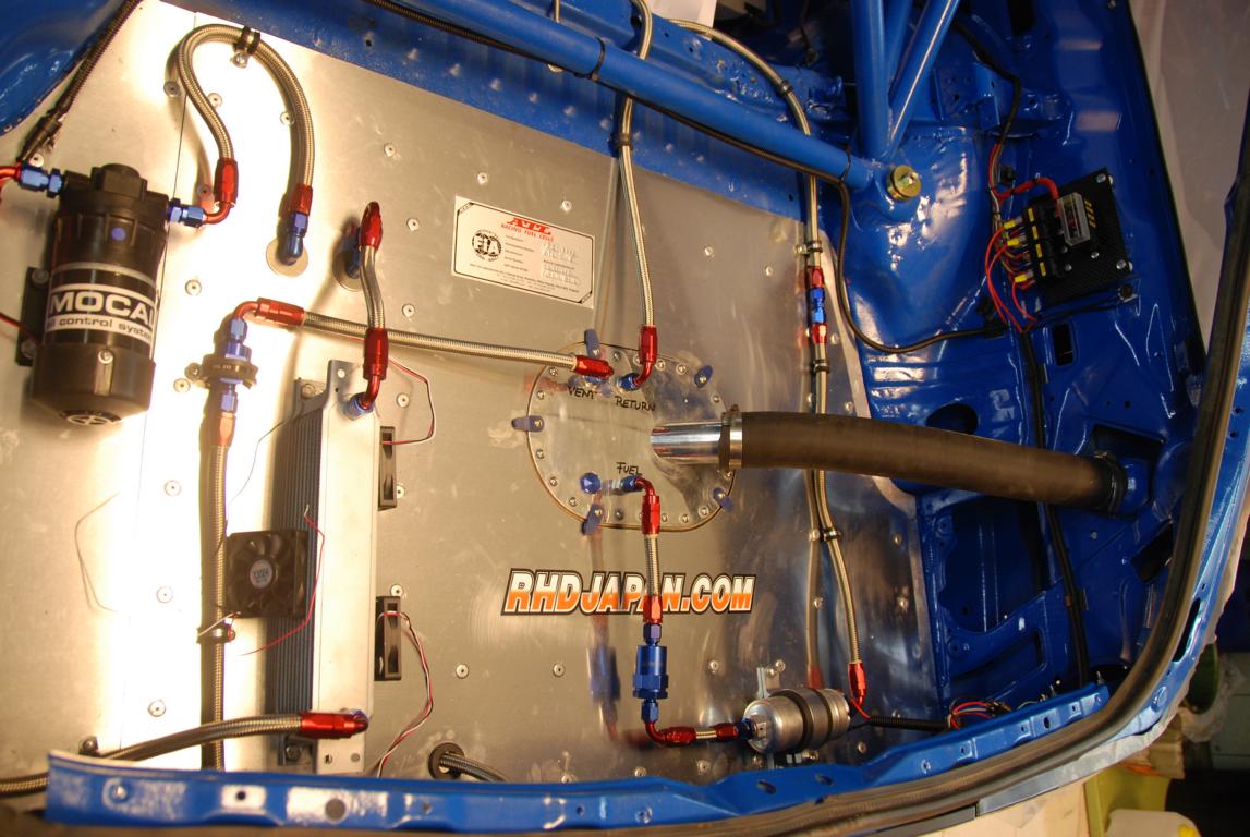

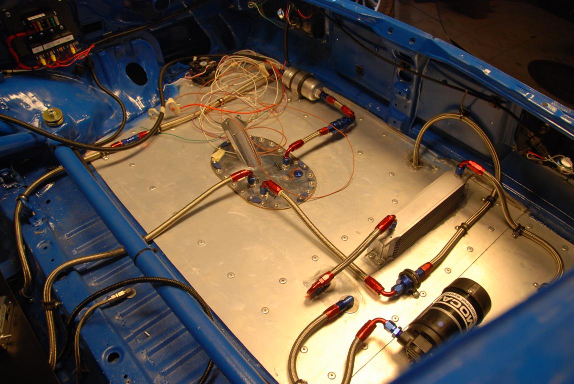

Due to some clearance issues with the exhaust, we needed to chance the fuel tank assembly. This is, how we ended up
09-16-2011, 03:55 PM
SR86 as a drift car
last 2 pics of the heat shield

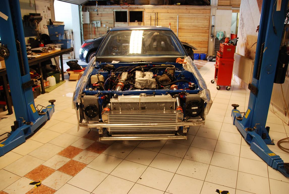

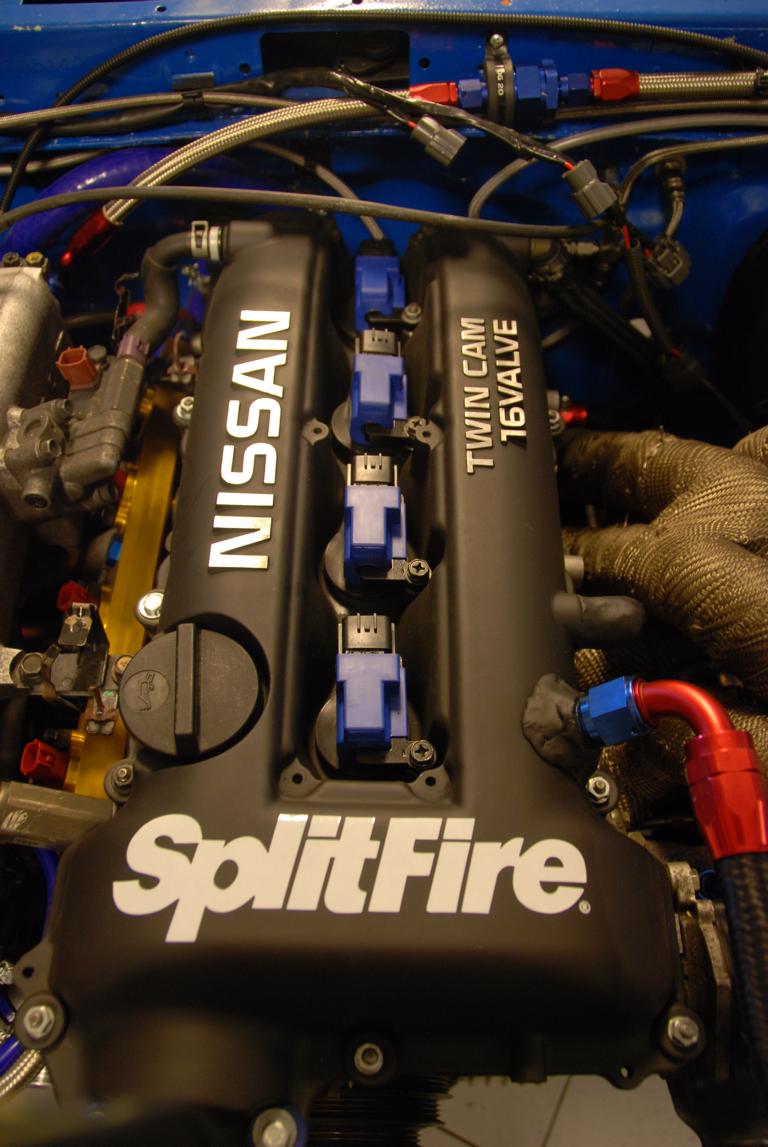

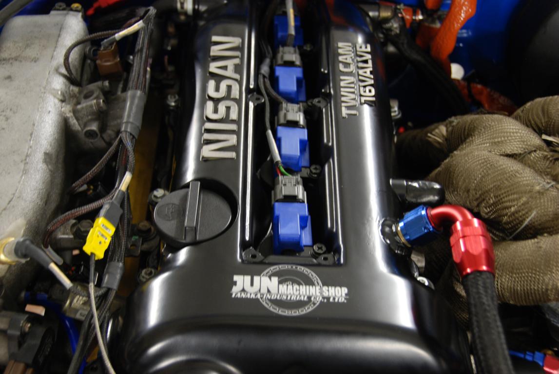

10-08-2011, 10:28 PM
SR86 as a drift car

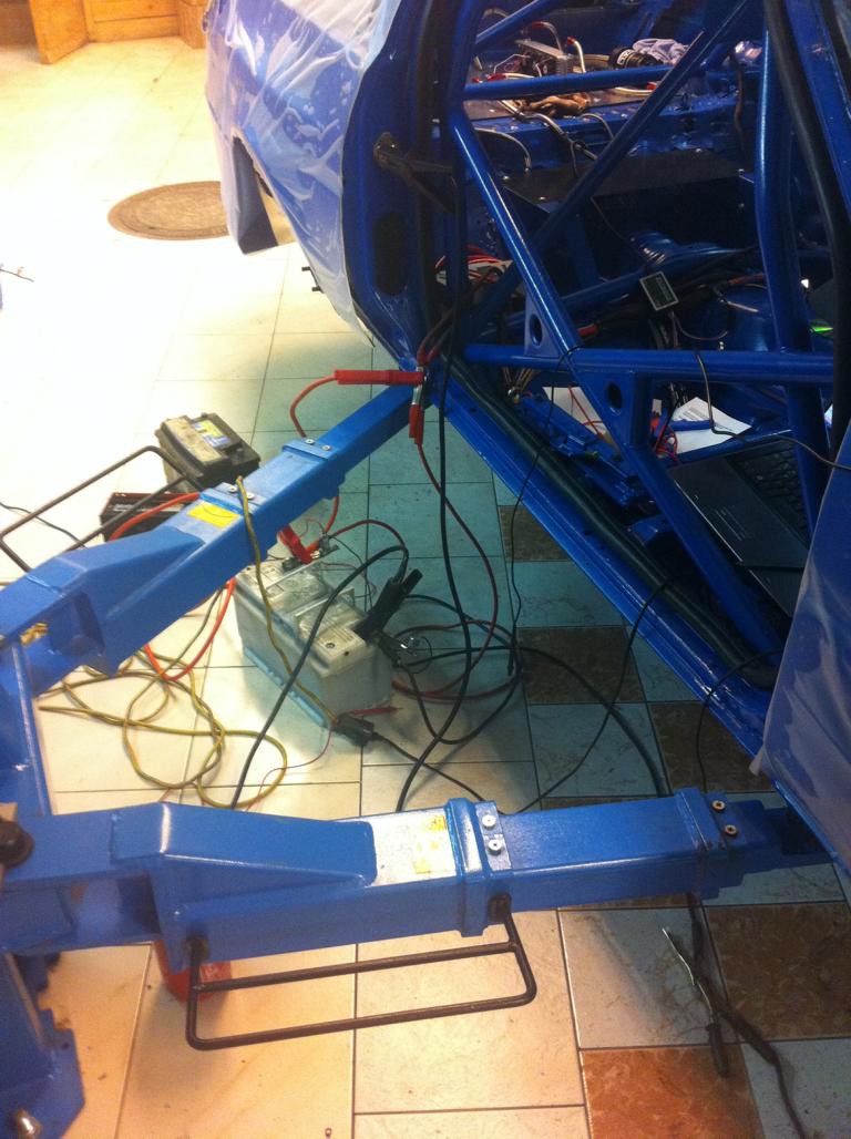

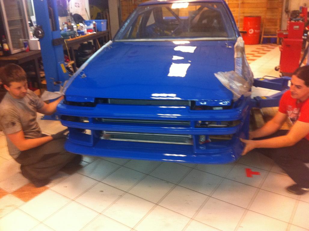

Finally the car is running, which is a nice feeling after nearly 8 month of work. There were no problems with the new build harness, the started on the first blink. Big Thanks to my friend Florian "Flo", who made the harness completely by himself and Uli, who "did" the new downpipe and Patrick, who always assisted me ( when there was enough beer in the refigerator). Now I am just wating for the new rear axle and then the "mapping" can begin.
I hope you enjoy the pics:

Can you show us what the problem was with the more rearward radiator position? Would it be possible if you ran a vented hood and inclined rad? Nissan powered AE86 are difficult to get the weight bias back to stock, but would like to try.
