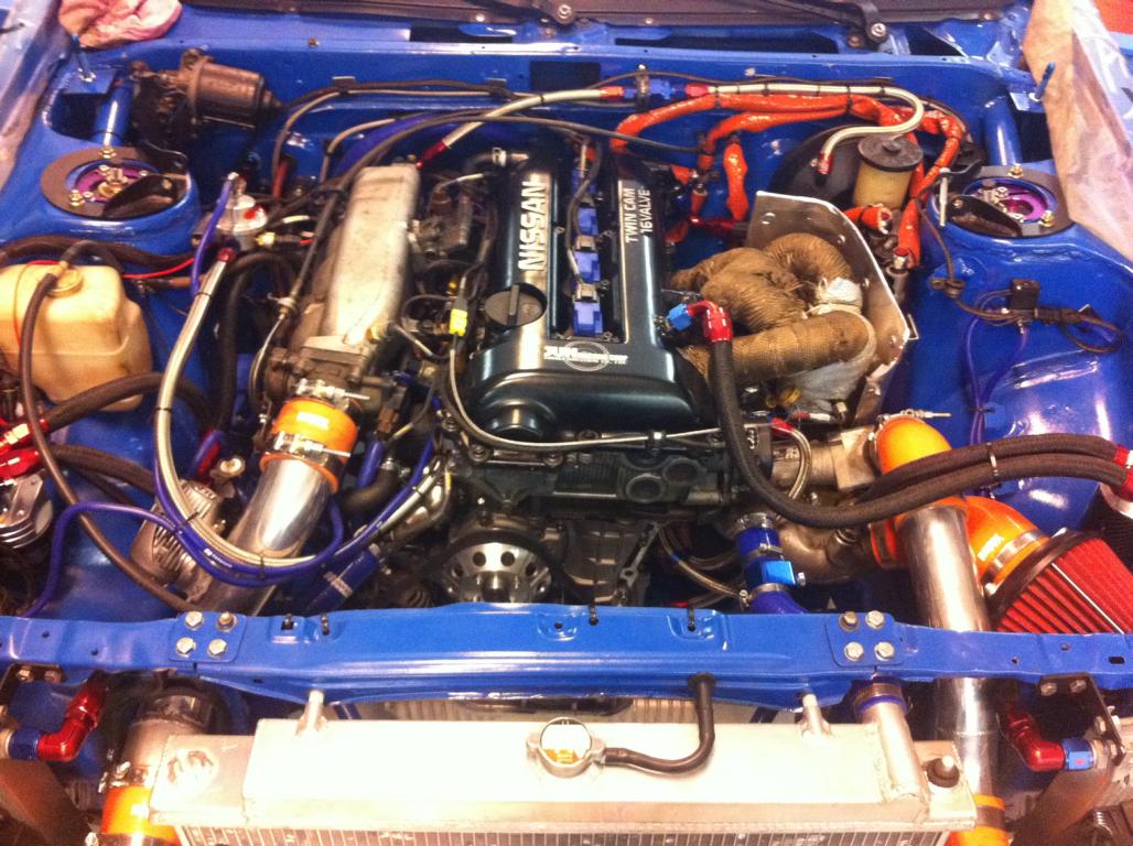

The problme with the radiaotr was, that I use a s14 radiator, which is higher than the OEM radiator. I believe, that the toyota 4age radiator is not able to dissipate the heat from the SR20. Since the S14 radiator is higher, I would have to cut out the hood, which wasn´t adequate for me. Even fot the V-mount, th radiator was to high, but you are completely right, for the weight bias it would be the better option.

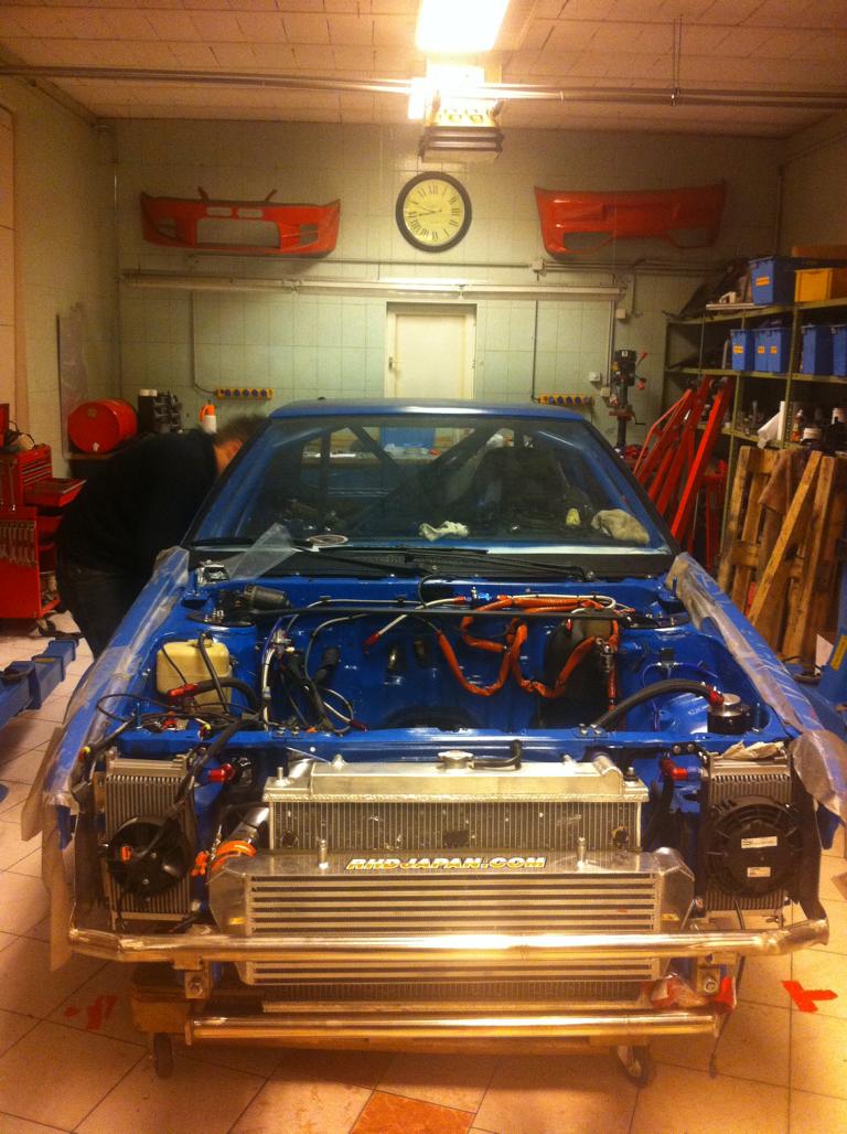

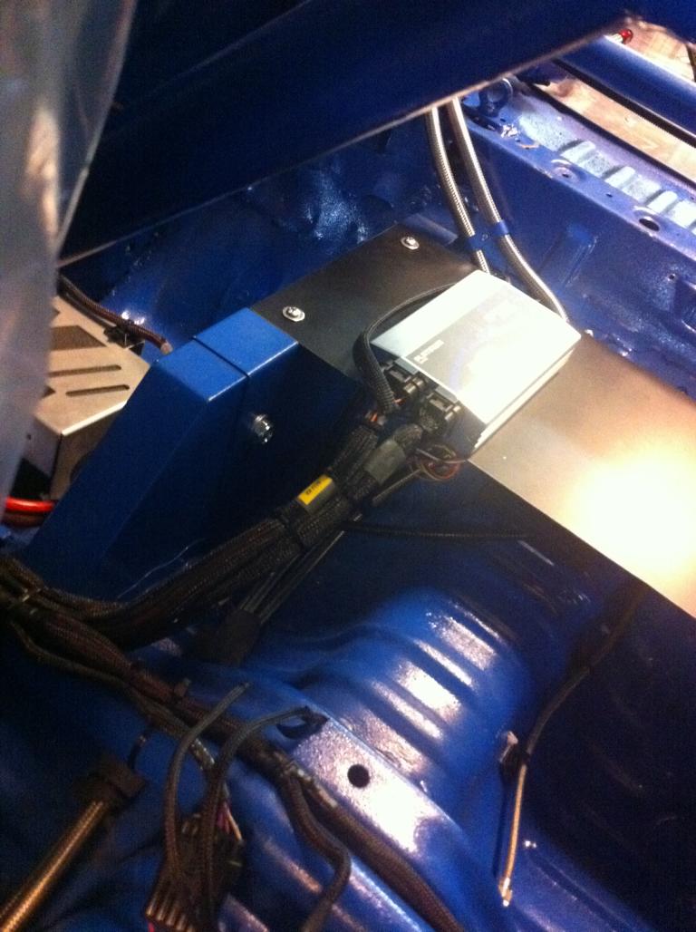

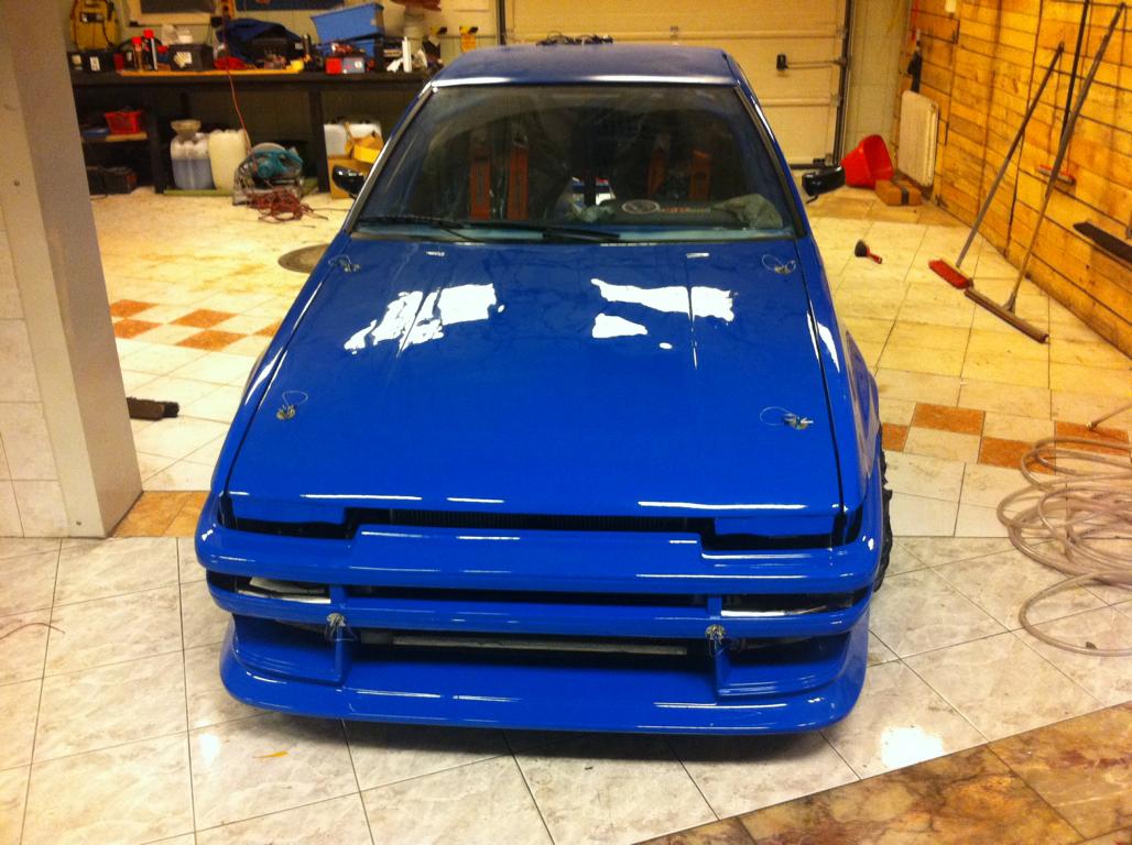

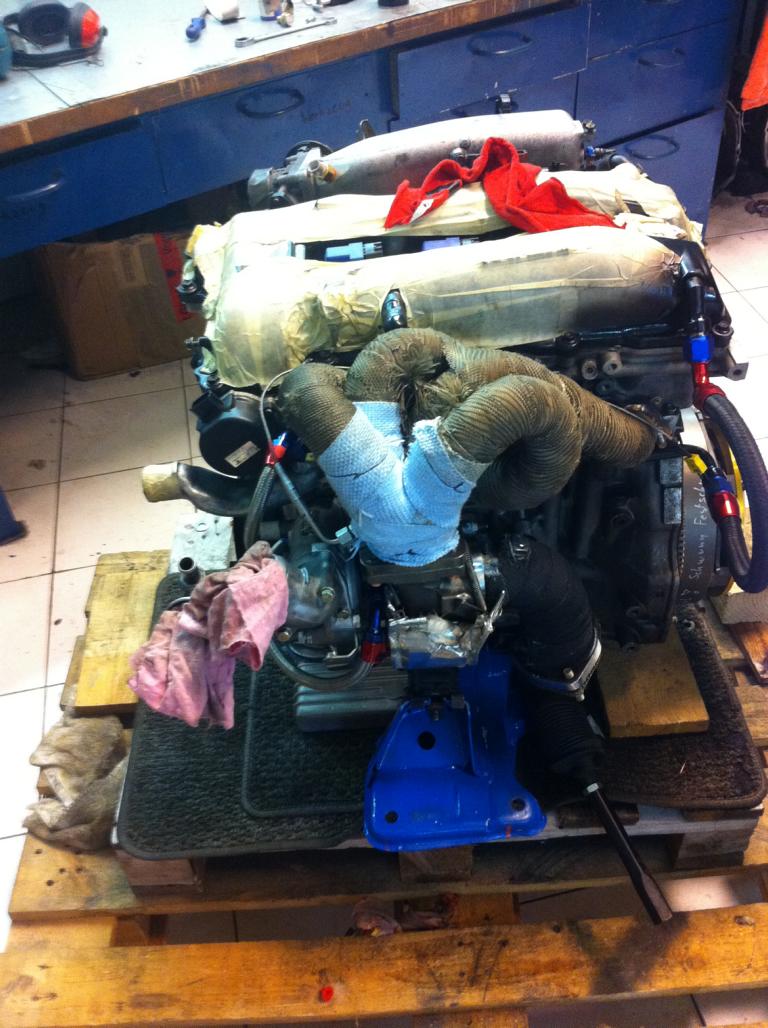

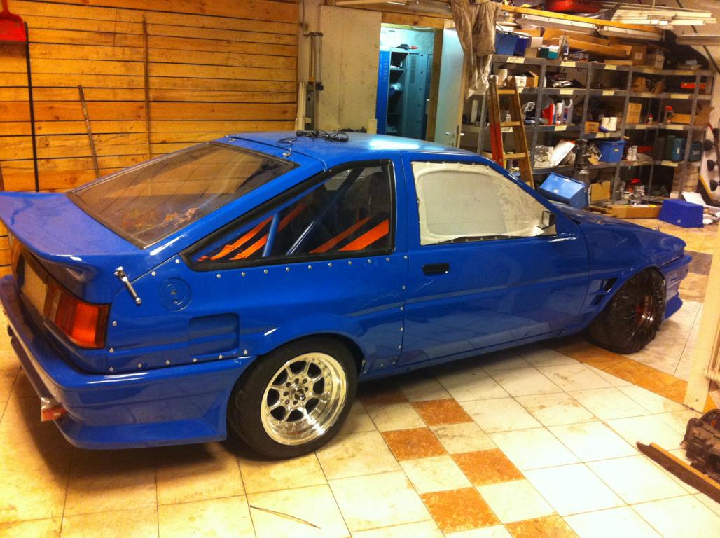

Hi again.

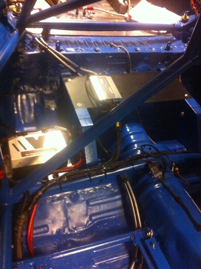

I just wanted to post a few more pics with the car on it finished. Regarding to the "upmount" position of the fuel pump, I made a swirl pot with a second pump to solve the vacuum bubble" problem you enccounter with these pumps when not mounting them beneath the tank.
i amstill running the car in and in the end of march it will be finnaly mapped. But I can already say that I will nedd a longer final drive ( 3.9 or so)
Someone of you maybe know the blue Aardvark from television. The color always reminds meof it, so i decided to to give it some cheers.
Hope you like it,
Clemens

Your ae86 definetely has a character Smile Superb work! Thumbs up!
02-09-2012, 04:11 PM
Post: #35
SR86 as a drift car
Really coming together now. Nice!

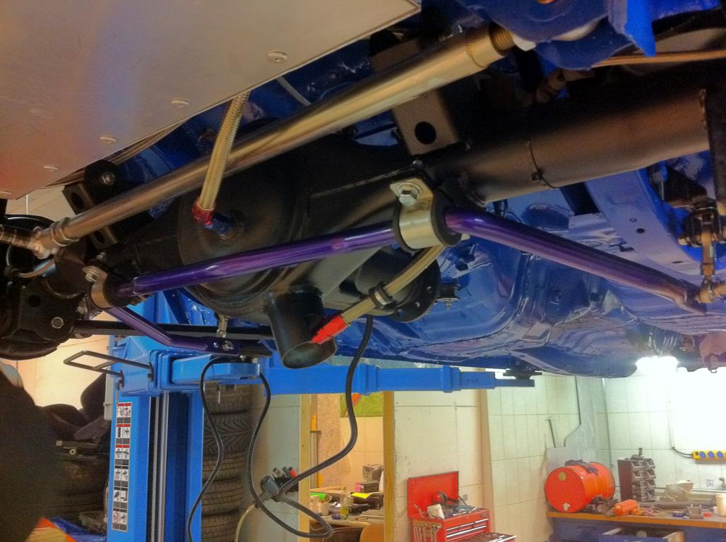

Do you have any more pics of the rear axle cooler setup?
02-09-2012, 10:55 PM
Post: #36
SR86 as a drift car
Sure I can post some pics of it: there were 2 versions of it. The first one used the original drain plug as a the drain for the pump. I just used a M18x1,5 to dash6 fitting. But when I lowered the car I realized that I would always scratch at the protection ring I welded on the rear axle, so I drilled a hole about 4cm below the filling plug on the engine side of the rear axle, cut a 1/8npt threat and drilled the fitting to allow for more flow.
The cooling lines then run via bulkhead fittings into the trunk of the car. 3 small vents are attached to the radiator.
