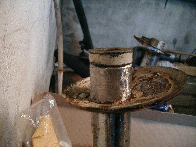

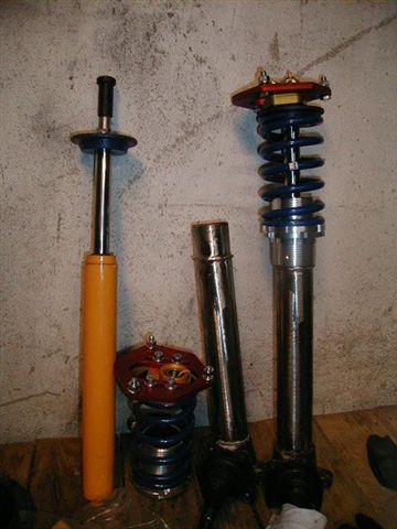

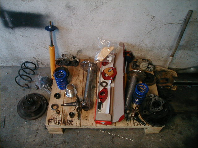

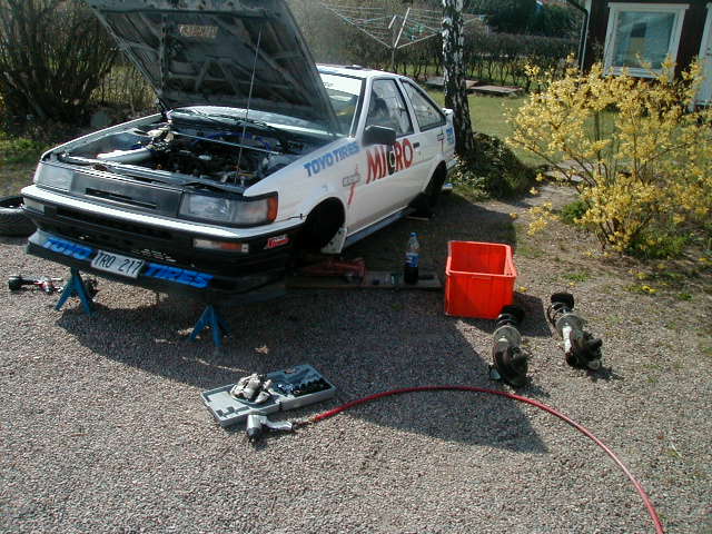

I have been saving up a big load of parts over the vinter, & now i finally have started to adapt the car for the summers drifting days.
I decided to measure a bit more than i needed - & came to the conclusion that I could cut the strut´s the 40mm above the spring-plate.
& there for i could still use the stock (cut) springs if i wanted to for the yearly MOT.
I also found out that the Coilovers will fit the struts - which i first had measured that they would NOT fit.
i also sanded down the struts & took the entire strut/brake assembly apart in oredr to paint them...
Regards/
.............kristian

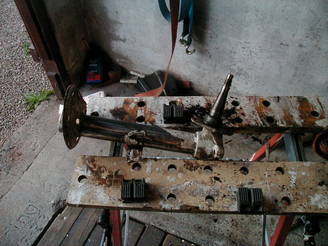

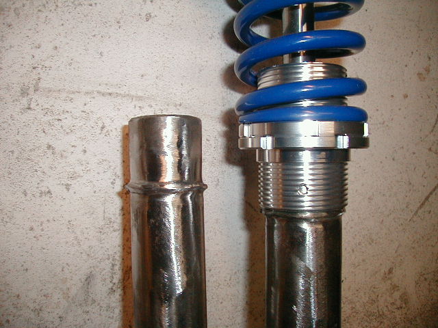

more pics about what has happened...
04-28-2005, 09:26 AM
Kris´s TOYO/KONI drift car
Kristian, why most aftermarket springs are shorter than stock ?
I can understand why they are stiffer, but why not use long springs even in shorter strut housing - if remove the lower perch and use longer coilover sleeve ? Maybe I miss something important here.
04-28-2005, 10:26 AM
jamiemirror Wrote:Kristian, why most aftermarket springs are shorter than stock ?
I´m using shortstroke shocks now - thats why !
K

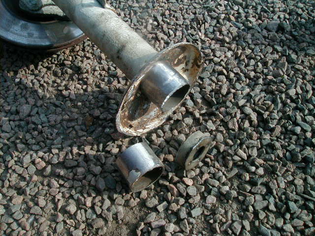

decided to cut of the spring-plate today.
& adapted the coils to fit the strut exactly.
I also bought some miniature bolts to lock the coils in place.
the coils now rest on the weld that held the spring-plate in place -
which sould be more than enough for the springpreassure.

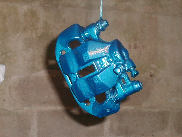

I also sanded down & painted the front calipers.
04-29-2005, 01:15 AM
looks nice....
kris why did you paint the rubber on the calipers????
04-29-2005, 11:36 AM
robokill Wrote:looks nice....
Cause i had no tape to cover them with
K
