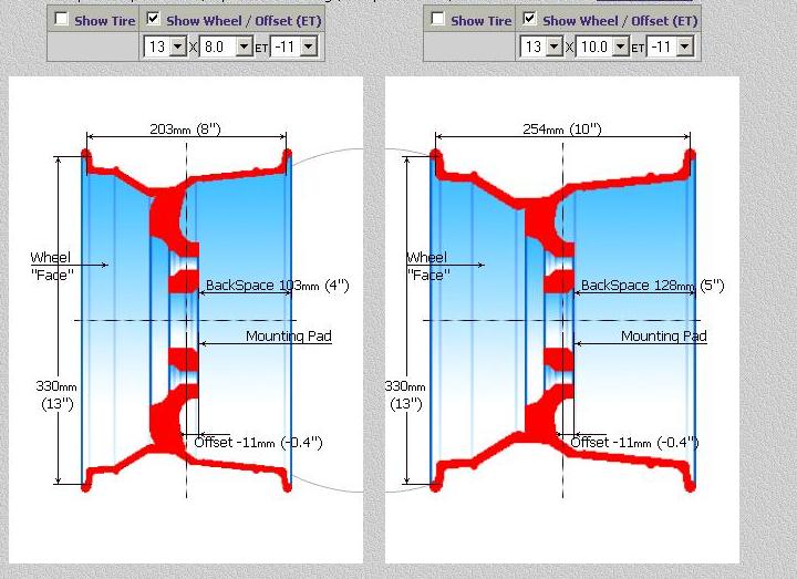

does anyone hear about
aerorace wheels ?? they have cheap racing wheels with extremelly sizes. like 13x8 or 13x10 wit 4 on 4-1/2 bolt pattern (=4*114.3) smthg like this owau no ka "I" |

everything is ok with nuts, only two features:
- central bore is 72mm - wide tyre valves 16mm owau no ka "I" |
