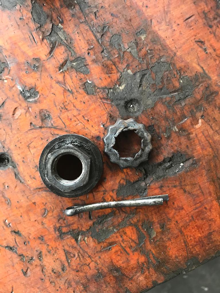

Hello everyone,
A bolt, a nut and a pin on the front axle have recently worn out, to which I can't drive unless it has been fixed. I found out during repairs I need new ones, but specifically made for the front axle of the ae86. I have pictures added below of them below. Can anyone help find out where I can get them? That would be great!

Flos has them:
https://flos.ie/shop/spindle-nut-front/

[Image: AEU86 AE86 - Need special parts]
Washer: 90214-16010
Nut: 94125-41600 (replace: 90170-16137)
Cap (locking washer): 43525-20011
Pin: 95381-04025
I would also recommend buying new caps: 43514-20010

(09-04-2021 04:17 PM)DarkSupra Wrote: [ -> ]Flos has them:
And delivery from flos is fast, to my experience, you'll have it in a few days

Hello,
Thanks everyone for your help. Thanks to your help, I was able to buy the special parts I need for my ae86!
