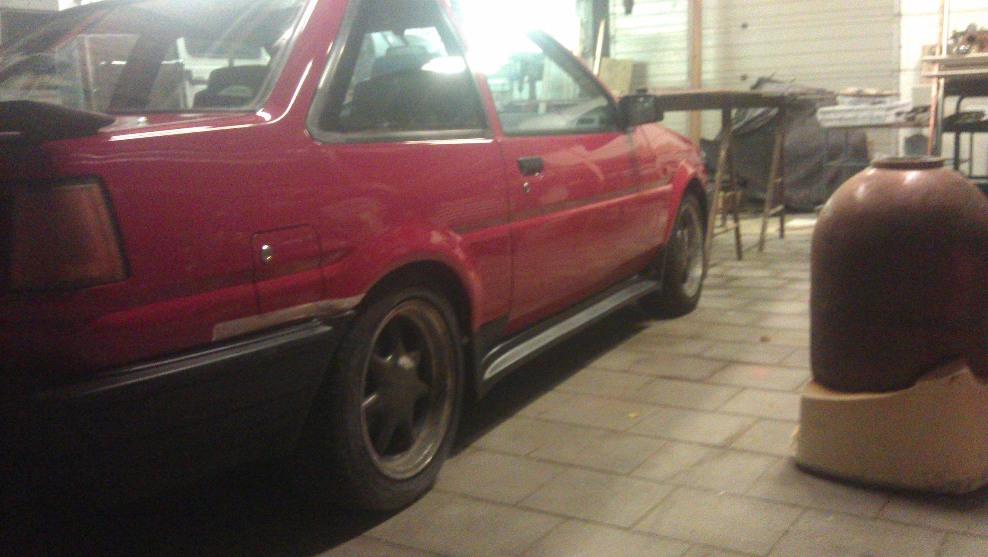

Small update:
-Front fenders now painted in the right colour -Skirts painted and mounted -Rear wheel arches fixed and painted ( to the car shop dude, body shop work really is an art!)Next step: -Get those BBS E50's shining again, include 10mm spacers for the front and lower the car some more (spring hits the tire now) -MOT in January Keep you posted! Real men race downhill |
12-25-2014, 10:42 PM
Post: #34
My GT coupe
Nice going and the BBS rims would make the car a great looker!

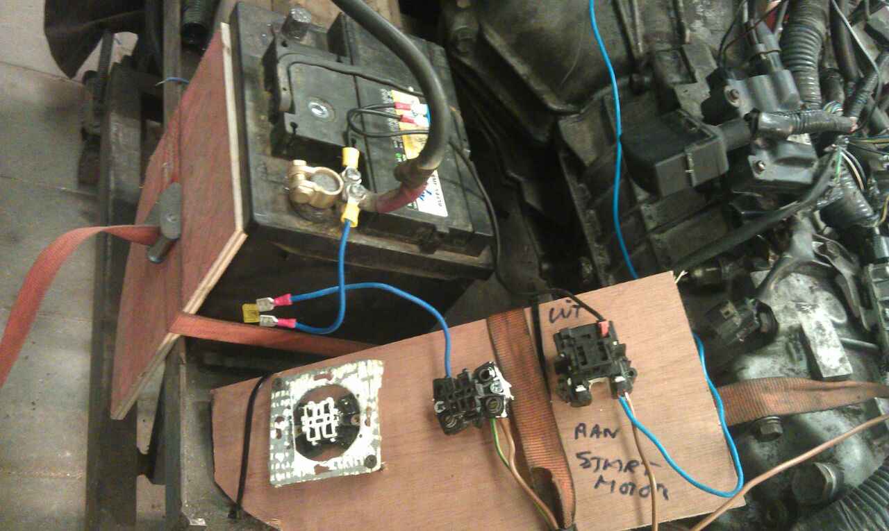

Hooked up the 20v on a stand and replaced the timing belt, hooked up the electrics and fuel to see if the engine still started and everything seems to still function just fine.Made a simple switchboard and fuel tank.
Next step will be hooking up the cooling and make the it suitable for RWD use.Now looking for an RWD pump housing. Meanwhile i will be studying/ making an approche plan for the KDFI/Megasquirt (trigger wheel? COP? Wasted spark? Camshaft sensor? which sensors can be used?) Real men race downhill |
