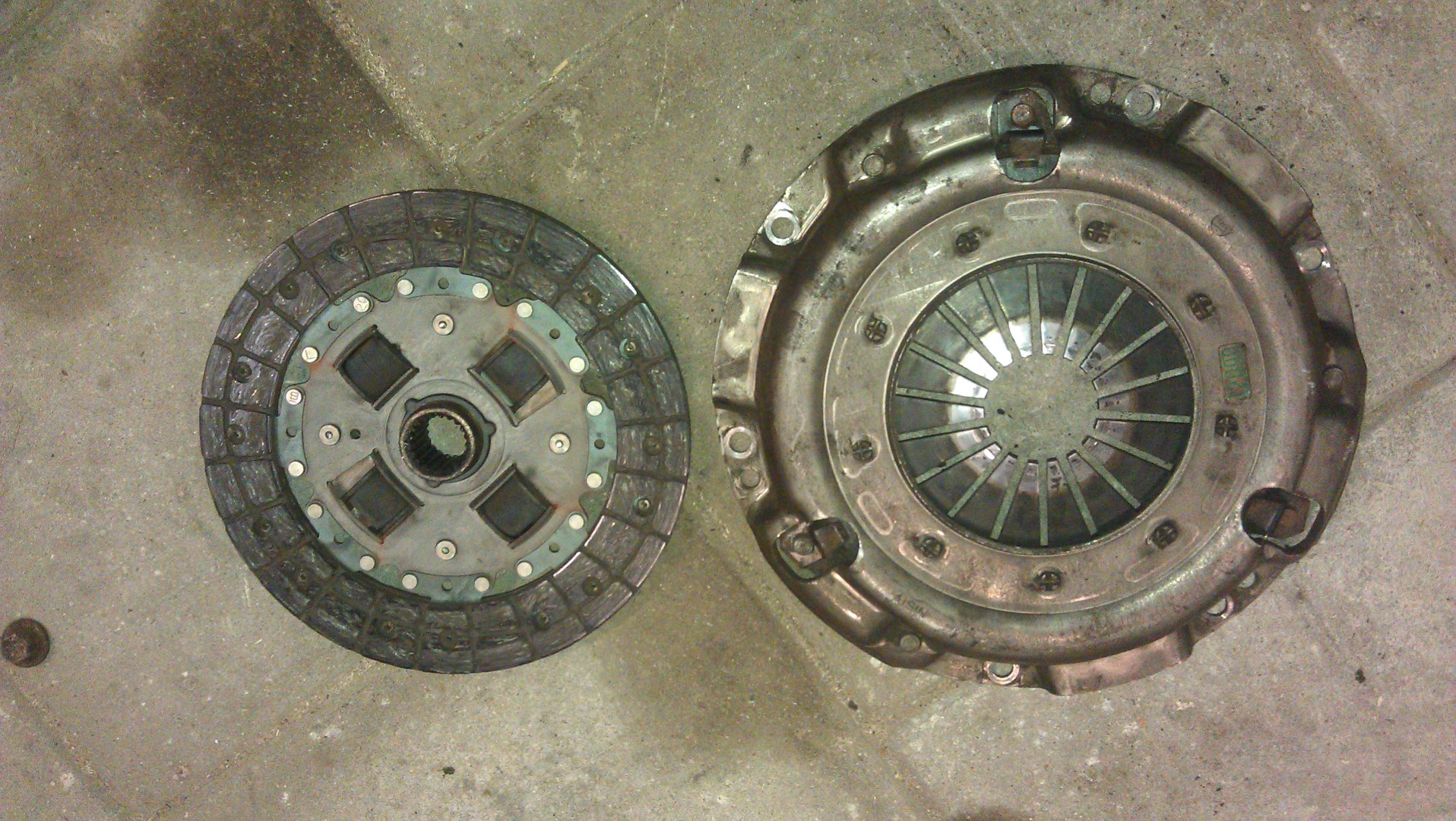

repaired the clutch today, the old one doesn't look very worn out, but the springs in de diaphragm aren't parralel anymore, the bearing was worn out.within the first few cm pressed on the clutch pedal you could release the clutch so i assumed the plate was worn out.the pedal feel is now much better.
changing the clutch is a breeze.

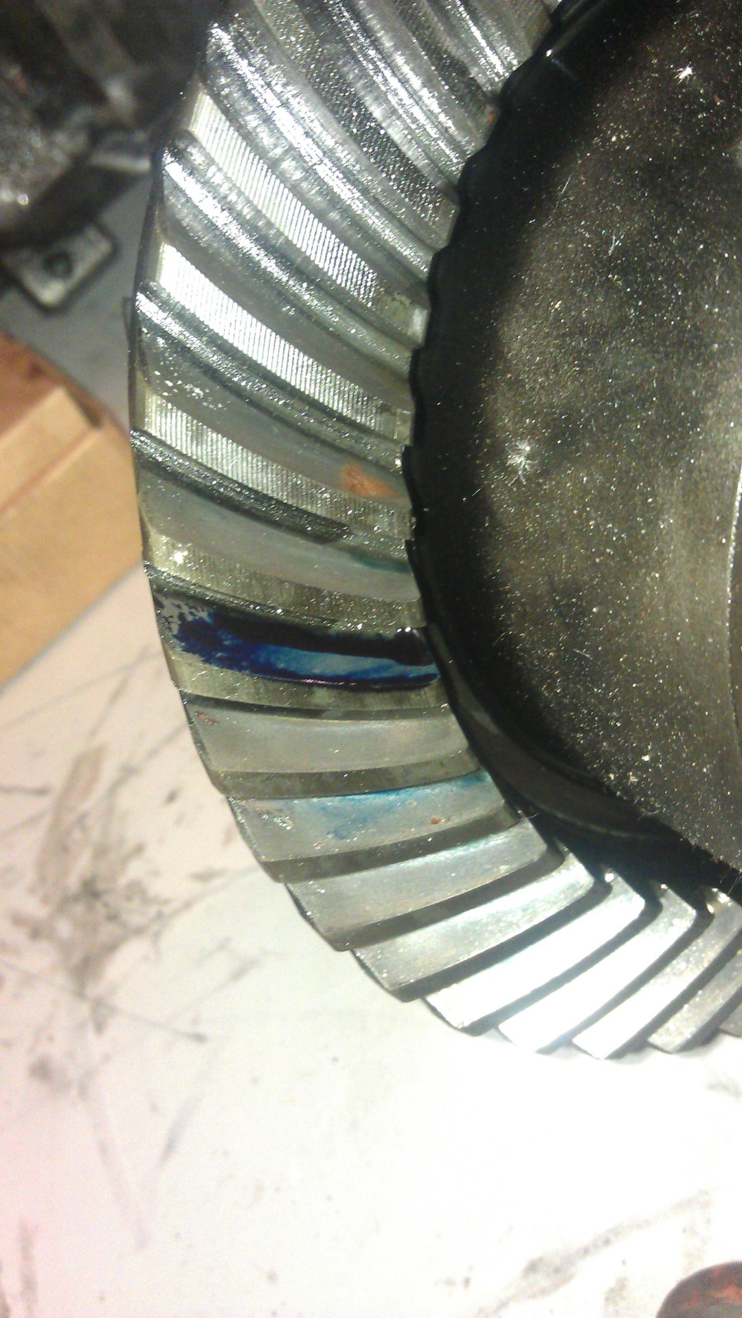

started on the spare rear axle. the wheel bearings were shot so bought 2 sets and replaced them.Measeaured the diff according to the repair manual, backlash and teeth still looked very good after 200.000 km.put some blue lead on the teeth to see the contact pattern beforehand.
disassembled the LSD and put in the T3 shim kit, wonder how that will turn out.replaced all the bearings and assembled the diff according to the workshop manual (small investment in tools needed)made a contact pattern again, since the ring and pinion are the same (they looked good) i kept the pinion depth shim the same to start with.
this is how it looks now, i might need some readjustment but have to check the internet for some more examples of how it should look.what do you guys think?

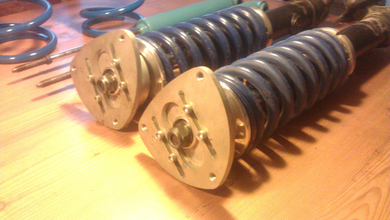

The front coilovers were still at someone that whas going to make camber plates for them, dropped them off 6 years ago but he still had them lying around unfinished haha.But now they are complete, i only need the small rollerbearings that are on top whhich should arive this week.
Also ordered new front wheel bearings, T3 shock tower plates and front fender braces to stiffen the front up a little to match the stiffer spring/shock combo.

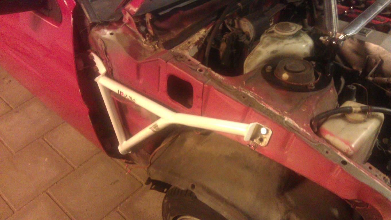

front fender braces are now mounted, ordered them from ultra racing.Fitted fairly easily, had to bend away some small parts of the chassis to make it fit.Mounting the bolts is a bit tricky since my hand couldn't fit inside the fender, but i pulled it off by clamping the nut on a welding wire and fiddle a bit.

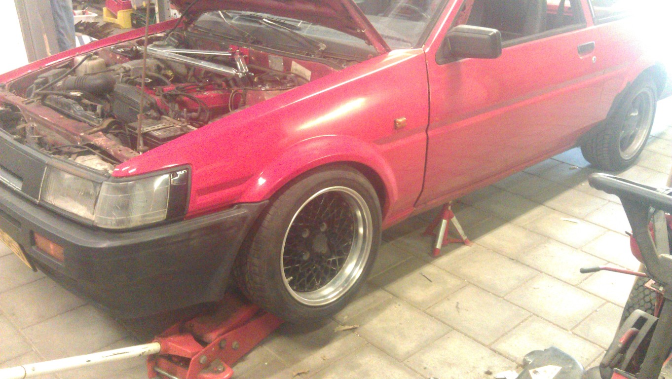

Front struts are mounted in combination with the camber plates.The wheels that i have now are not a good fit, the tire rubs against the strut just a little bit.I also can't lower the car too much because the spring seat ring will touch the top of the tire.
These struts probably need a really different offset wheel.The khamsin one are +18 and fitted nice with the standard struts.I tried the BBS rims which are +5 offset, it looks a lot better but still not ok.
I checked online and people who use these struts run on et -20 Huh
So right now i shimmed out the wheel with rings just to check how much it should be spaced out to fit and a 20mm wheel adapter should do the trick.but since there is now not enough thread left to screw the bolts on i jacked up the suspension to check.I need to remove the plastic inner fender but looks like this is the way to go.
