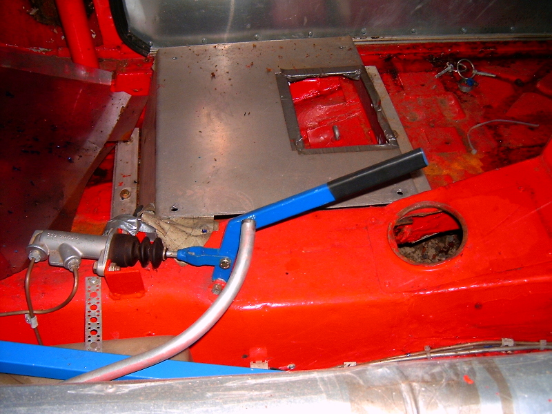

Added pics as attachments. Wink
[Image: AEU86 AE86 - Hydraulic handbrake]
10-16-2006, 10:46 AM
Hydraulic handbrake
Also I see some kind of one-way dual valve in rear brake hydraulic circuit (maybe this way interference between hand and pedal braking is avoided).
What if you just add another set of rear calipers + independent hydraulic circuit for hand brake ?
10-16-2006, 12:41 PM
Hydraulic handbrake
Keep the existing cable set up & just buy a kit from any rally shop, which includes the cylinder, this is better for mots as you need a physical cable attachment
10-16-2006, 01:52 PM
Hydraulic handbrake
jamiemirror Wrote:Also I see some kind of one-way dual valve in rear brake hydraulic circuit (maybe this way interference between hand and pedal braking is avoided).
I'we heard on DIY hidraulic handbrake it likes to overflow the master cilinder when you pull the handbrake.
