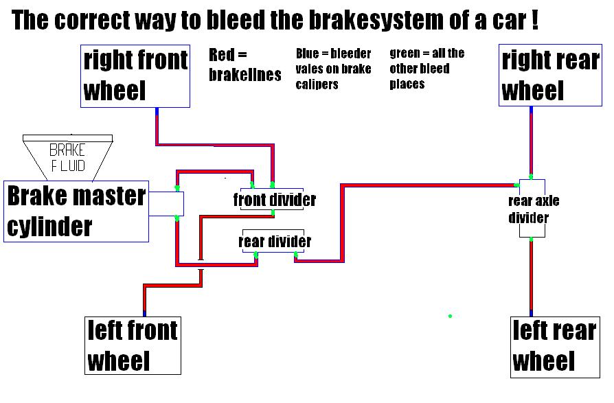

I replaced my old rebuilt master brake cilinder with one of my new ones, but dont know what the best way of bleeding the system is after the new brake cilinder is installed. I bench-bled the master brake cilinder with some of the tubing and nipples that came with it, but how do I best get rid of the air in the brakelines around the master cilinder? In the past I've tried bleeding at the top of the brake proportioning block (under the master cilinder) and at the brakeline fittings on top of the master cilinder.
I couldnt get it quite right back then. I'm afraid that If I only try to bleed at all 4 four wheels that I wont get the air out, and will loose another pint of brake fluid in the process.
In short: how do I bleed my brake system after replacing the master cilinder?

When i changed the master brake cylinder on my Bimmer i just bleeded all the brakes like usuall.
Be carefull not to press the brake pedal all the way tho, might kill the cylinder due to the air that's in there. And yes, have lots and lots of spare brake fluid, you'll need it to bleed them all.

mmmkay...Just started bleeding all four calipers, starting on the rear axle, working my way forward. The pedal is a lot harder now, but with the booster assisting the pedal when the engine is running I notice that it still makes the first centimeter of the pedal stroke soft. When driving I get better response from the brakes, but it's weird that when I press it fast, the first bit stays mushy, and when I press it slow they feel a lot firmer.
Maybe there is still some hard to get to bit of air somewhere or I need to install my new discs and pads (current ones are worn down by 50-60%), but I'm not completely satisfied until my brakepedal feels hard on the first bit of the pedal stroke with the engine running.
This is about as good (or better) as I have ever felt the brakes on my car so I'm not dissapointed, but I have felt the brakes in robokills car, and know how they should feel in good order.
