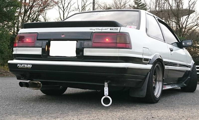

The twin pipes of the W-tail look great on a kouki panda:
[Image: AEU86 AE86 - Exhaust replacement]

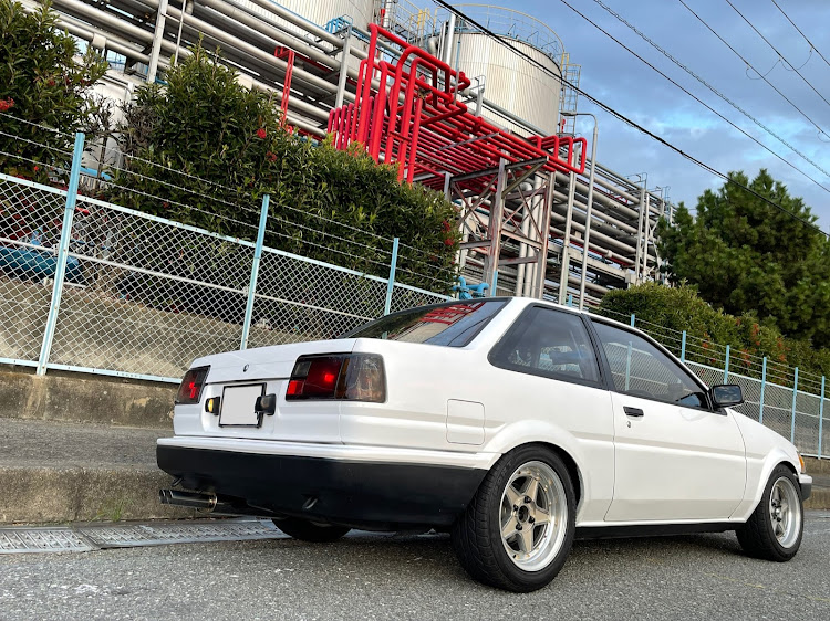

But I don't really like the looks on this zenki non-panda:

06-24-2024, 01:15 PM
Exhaust replacement
really like the twin pipe in the oval damper.

On this zenki Trueno the twin pipe looks great, so I think I'll go for that one as well! Hurray!
