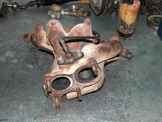

The exhaust manifold has been drilled and fitted with a lambda sensor (needed by AE92 ECU).

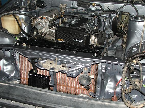

So now, all is in place, except some panels in the car and minor things to be strapped down in the engine bay. I should be getting it back today or tomorrow. Hurray! Will post first pics on the road when I have them.
