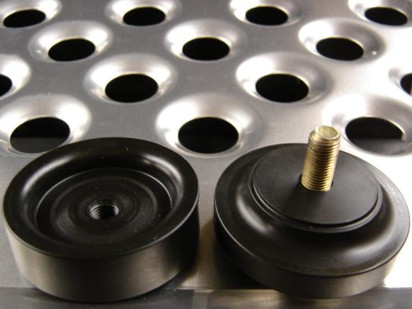

I don't have a photo of the tool I used but it's pretty much the same as this;
[img name=]http://www.aeu86.org/files/fl/flaretool_154.jpg[/img] Basically you just use a hole saw to cut a round hole to the sheet, place the tool on both sides and tighten the bolt down as hard as you can.
