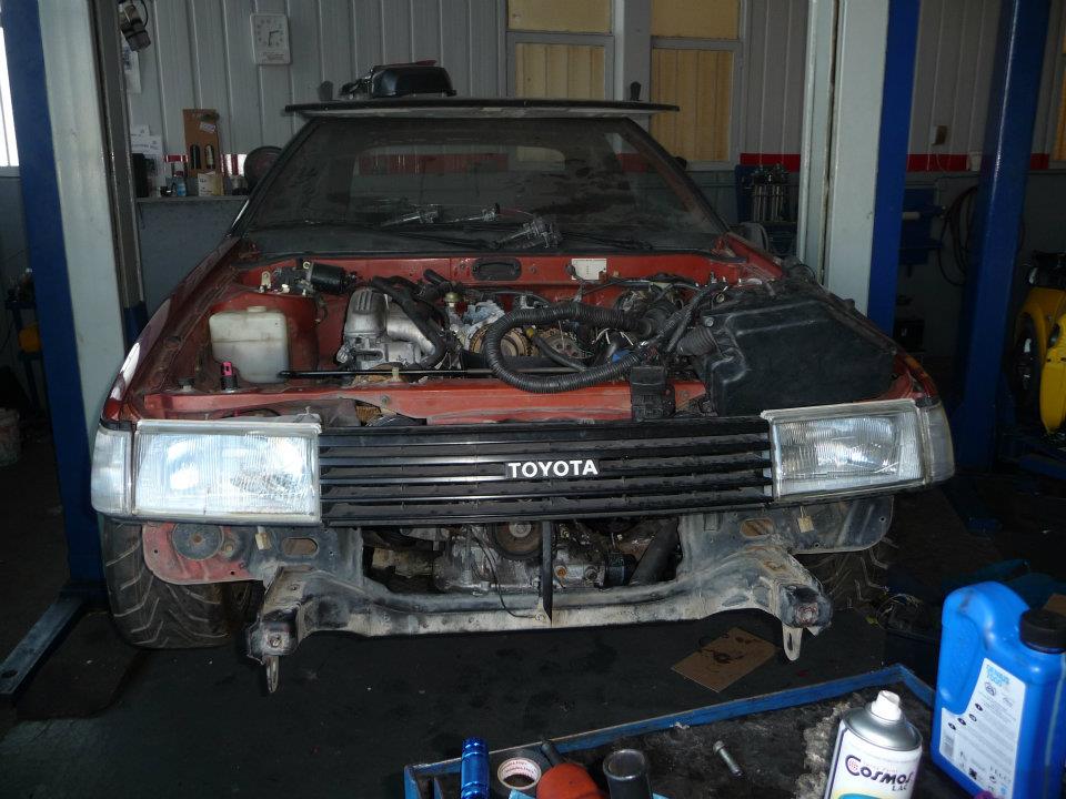

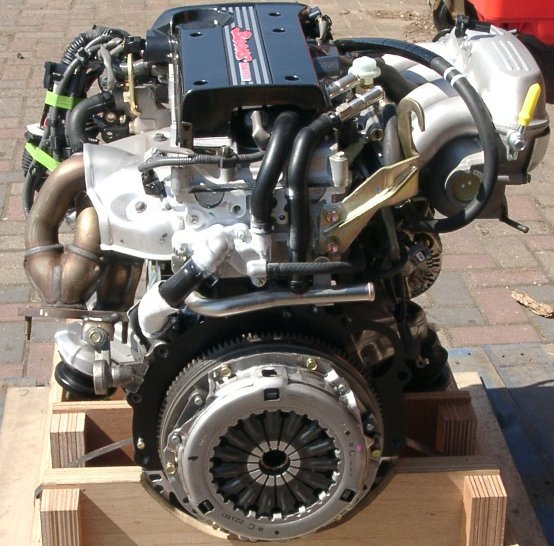

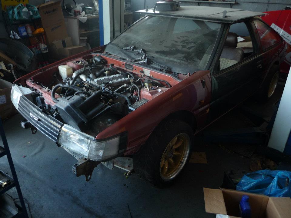

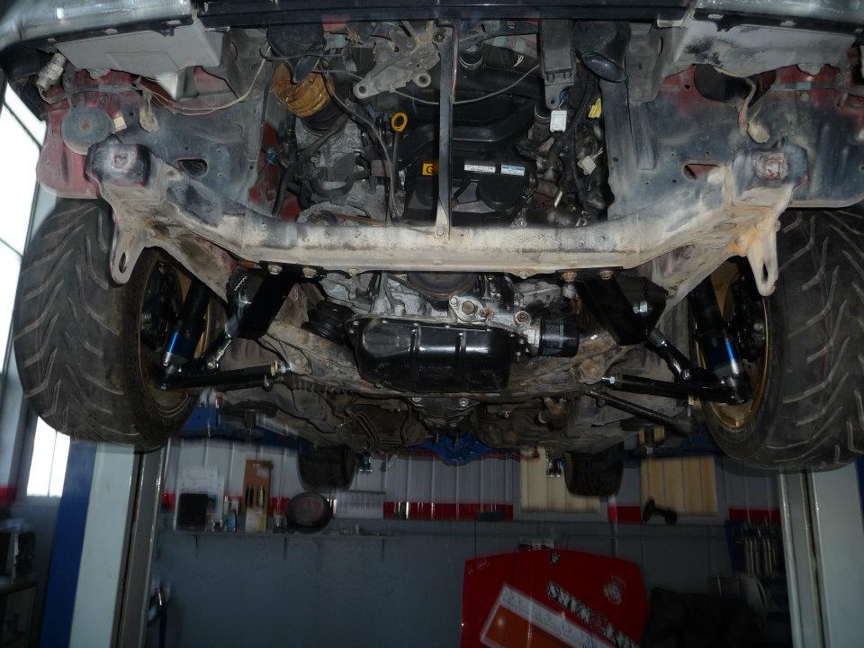

start install parts and engine first

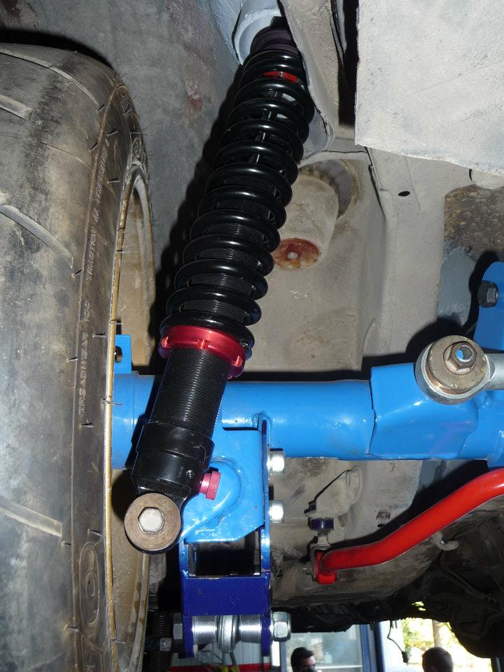

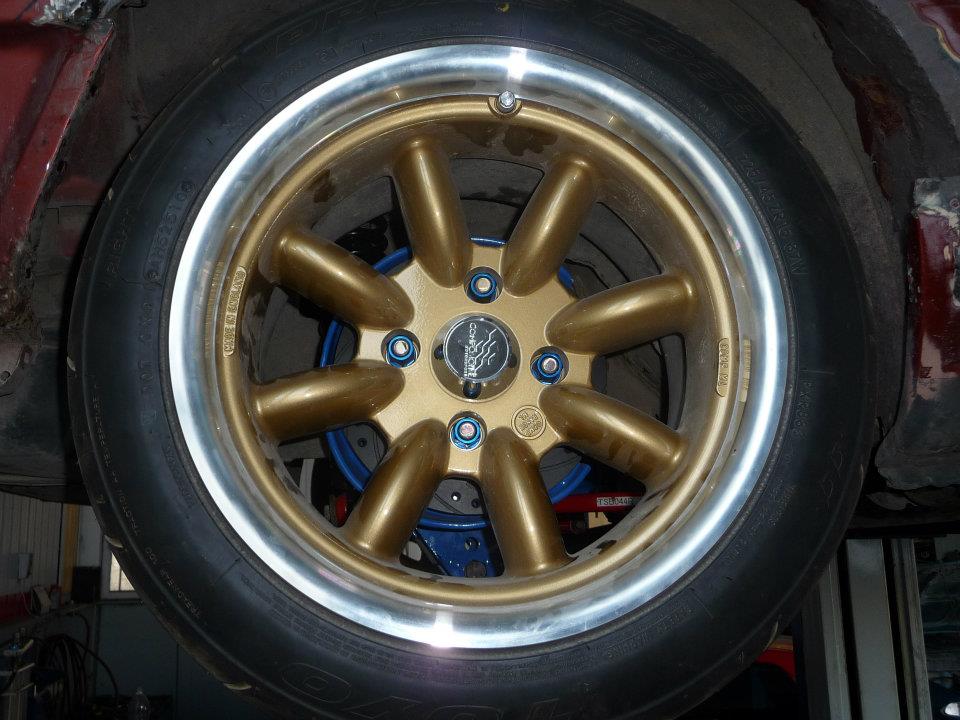

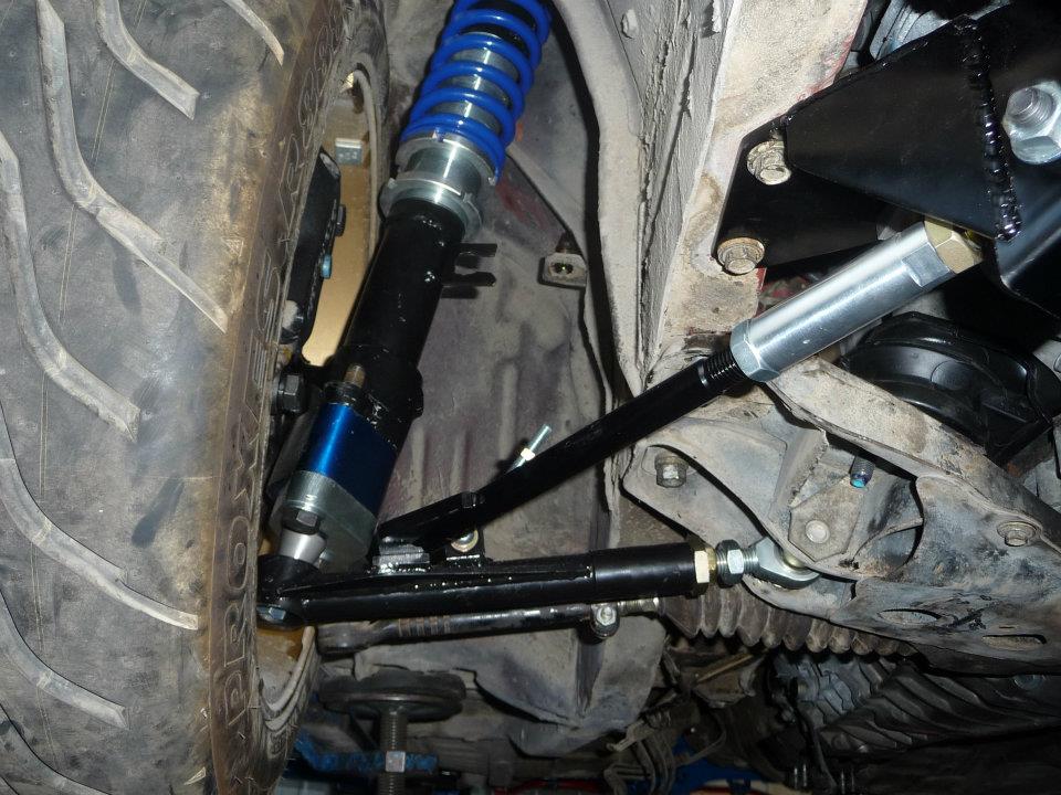

seibon carbon doors ,mcnsport suspension ,compomotive wheels 15x8 front 0 offset and 15x9 rear with -13 offset ,wilwood brakes .

i will send more when start reinforce the body and do the paint job.
color of the car will be custom carbon paint .

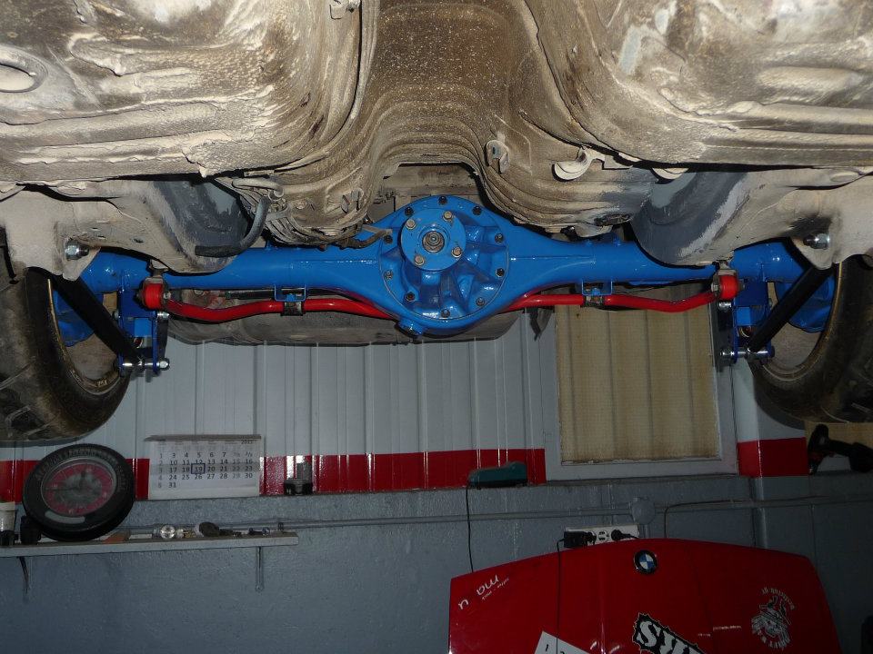

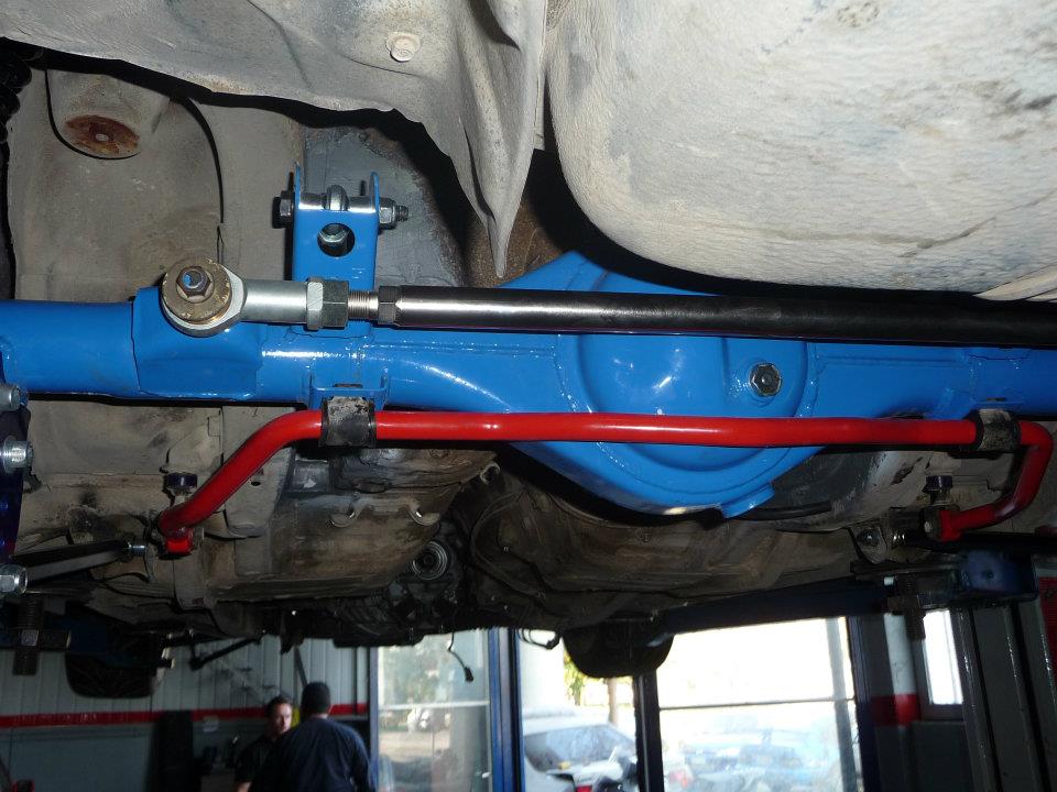

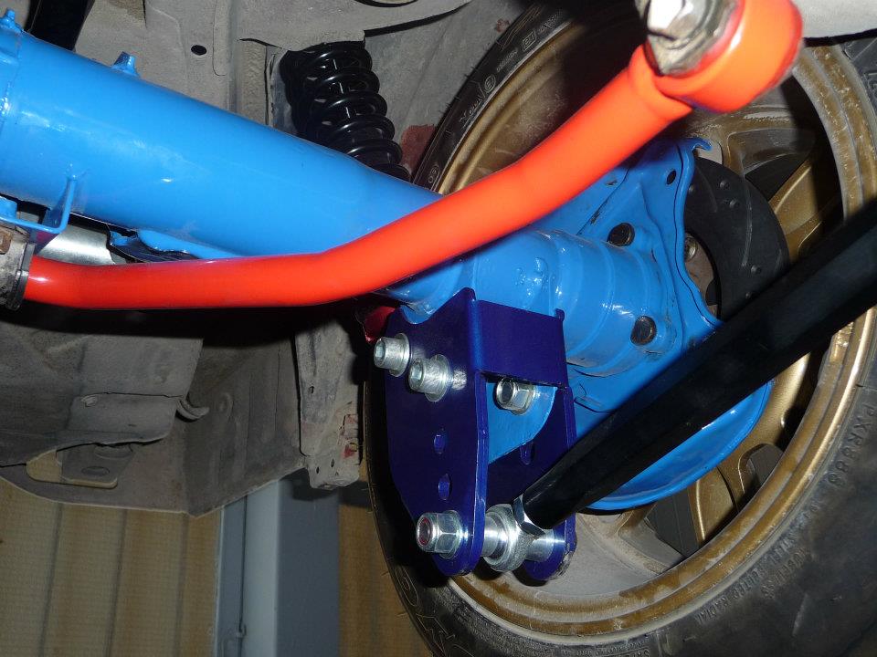

all other suspension parts are from tec art .the stabilisers are tanabe 25mm front and 22 for the rear . toyo tyres r888 205 front 225 rear .also ajustable brake cylinders and alloy hubs for the front wheels
