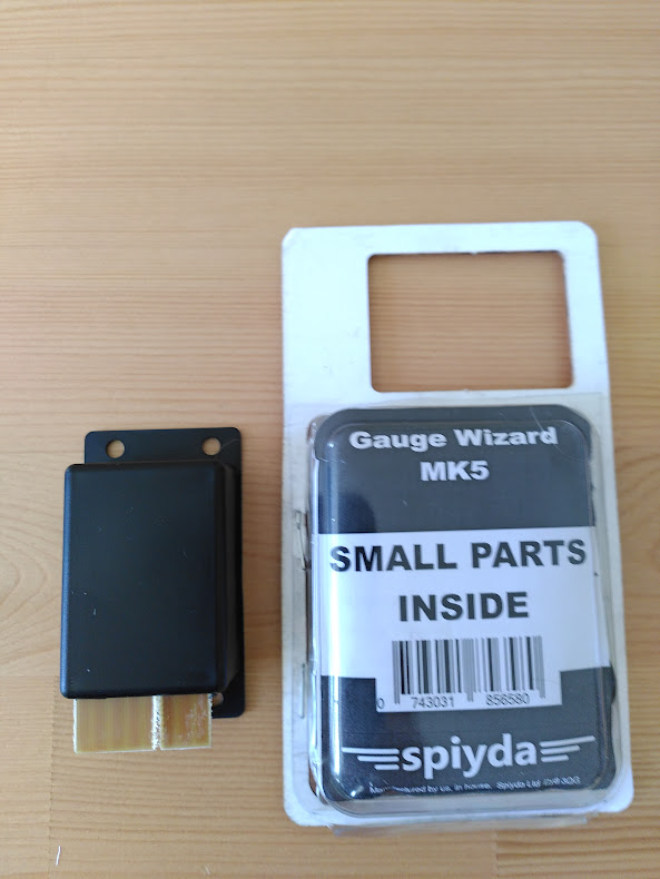

Today this arrived:
[Image: AEU86 AE86 - Digital Dash]
I've ordered the Spiyda Gauge Wizard. A few weeks ago I already bought a NOS analogue fuel sender for the Carina. It has the exact same resistance on low and high fuel levels as the AE86 analogue sender, so it will be a good test mule for the Spyda. In a few weeks time I'll have some spare time on my hands and try to test if the Gauge Wizard can be used to convert the resistance to voltage.
