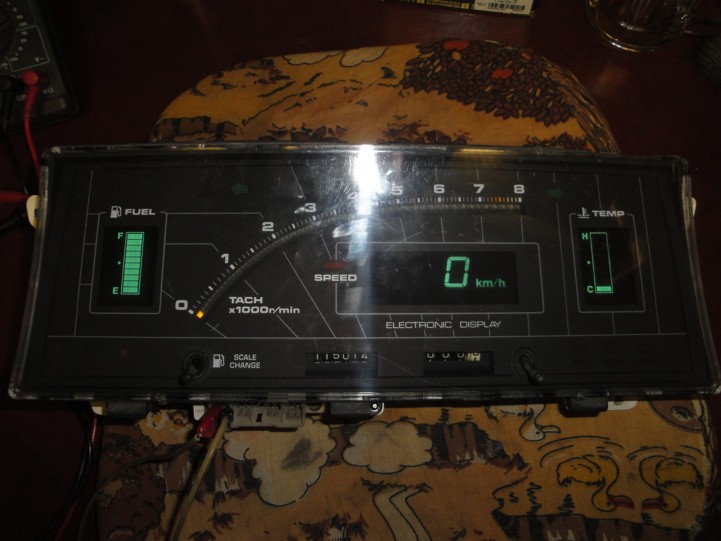

that's my same problem. the tachometer also doesn't work. i connected the output wire going to tacho from coil, to the Pin2 (Black, brown dots) at the left plug of the digital cluster. it does not move.
btw, mine is KE70, not AE86 so I what I really need is the pinout. do I have to do more beside connecting the tacho- to pinout2?

yeah its ok. i followed what's written inthe excel file, but for me, tachometer is not working though. thanks

choyr Wrote:yeah its ok. i followed what's written inthe excel file, but for me, tachometer is not working though. thanks
If tachometer does not work even after so could be faulty IC T2685A.
It is used in analog tachometer

*** I found tachometer + and -. My tacho works. I'm not planning to use fuel gauge. but my fuel gauge illumination and water temp illumination did't work. Are they need different + and earth.
maybe because of this tachometer+.. which pinout is this? I'll try to check the IC of the analogue tachometer of my old cluster, it was working then.

I have all the information on my notes.... The problem was that the tacho was not working following the schemes on the web.
So, i've found some new schemes and made my tacho work properly.
I also have to get a led light working and have to disassemble my dash.
Maybe Saturday afternoon. If i'll get it done, i will post some pictures of my wiring!
Also i will post a picture of my schemes....

choyr Wrote:[quote="ilker_ae86"]
Defects will probably in digital dash.
Not necessary, others + and the earth
It is only + for digital and control lights
