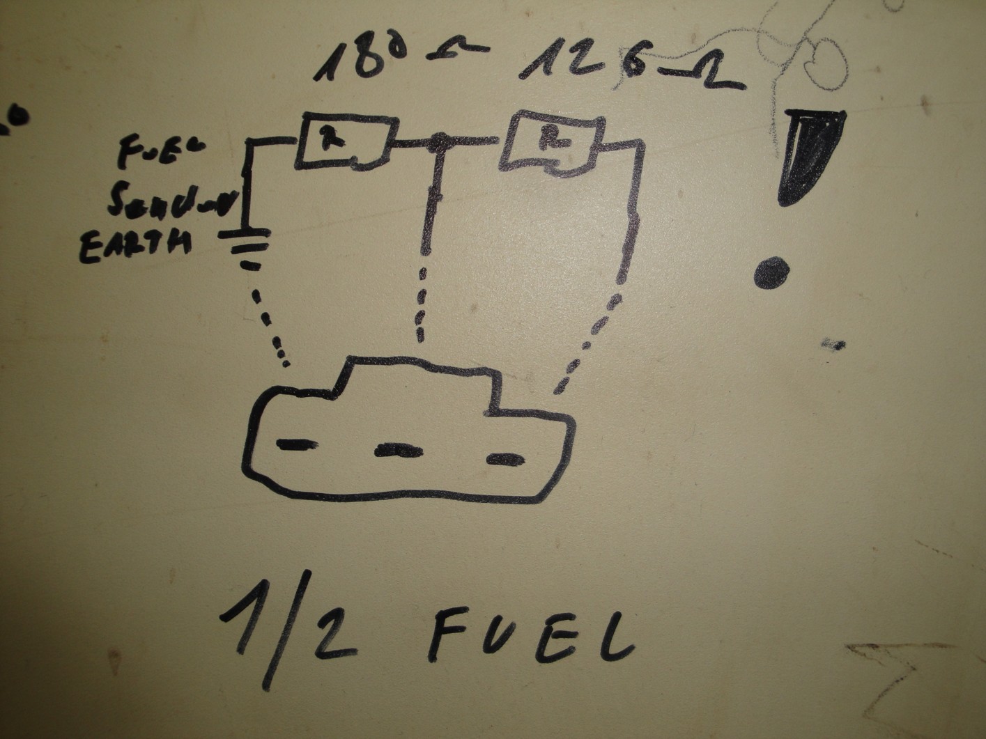

To Choyr: you must simulated fuelsender!!! Then you will work tachometer.
See schematic diagram!
07-06-2013, 01:30 PM
Post: #120
Digital Dash
If that is correct then it is very usefull info to have on this page, thanks!
