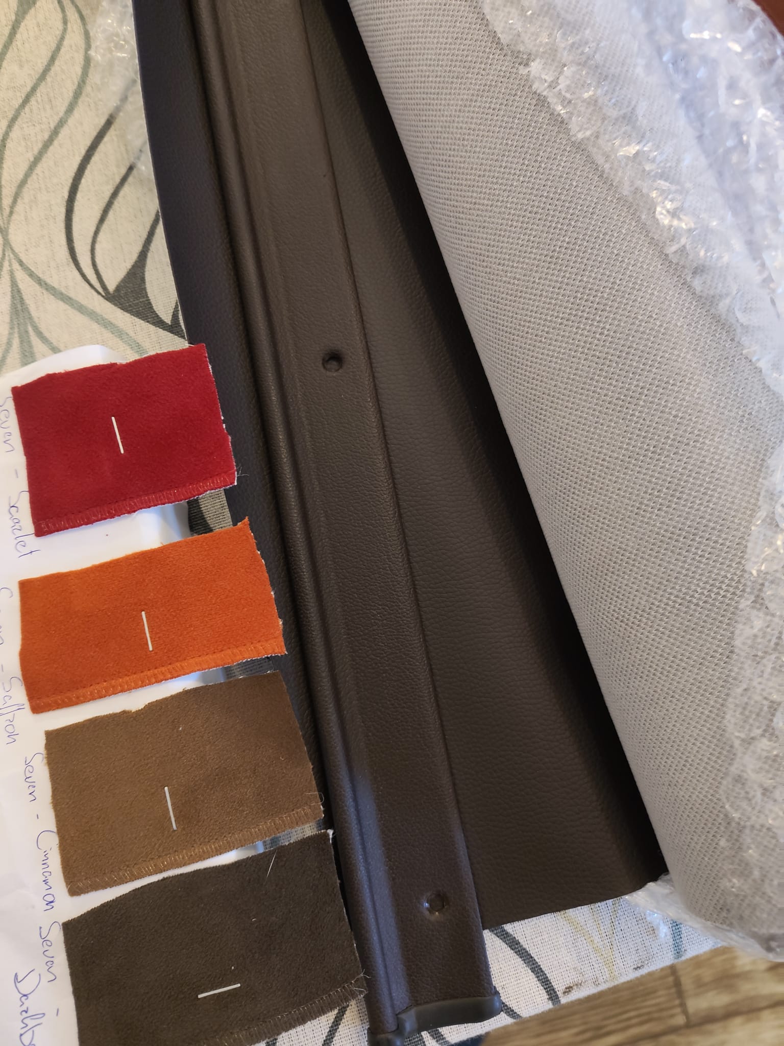

Quote:Yes i've requested some samples of fake leather of the same brand (textaafoam), more precisely is called Aston, while the velvet is called Seven.
I am not really satisfied of the fake leather, while it seems a good product, i doesn't look to have the same kind of finish compared to the oem.
The oem is smooth and more lucid, while this one is more soft the touch and doesn't reflect the same.
I was thinking to try with a more generic vinyl found on amazon that looks more like the original one.
If I'm being honest the best thing I can recommend to you is you find a shop that carries loads of upholstery materials and just have a look around their inventory. Seing and touching materials by the light of day makes it much easier to decide what you like.
I went to the building of this webshop: https://www.skai-leer.nl/categorie/premium-skai/, which is where I found most of what I used by browsing through sample books.
The leatherette in the link is what I've used in the previous picture by the way. Decent quality and I like the look of it, not too different from OEM. Have used a cheaper one on my own seats (I'm sure it will hold up fine), but this stuff is a little heavier, more elastic, and feels like it will last for ages.
By the way, here's a pic of a Seven sample card, shows up the colors a bit better. There is a darker red (wine red) too.

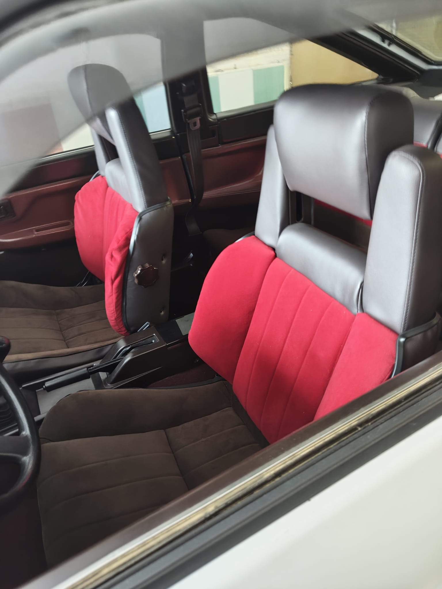

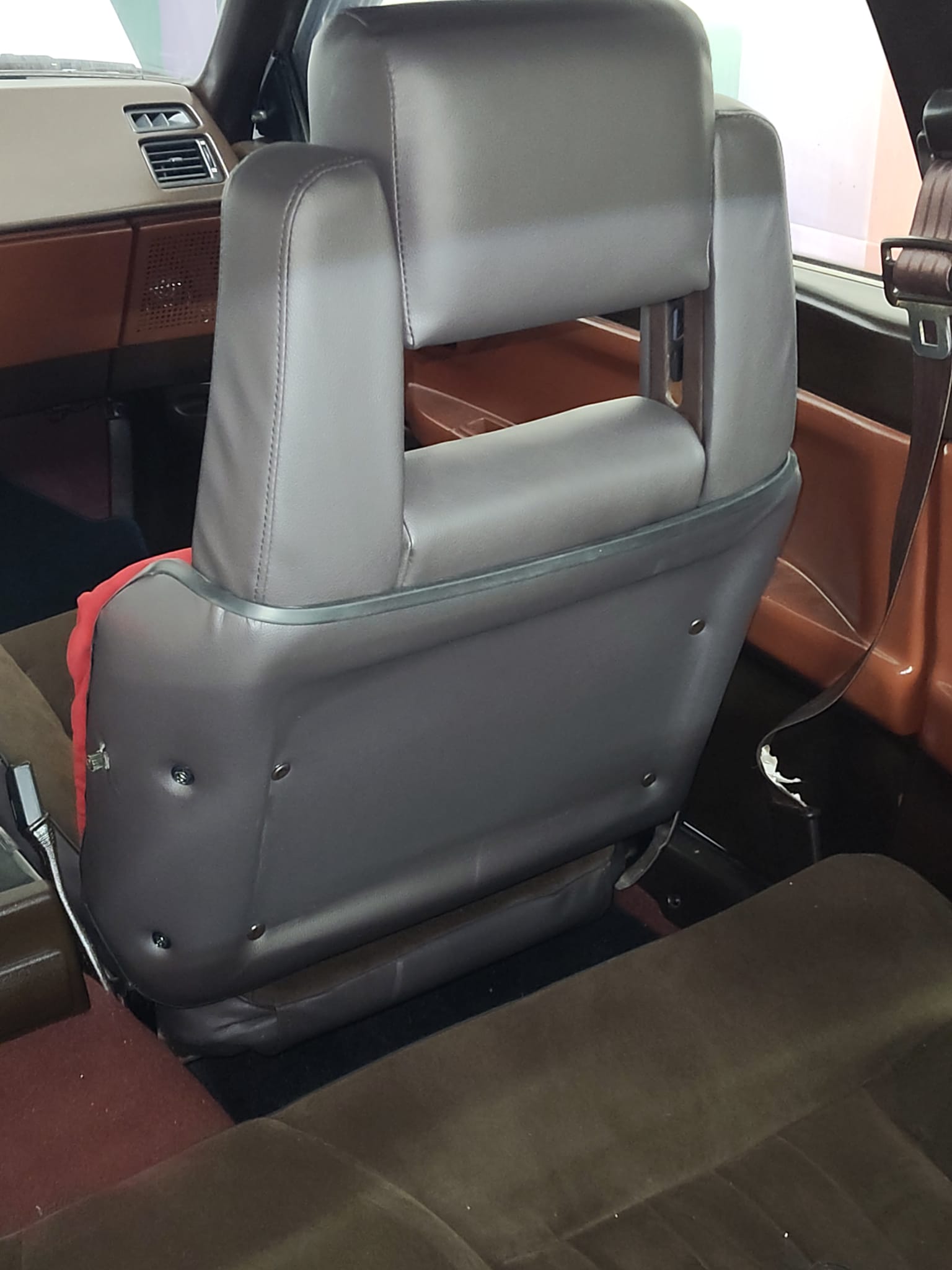

Ah yes, i've heard of the Skai material and on your seats it looks almost like the original, at least from the photos!
I've ended up purchasing a similar material (if not the same under another name).
Just received and i'm quite satisfied with the color, that match almost perfectly the OEM brown of the plastics.
Compared to the other fake leather samples, i like this one more because the texture is more similar to the original stuff, same for how it feels while touching it.
Now just need to wait for the rest of the fabric to arrive.

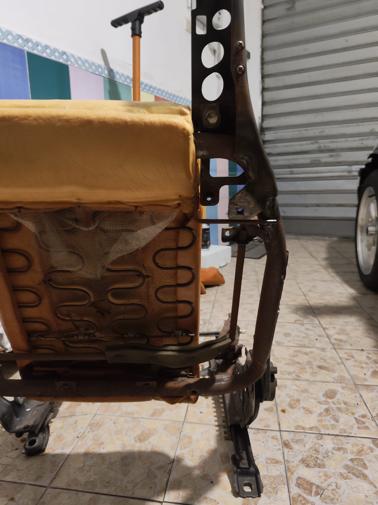

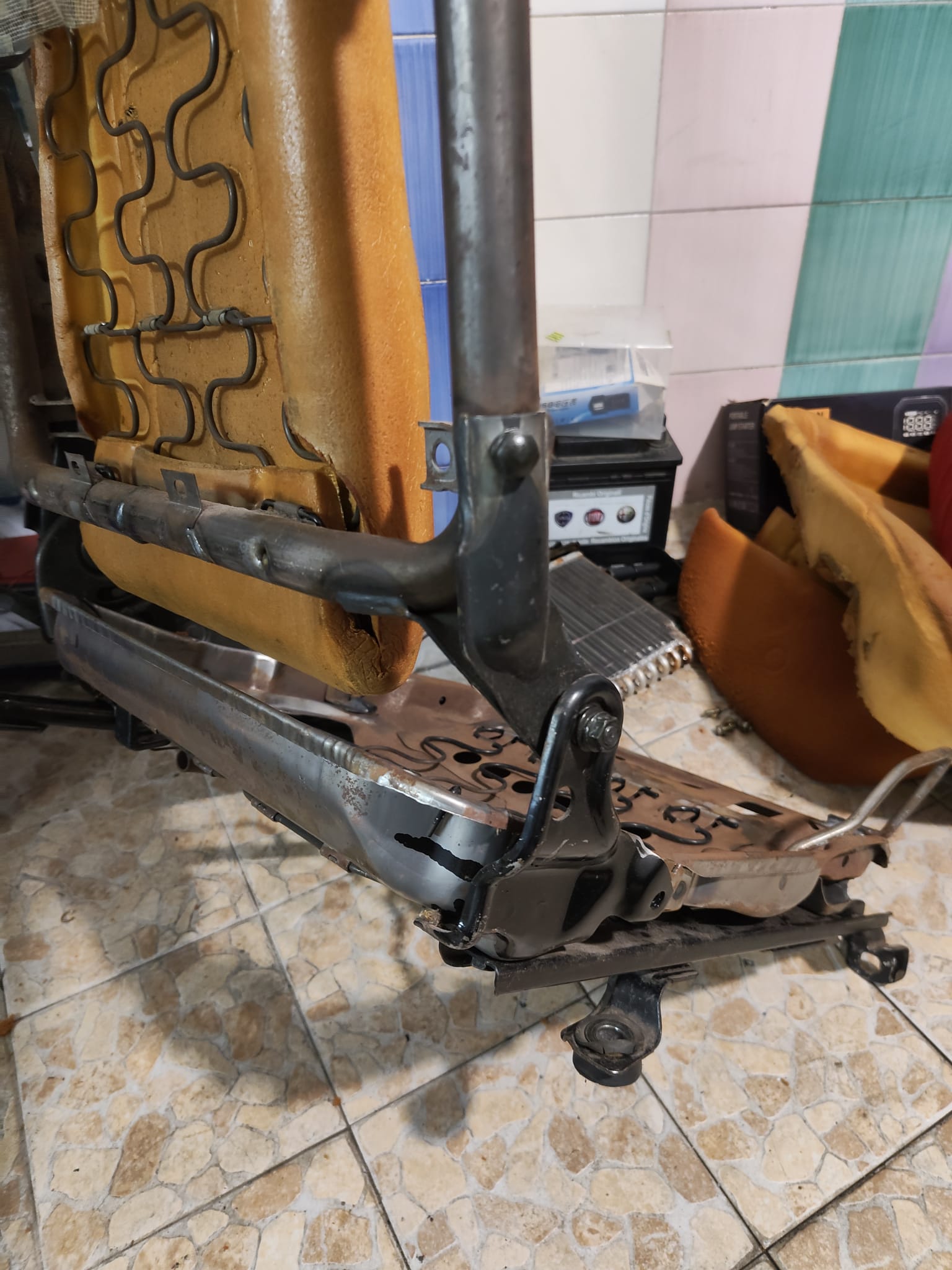

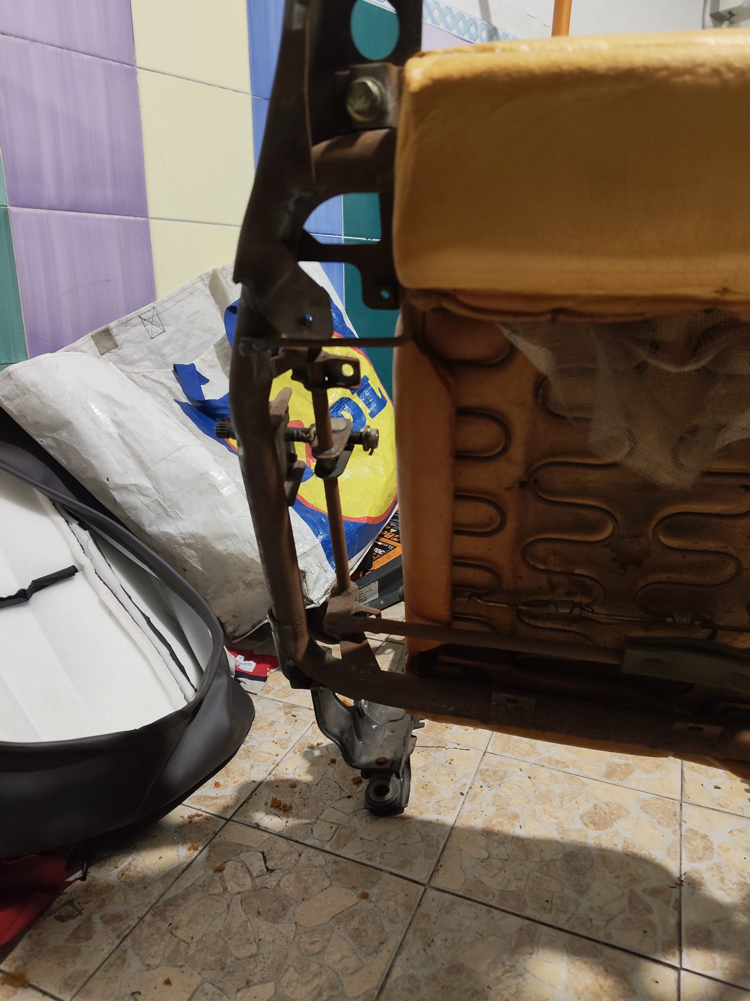

Here some pic of the disassembled seats for decryphe Smile i'll post the other photos in another post

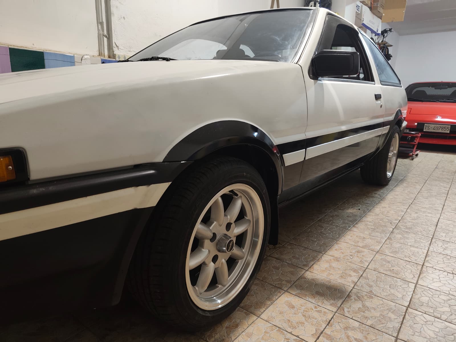

Final pic with the car finally out in good company Smile

(09-03-2025 03:25 PM)Blaze0010 Wrote:  Here some pic of the disassembled seats for decryphe Smile i'll post the other photos in another post
Thanks a lot! I'll save those and then take me a good moment to search for the squeaky source. Not much in the picture looks like it could be squeaky in the first place, it's all dead simple.

Also, clear lenses on the white car look pretty rad!
Congratulations on putting it back together this nicely.

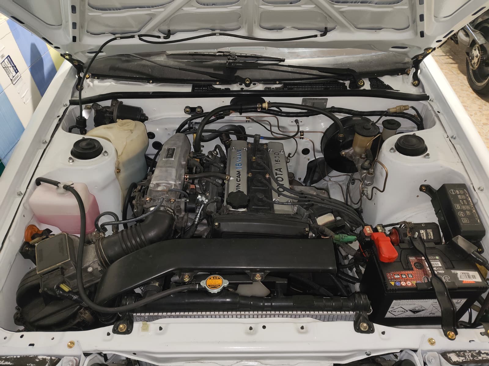

Some consideration after the test drive:
- second gear is a bit stubborn, at least under 3k rev, nothing crazy but maybe i could change the syncrho gear
- No leaks of any type, oil pressure always good. Same for the water temp.
- i think timing is a bit off, not by much, but acceleration is not linear, when revved it doesn't sound like a 4 cylinder. I'll double check this. From the video it can be heard a bit.
- After parked i heard an hissing sound from the fuel tank, and when i opened the cap it released quite some pressure. Fuel level is really low honestly, and also sitting for a while, so i think it could be just this, or the charcoal canister clogged, i will also double check this.
Beside these minus "issues" it all look good and promising!
