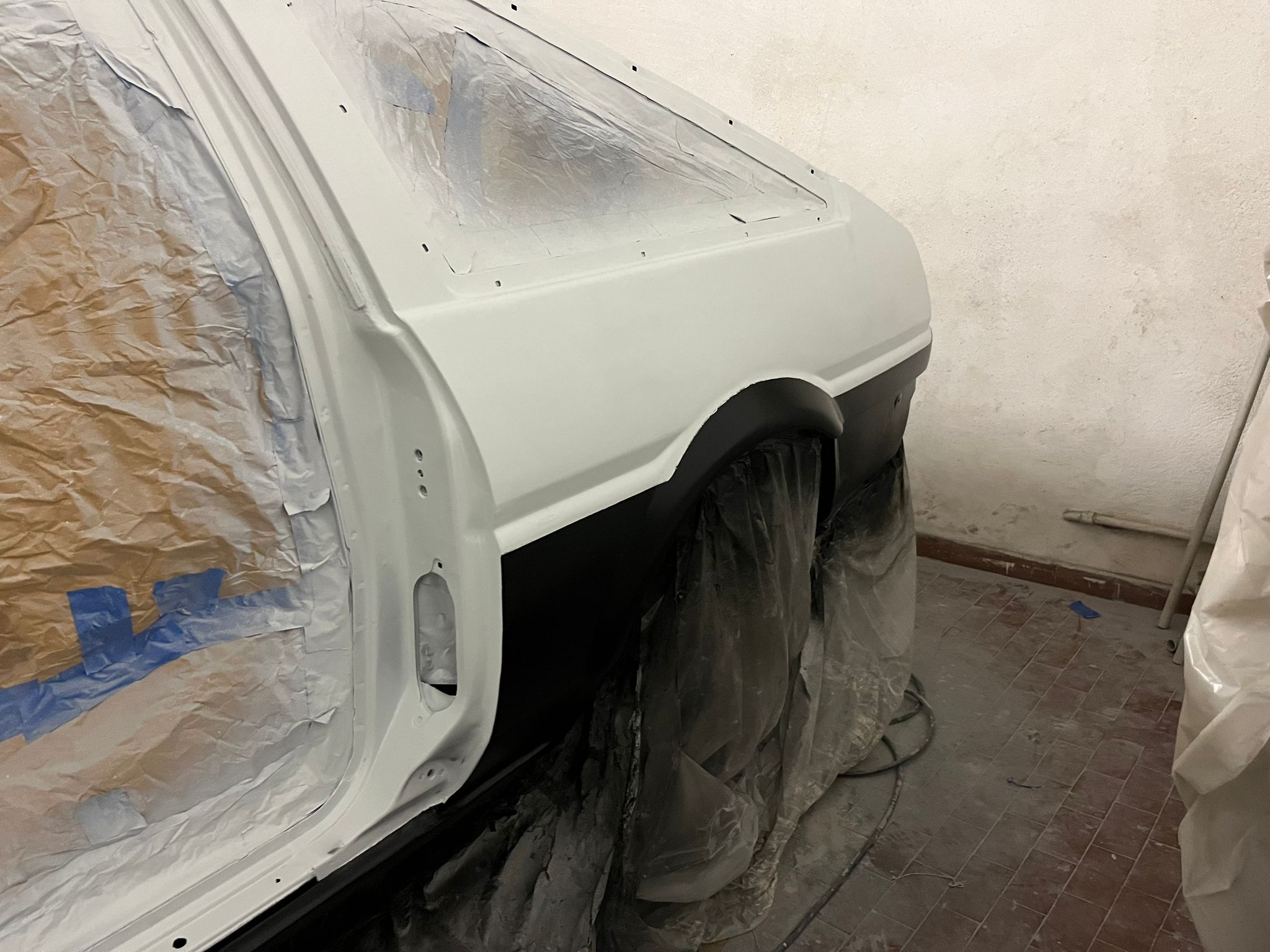

08-17-2023, 12:59 PM
Blaze's AE86
I believe this will answer the question!
[Image: AEU86 AE86 - Blaze's AE86]
Ultimately i gave up and indulged in the white (03Cool and black (202) panda scheme Smile
Unfortunately there was some issues with the tape, and i'll need to refine/clean the line where the two colors meet. Other than that i'm almost satisfied, considering it's and home made job done it in a garage.
I've tried to respect the OEM painting, with the curve at the back of the car, and keeping the correct measurement for the bottom black part. I have already had the Trueno front wing, so it was easy to use it as reference.
Again, it's not perfect, but i think i can adjust it to look fine. I'm really never happy with my works Sad
But at least, in the next weeks i can finally get it back on wheels and start to mount some stuff Big Grin

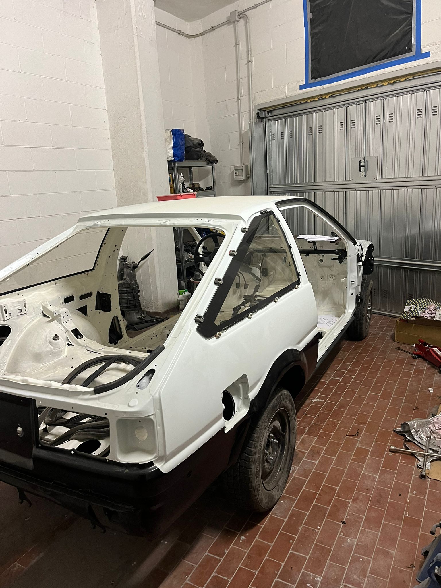

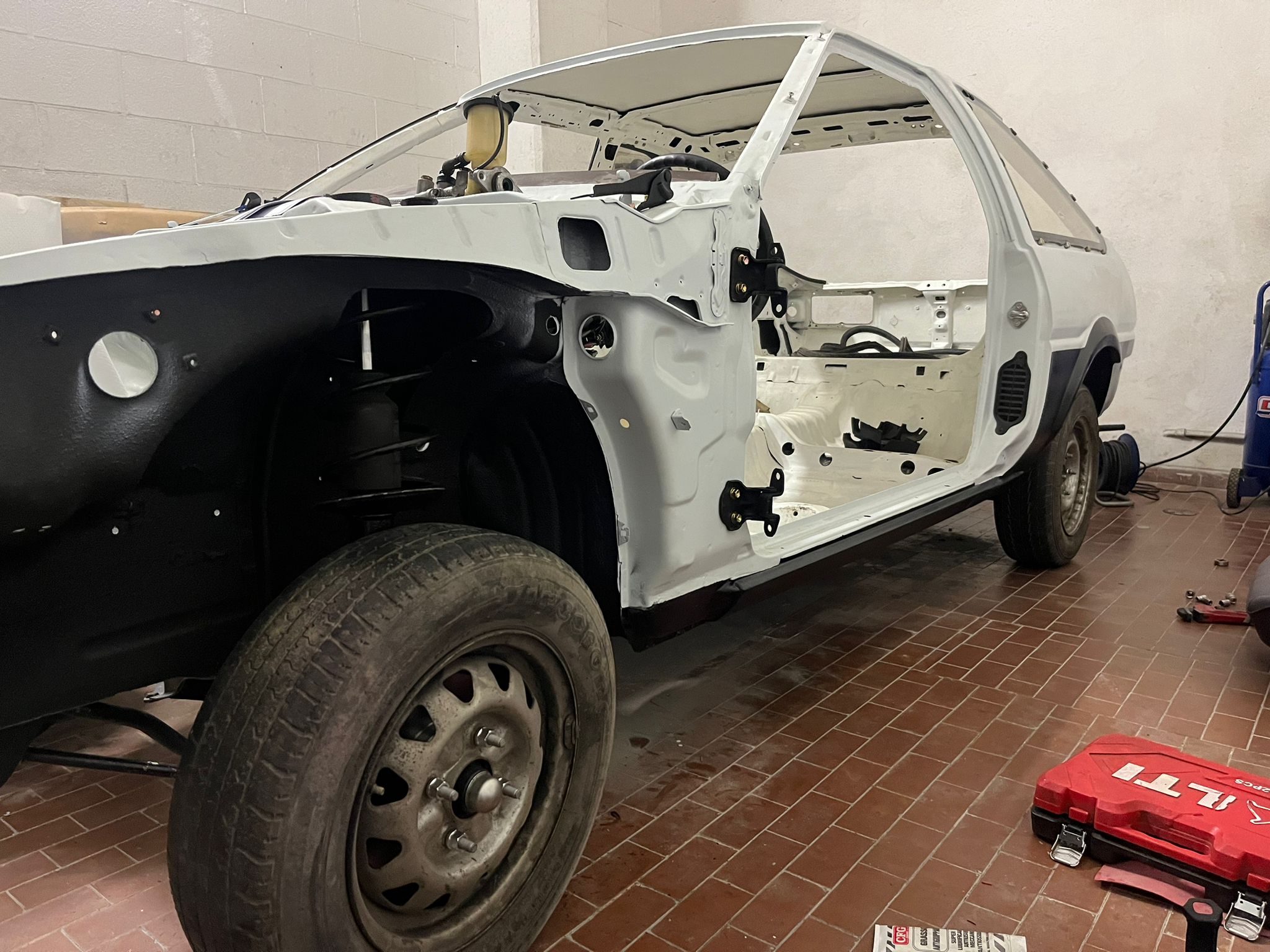

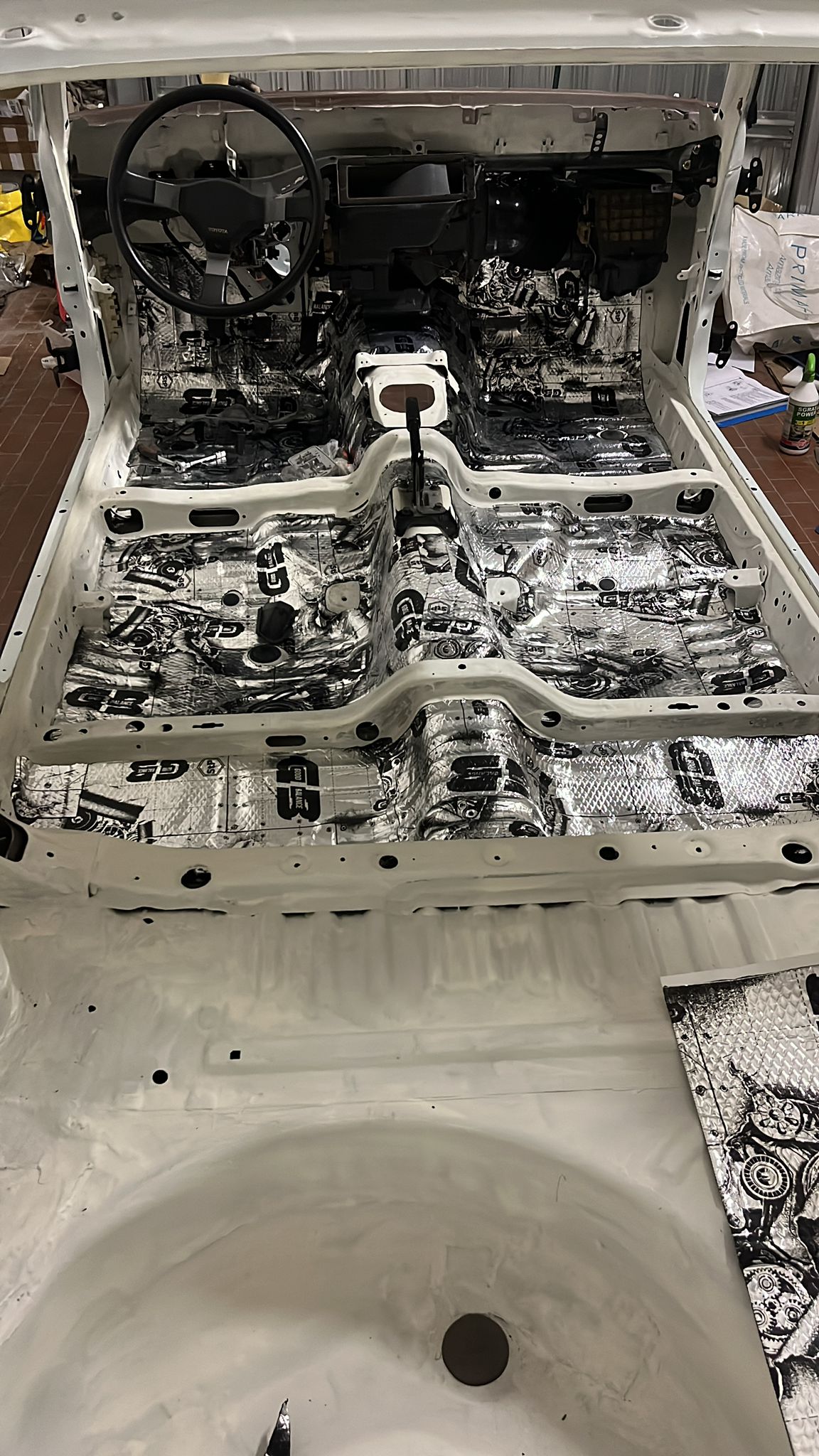

09-21-2023, 04:51 PM
Blaze's AE86
Thanks for all the info, appreciated!
Now some update! Finally, after almost a year and a half, it's on the wheels again! Big Grin
I've added insulating material on the floor, added the quarter windows, assembled (almost) the pedals and heater unit.

Next steps are:
- Rebuild the brake calipers and mount them
- Finish to fix door and other body parts
- Start with the wiring
- Mount the windshield
Once all of these stuff are done i will start with the engine rebuild, mainly because this way i can clear some space at home Dodgy

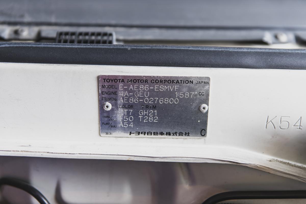

In principle the firewall ID plate in Europe (and Japan) doesn't contain a VIN as back then it wasn't a mandatory standard yet. In the US they did get a VIN on both the firewall ID plate and the firewall. So in Europe the plate contains the serial number, trim level and other details of your car. The serial number is also stamped on the firewall itself.
This is the firewall ID plate:
And this is the same serial on the firewall:
Most countries, like the Netherlands, only care about the serial on the firewall. You can easily tamper with the firewall plate, but not that easily with the stamping of the firewall. Also some countries (like Belgium) sometimes feature different plates riveted over the firewall plate as their legislation in the 1980s required that.
So you should be able replace the firewall plate without a problem as long as it contains the same serial number. You can buy them online and get the either engraved or stamped. Toyota used both methods for the AE86, where it depended on the factory which methods they used. Tahara (A52/A54) used to engrave them (like seen above) while Higashi (M21) stamped them. It is also important to note that they are stamped outwards, so from behind.
