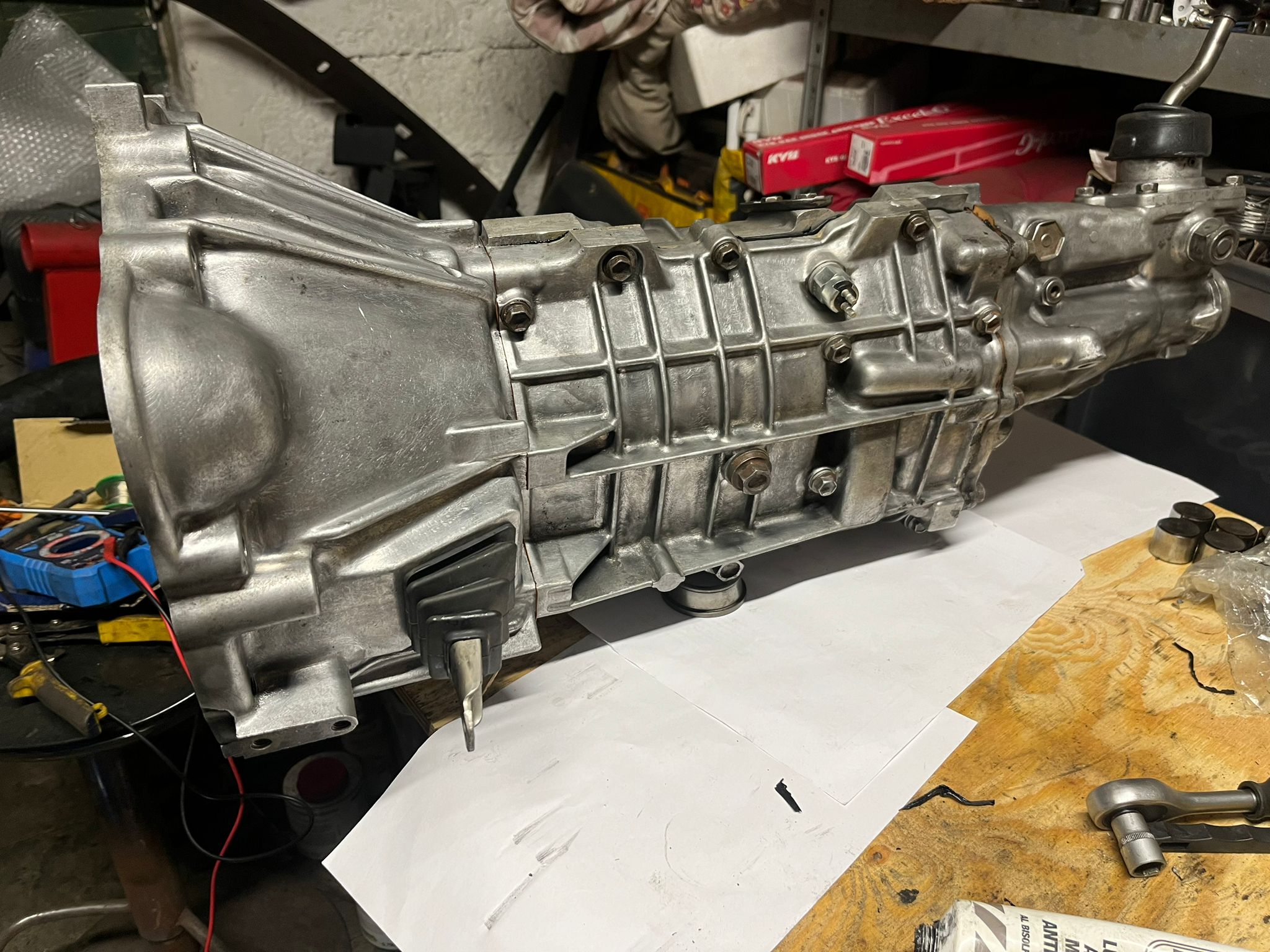

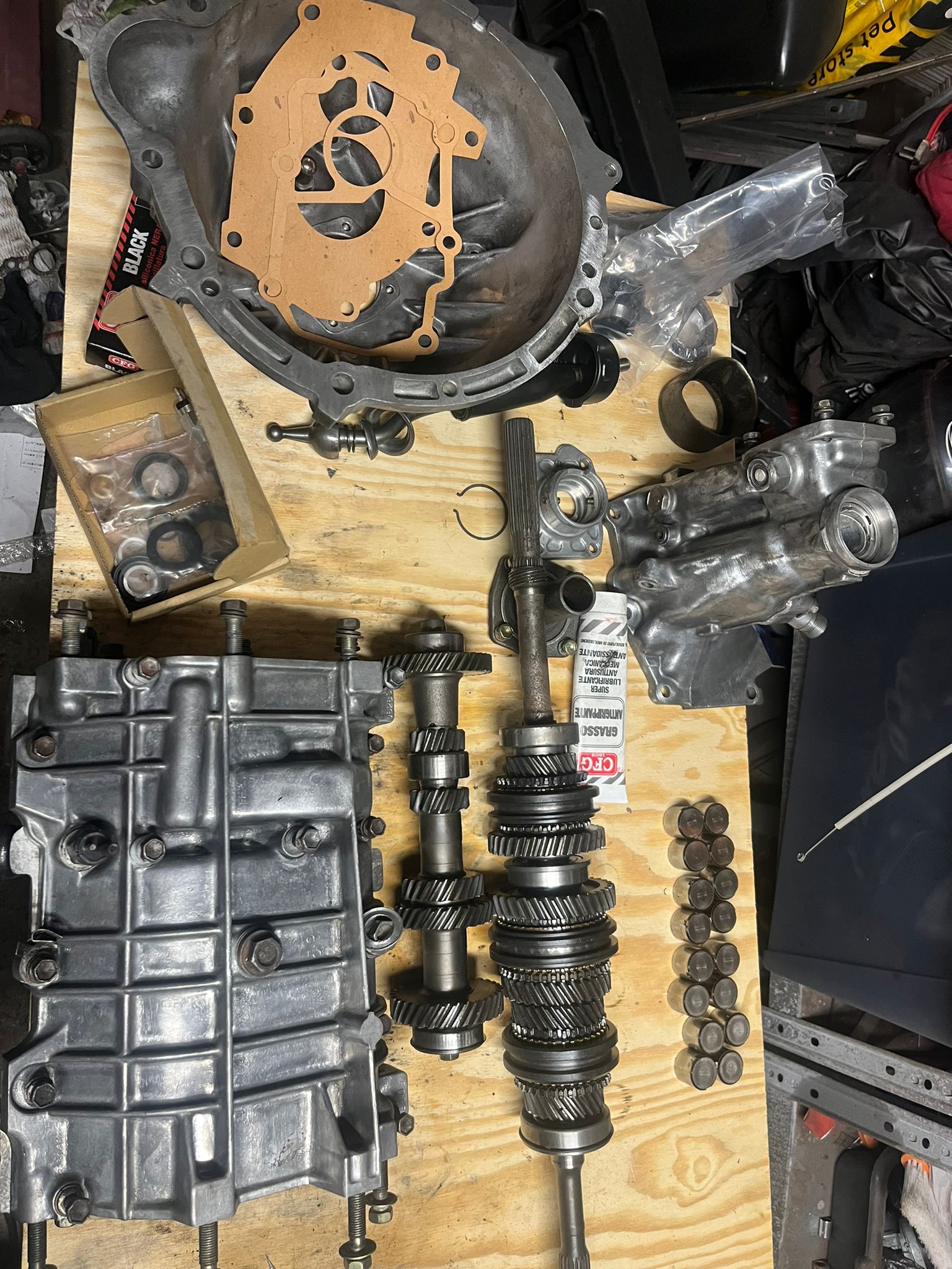

During my trip in Japan i've managed to take back home with me a gasket kit for the gearbox. So i've opened the gearbox and verified with pleasure that everything was good! So i've proceed with a very good cleaning of the casing, and assembled everything together following the manual instruction. While i was there i also replaced all the bushing in the gearbox lever, using the Cusco brass collar which should improve the feeling, at least compared to the old consumed plastic one!

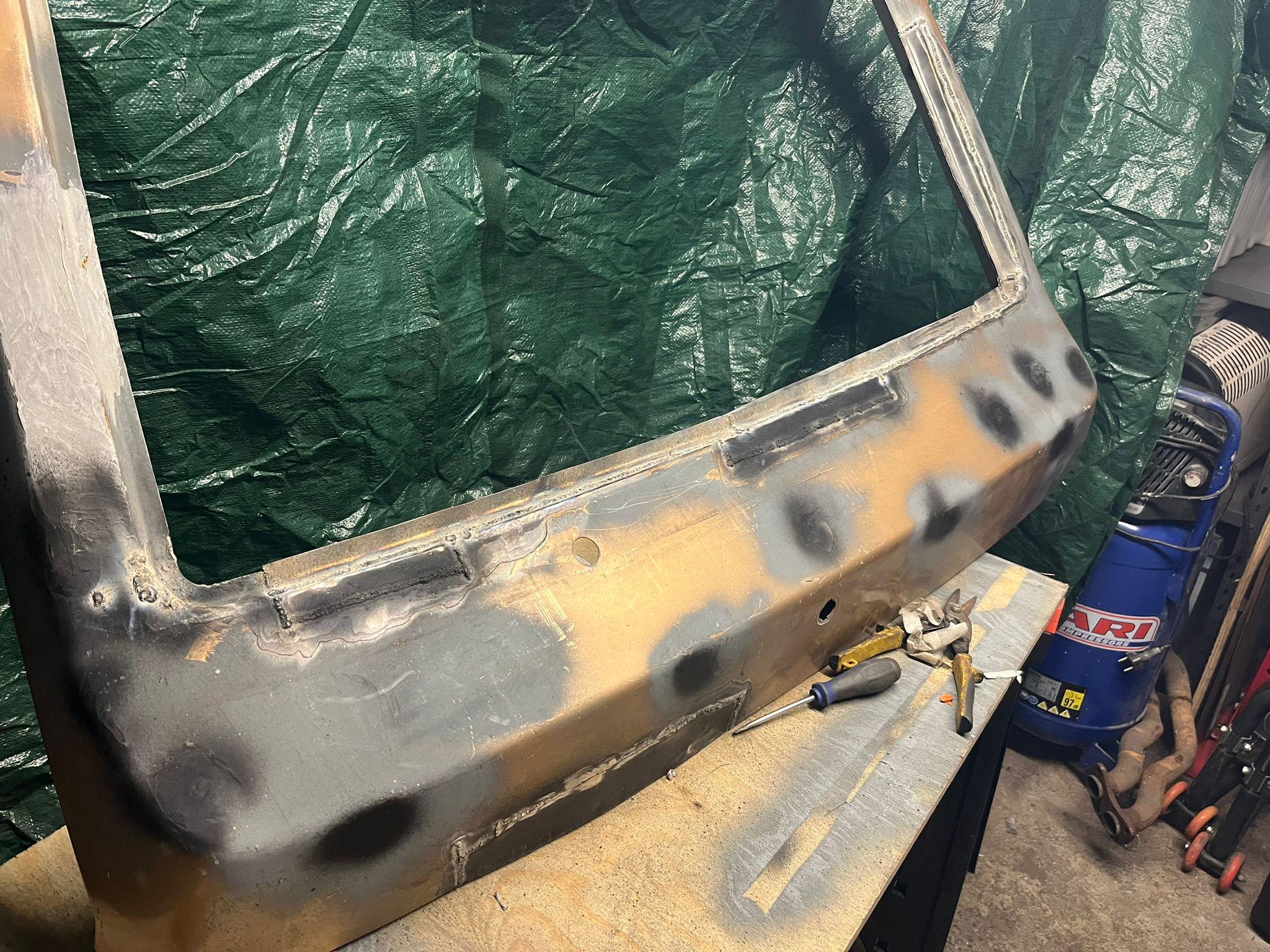

I've almost finished to fix all the rust on the hatch, just need to clean all the welding, and then proceed to use some filler and painting it. Be aware, my metal fabrication skills are very poor, and i've basically shaped everything with on old vise, a flat screwdriver and a definitely too big hammer. But overall i'm pleased, should be good enough!

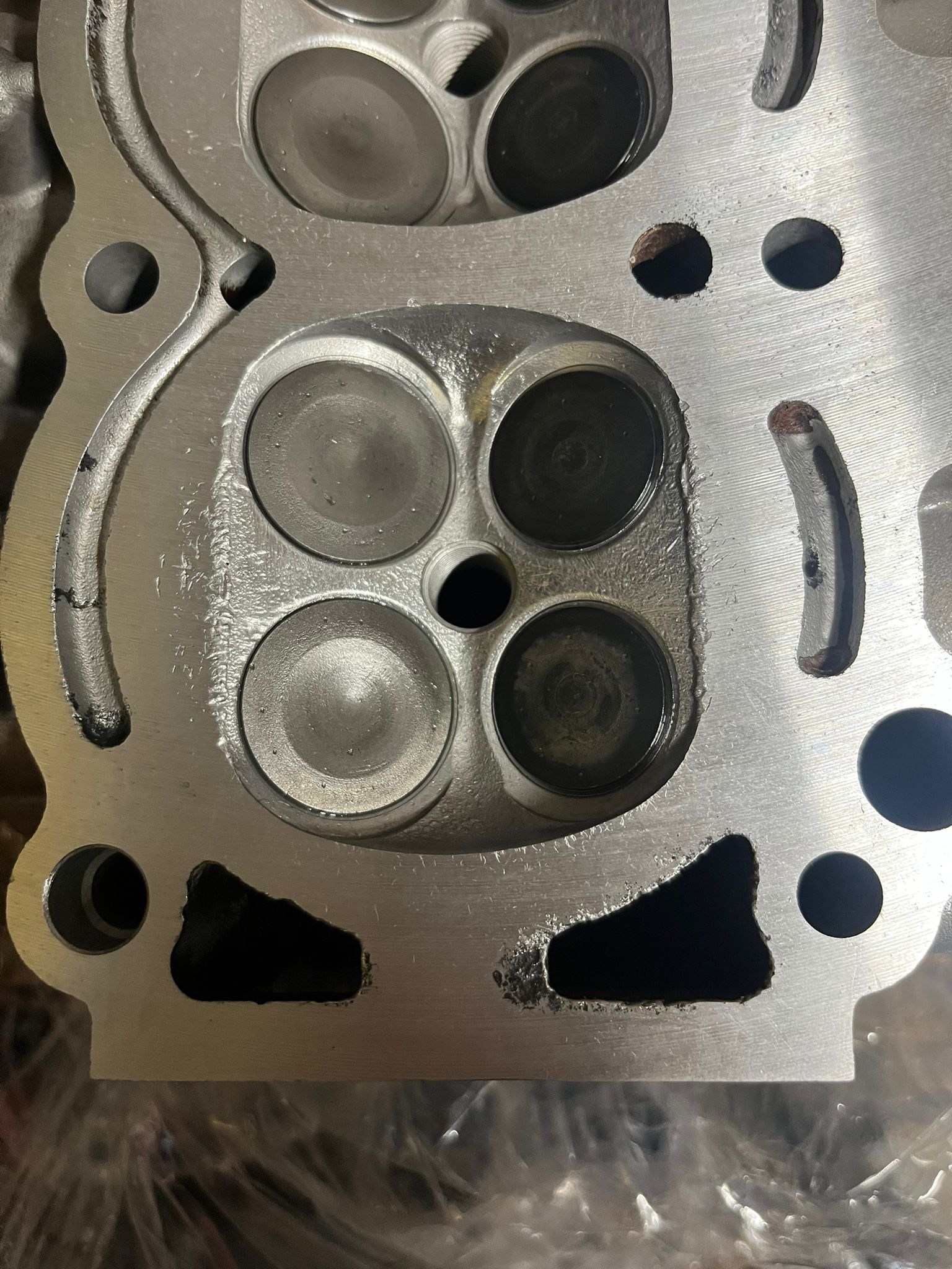

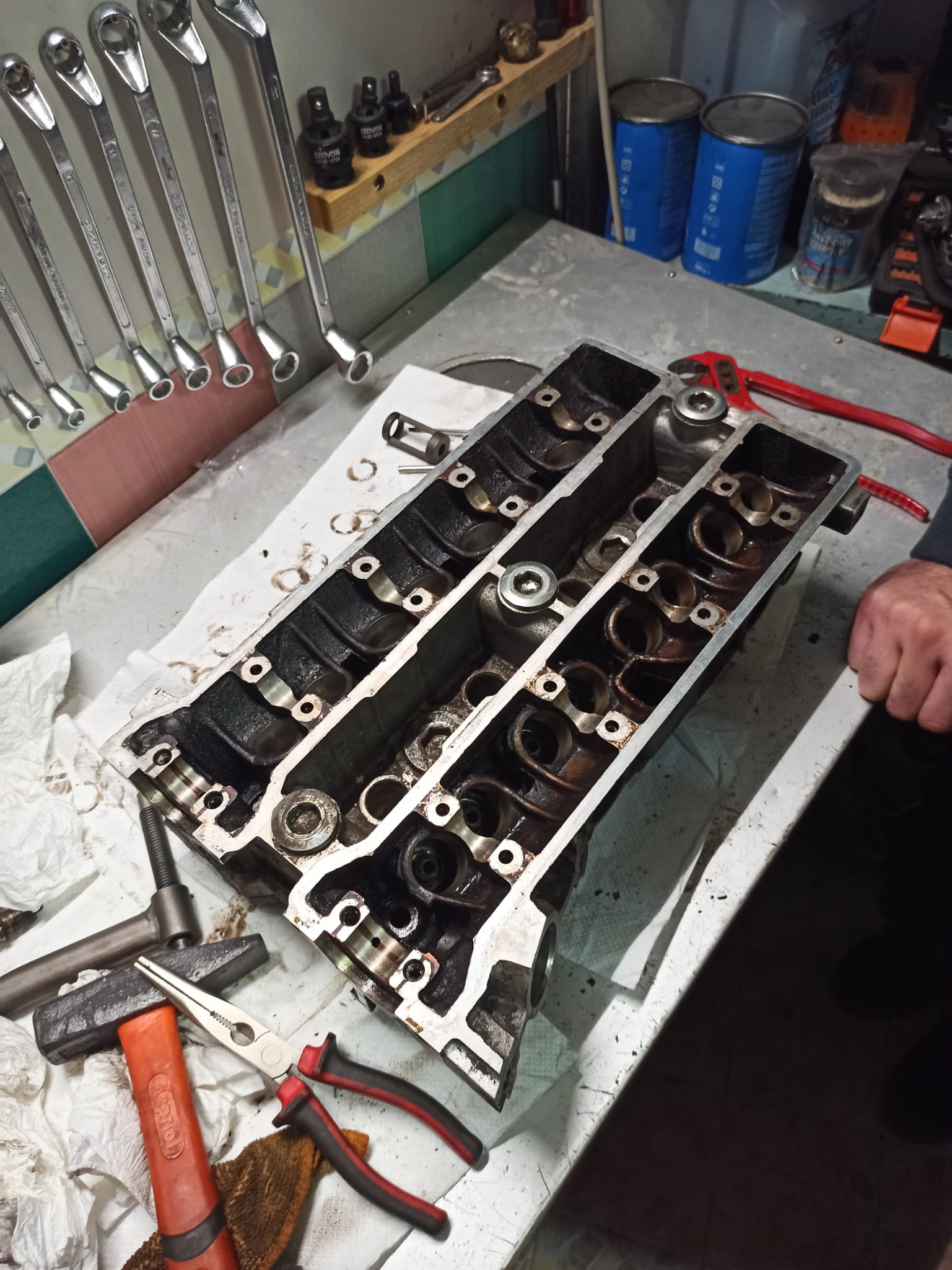

Skipping to the engine, the first head i've sent to the machine shop was unfortunately cracked in 3 different place, no chance of fixing it. So i've bought from our good FanIsHere a big port head. This head on one of the combustion chamber had some denting, probably some metal pieces that bounced in there for a bit. Luckily after resurfacing the head it seems a lot better, and i might just go and with a fine file and try to smooth as much as possible the remain imperfection.
[Image: AEU86 AE86 - Blaze's AE86]
Skipping on the enginge, the first head i've sent to the machine shop, was cracked in 3 spots, with no chance of fix. So i've purchase from our good FanIsHere a big port engine, where in 1 of the combustion chamber there was some denting probably caused by some metal piece bouncing in there. After the resurface it looks much better and i might try with i fine file to just smooth the remaining imperfection as much as possible.

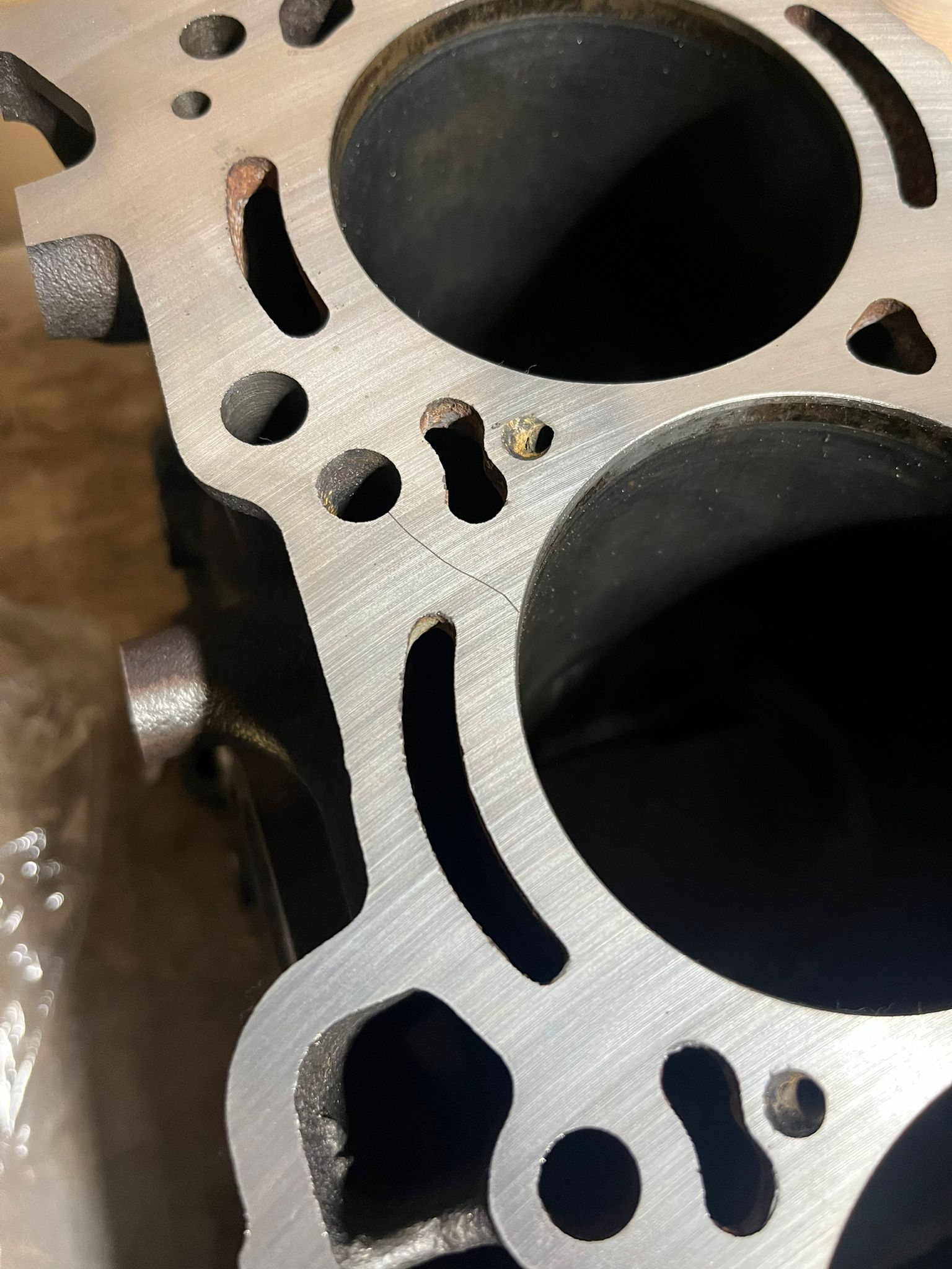

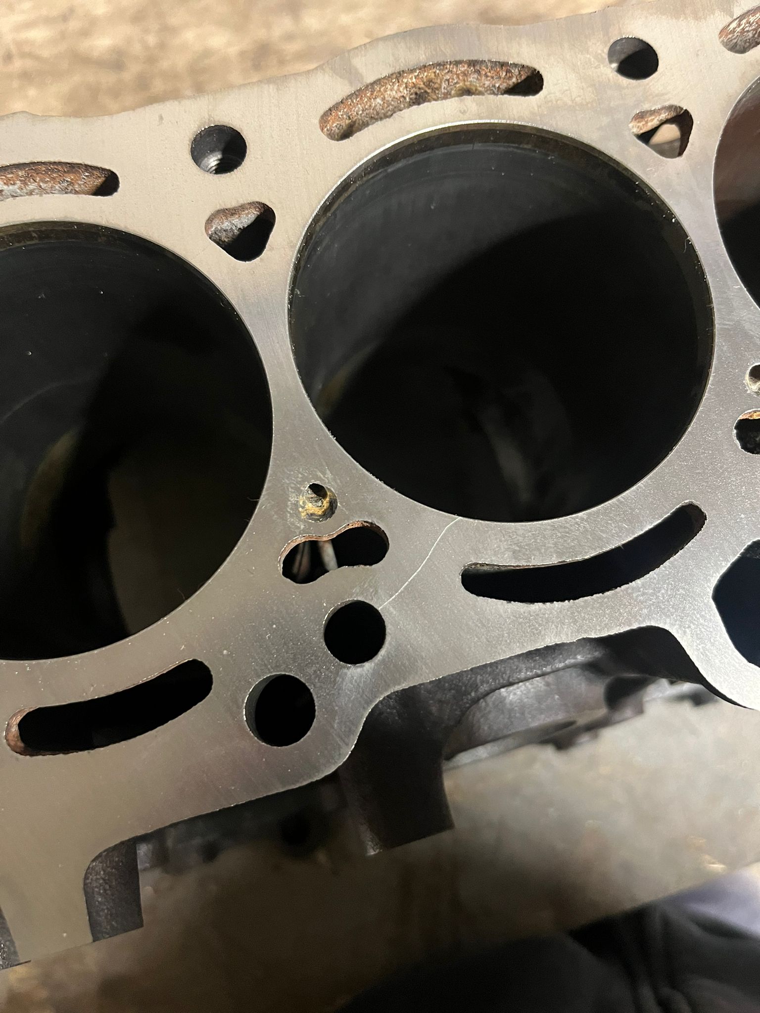

Lastly, the block. It has also been resurfaced and measured the cylinder:
- 81.15
- 81.06
- 81.08
- 81.13
According to the manual the maximum allowed is 81.20 to 81.23, so they are all still in specs, but what do you think? Better keep it like this or just go for bore all of them to the OD size, 81.50? One of the cylinder has some surface rust, but the machine shop told me not to worry.
Another thing for what i am not so happy is that with the resurface of the block they also left a visible scratch on the surface, so i'm still conflicted on what to do about it. Should be minimal and will probably never cause any issues, but you may never know Confused

I do not see a problem with the cylinder rust. A 320 grit ball hone with 15 to 20 stroke in each cylinder at about 45* you should be good to go. I would use something like copper spray on the head gasket. Torque it down in two or three passes. Let it set over night, then loosen each bolt [one at a time in sequence then re-tighten to spec, then move to the next bolt]

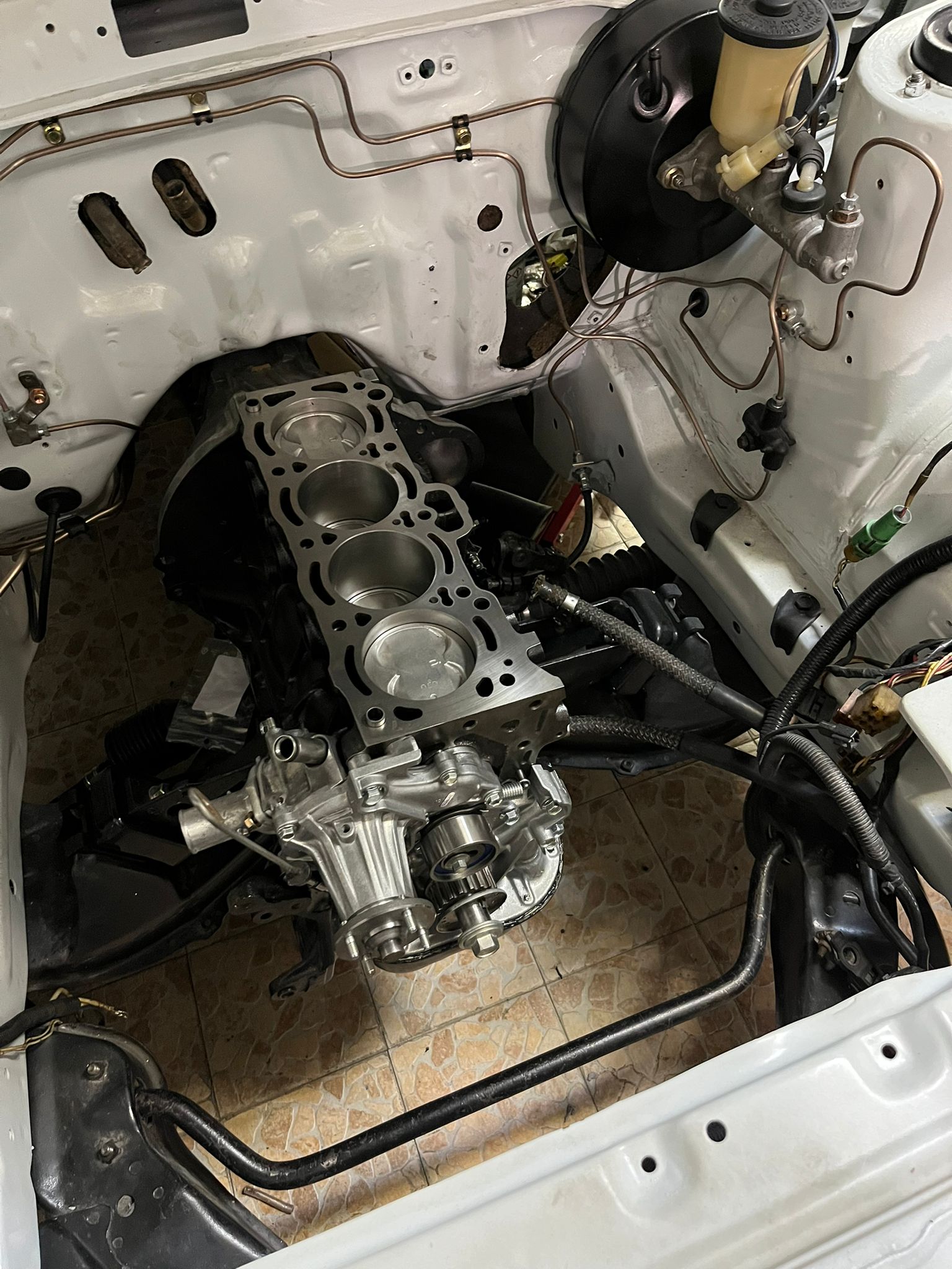

Since the last update i've managed to rebuild the engine, and basically almost completely put everything back in the engine bay.
Cylinder bored to 81.5mm and crankshaft and flywheel balanced by the machine shop.
Made new brake and fuel lines and and already put up also new clutch and pressure plate and the T50 transmission.
Apart from the front right caliper that i need to replace i would say that as of today 98% of all the mechanical stuff is done!

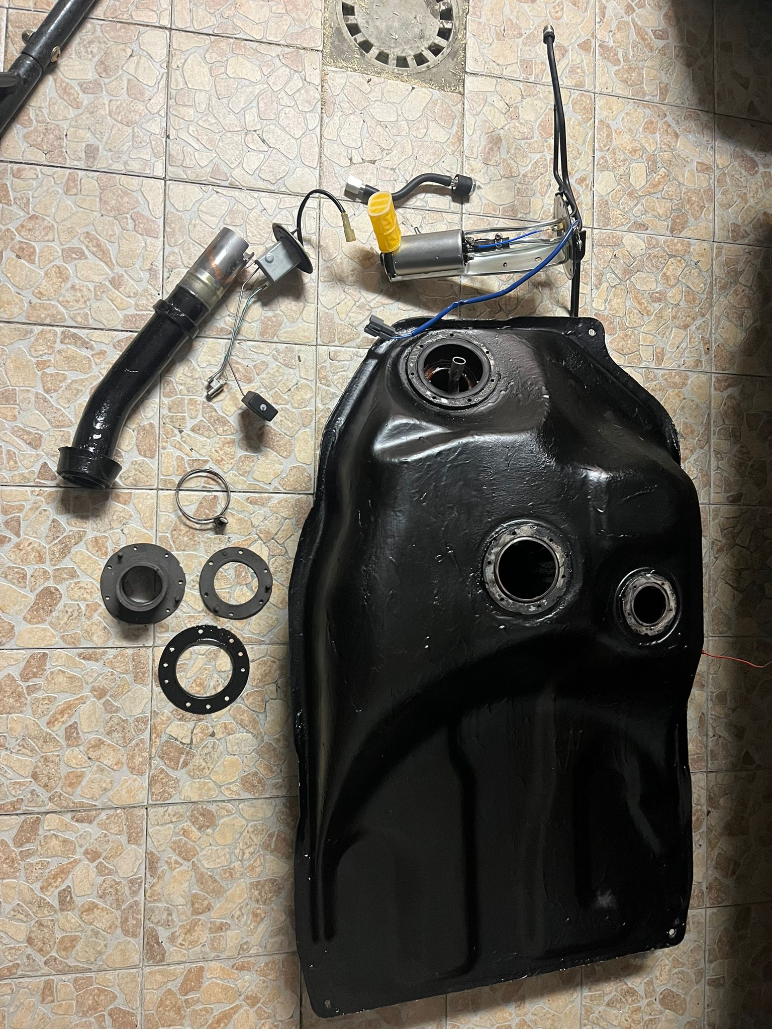

Completely refurbished the fuel tank, with epoxy primer outside and tankerite inside, new fuel pump cradle and fuel pump and fuel sender.

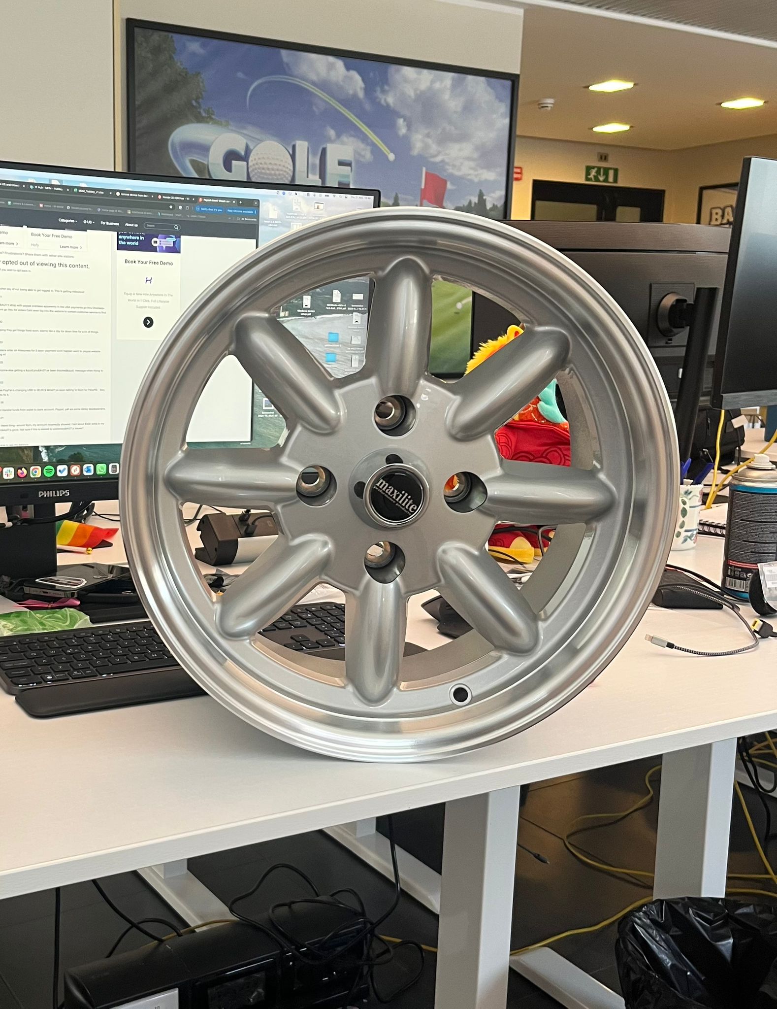

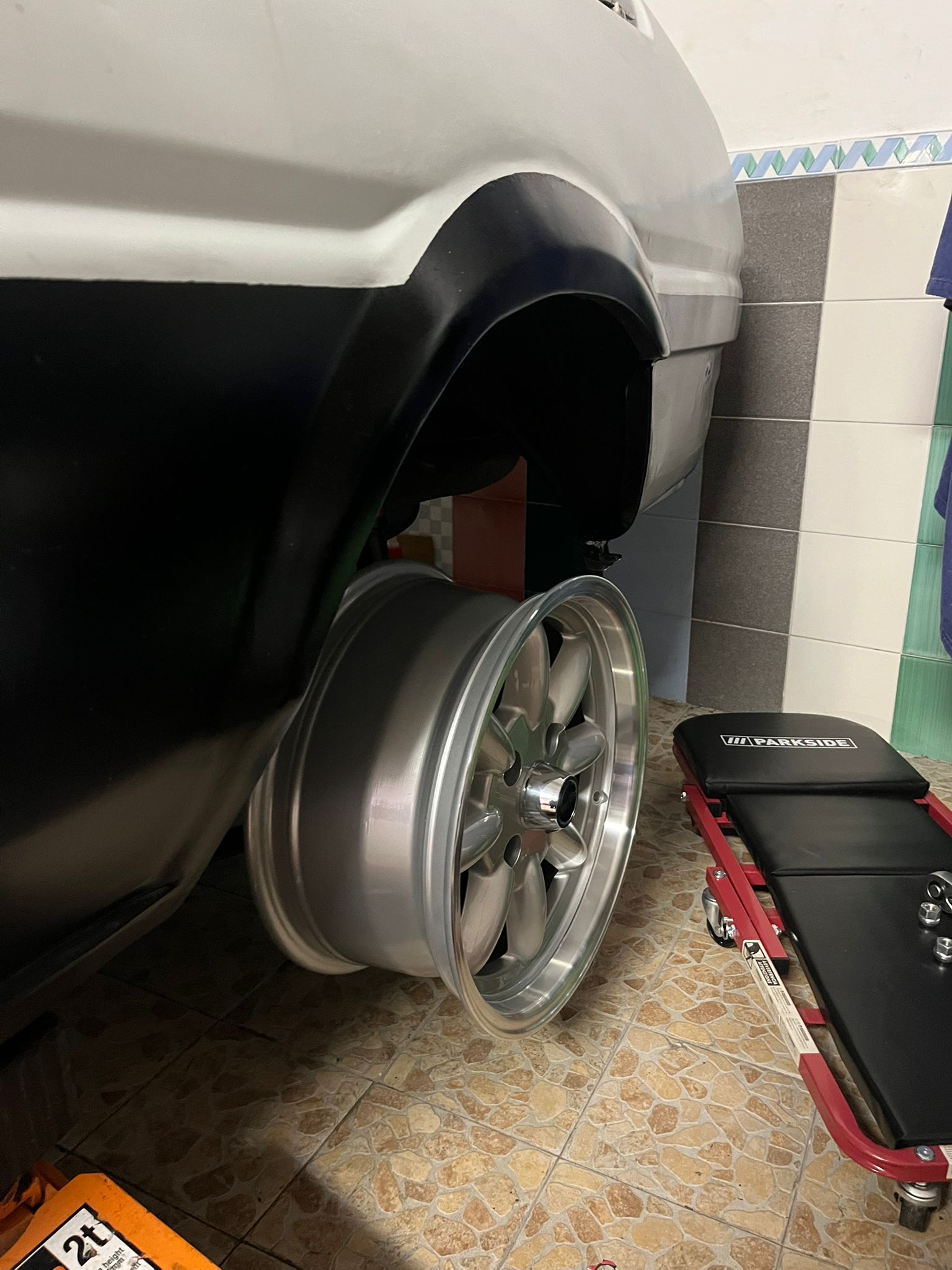

A small update that may be interesting for someone looking to wheels. I've purchased a set of 15x7 ET0 wheels from Maxilite. They have the classic look, price is right (205€ each) and most importantly come with a Tüv certificate!
For anyone looking for a nice set of wheels for a reasonable price, this could be a solution.
I've found them in the maxilite site, listed for the Datsun.
