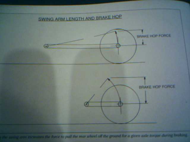

Have it explained on paper, need to make pics and attach here.
[Image: AEU86 AE86 - Axle/wheel hop?]
More anti-squat --> more brake wheel hop.

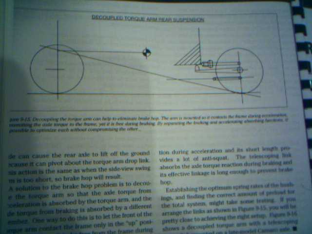

Pics from the book (very poor quality):
09-11-2007, 07:45 AM
Axle/wheel hop?
the books and URLs are about braking wheel hop. isnt that opposite of acceleration??
