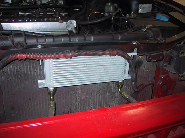

Mocal makes very nice oil coolers - we had one of those on our first AE82 race car and used the "sandwich plate" from an AE86.

You can use oil cooler from Opel Omega Diesel
84' AE86 Levin
96' 500HP WRX, powered by landikar
[Image: AEU86 AE86 - Aftermarket or used oil cooler ?]
