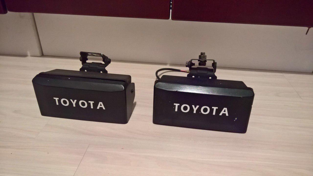

Hello everyone!
I'm probably installing a pair of Toyota auto cover fog lights on my 86. Question is, is the wiring harness prepared for this or do I need to draw some extra lines from the dash / splice onto the high beams?
What is the best way of connecting extra fog lights? Is there maybe even an extra switch that can be installed for this purpose?
[Image: AEU86 AE86 - Aftermarket / Additional Foglights]
Regards Hans

It depends how you wish to set them up. If you want to have them operate independently from your normal high beam/low beam you need to draw an extra line from the dash.
84hachi recently posted a video about his installment, including the partnumber of the Landcruiser switch he used for it:
The switch itself his oriented horizontally, so perfect for usage in the AE86 dash panel next to the door.
The partnumber for the switch is 84160-90K01
He got a general purpose relay+loom for ensure it is switched independently. You could get the same item from Amazon, but I'm sure it is much cheaper to get one from your local automotive partsstore.

I bought a pre-made loom on ebay for my kouki fogs. I can switch them on without the headlights on. I took the lazy route but i'm sure that you could cook up something nicer if you take your time.

That's awesome, this seems like just the right switch to use! I'm off to ebay, hunting parts...
