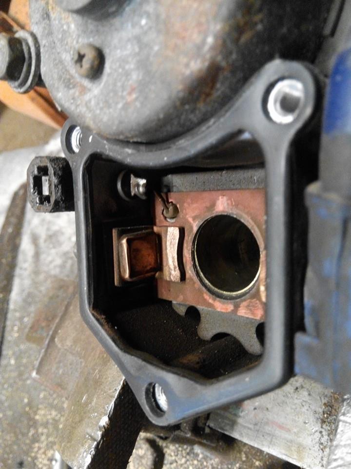

I had the same problem - same symptoms recently...
Pulled the starter and found as shown on the pics below. Cobber plate is out of concentricity and has been rubbing on the solenoid. Realigned - car started up immediately. |
