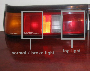

Oldskull: do the 3 door lights feature a foglight? I know the 2 doors never featured a foglight at all, so maybe it used to be wired up the same as mine.
10-15-2006, 04:22 PM
Post: #126
oldskull's Levin
banpei: I dont know how to explain, but the EU rear lights the one next to number plate is fog lights. I think picture will explain well.
10-15-2006, 04:27 PM
Post: #127
oldskull's Levin
and this I think the US one, but if not should it possible to do this?
