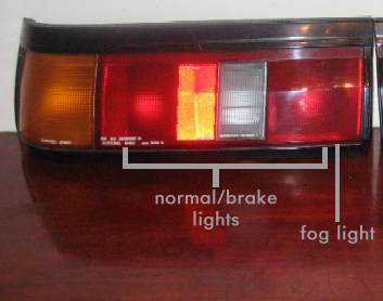

Oldskull: do the 3 door lights feature a foglight? I know the 2 doors never featured a foglight at all, so maybe it used to be wired up the same as mine. Confused

banpei: I dont know how to explain, but the EU rear lights the one next to number plate is fog lights. I think picture will explain well.

No foglights connected to the taillights.
However, you can do it yourself ofcourse. Have a double relay connected to the foglight: one for normal light/brake function and another relay for the foglights. That way the foglights can't amp the normal lights, while the normal lights still can light up the foglights. Then you probably need a resitor to keep the foglight not illuminating fully the whole time when you use your normal lights. Wink
