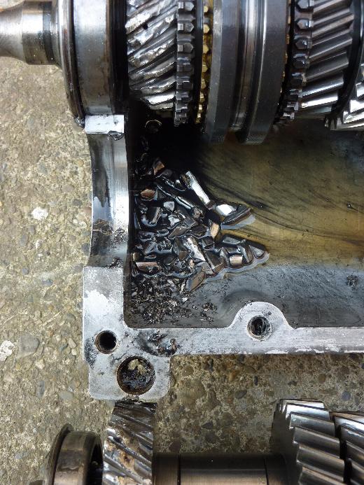

Just after 500m , into a rally stage , no noises before , and suddently,
a big CRACK , and i stopped .
No more move possible .
It'(s) was a TRD gearbox , , now a silent one .
I guess it's impossible to get parts to repair
The 4th gear pinions are both dead , but I think that the one on input shaft can't be changed (remaing stock on TRD gear set)
But It can be removed from input shaft.
I can use a stock one from the output shaft.
Any advices welcomed .
Defenatly too hard to drive with a stock gear box (4,7:1 gear end).

Does your rally class allow a gearbox conversion? I think a Ford gearbox would be much easier to maintain and find replacement parts for.

it is the drop gear that is broken 4 th are 1:1 and involve any gears
03-29-2013, 07:47 AM
my last work , Dentist needed
^ as he said.
That's your input shaft to countershaft gears that are stripped. 1,2,3,5 & R. 4th locks input and output together and should still work.
New gear set or new transmission.
