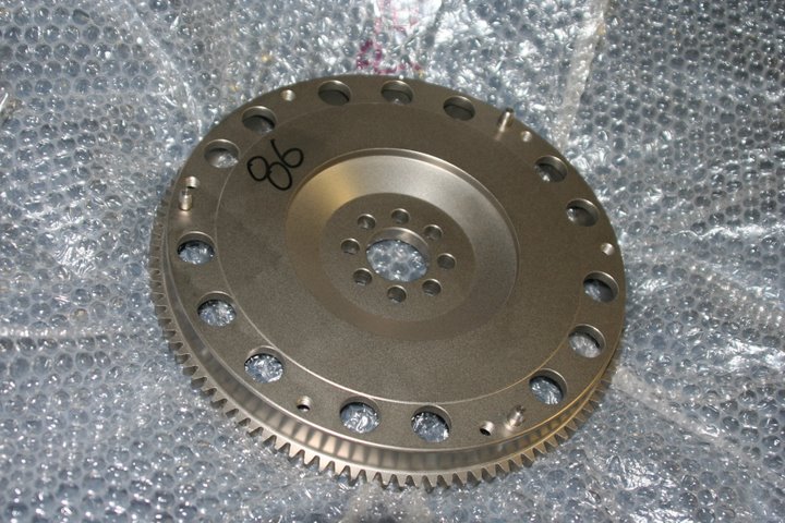

I have the Dog Fight Pro 3.7kg steel flywheel in my 86. It's mostly identical to the Toda one, except for a slightly different tapering on the backside, near the center.

I'm running a 3.7 kg as well (looks identical to the 'dogfight' one) which I picked up off of ebay.
