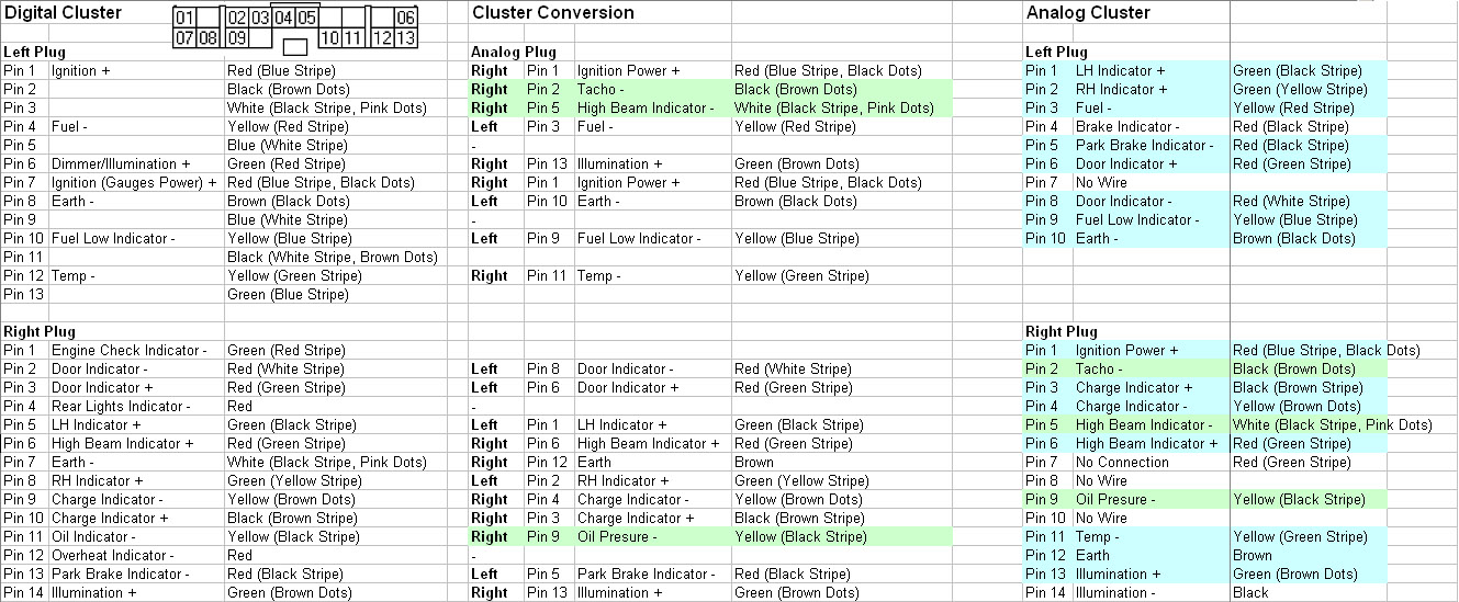

well i know that it has been asked before. but the instructions i have suck. seems as if he skipped a step before jumping to the next. all i need is some pixs of the install. the splicing and stuff.
i dont need some bastard to tell me to sell the cluster or tell me ha ha i have one and u dont, or the worst dont do it cuss its tooo hard.
any help would do. thanks..

I have completed a swap in my dash completly, so I can help, I have a wiring diagram that might be able to help but I had to re-write a lot of colors and stuff for it.
I found the best way to do it is find the diagram for the cluster, then use a manual and find the colors of the wires going into the stock dash, then just match them up, that is what I did. I took some picture of the install but I never got a picture of the wires spliced, which I should've, but I can help as much as I can by explaining it to you.

i did a search on here, and ur post is the one i found and read. i would appreciate any help. if u can email me a pic of that diagram when ur done w/ it would be great. the problem i also have is the white plug in the front. it seems to be missing wires so i think it from the stock harness, and not the cluster. what plugs (connectors) did u use? also the part where i have to splice into the fuel sending unit.

This is the diagram that I used.
http://www.aeu86.org/download/ae86/id/8330
