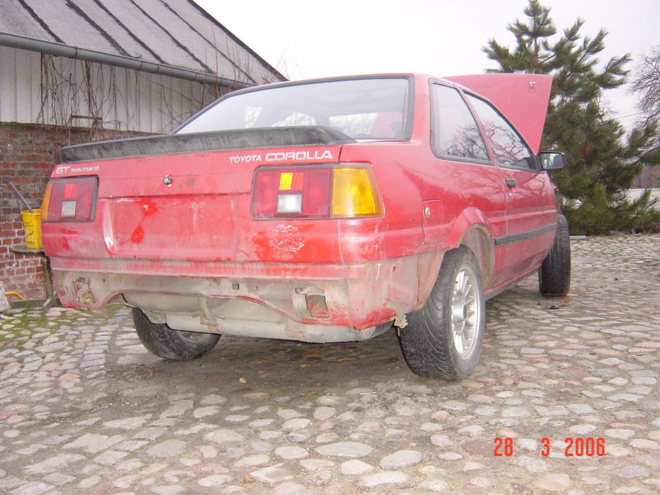

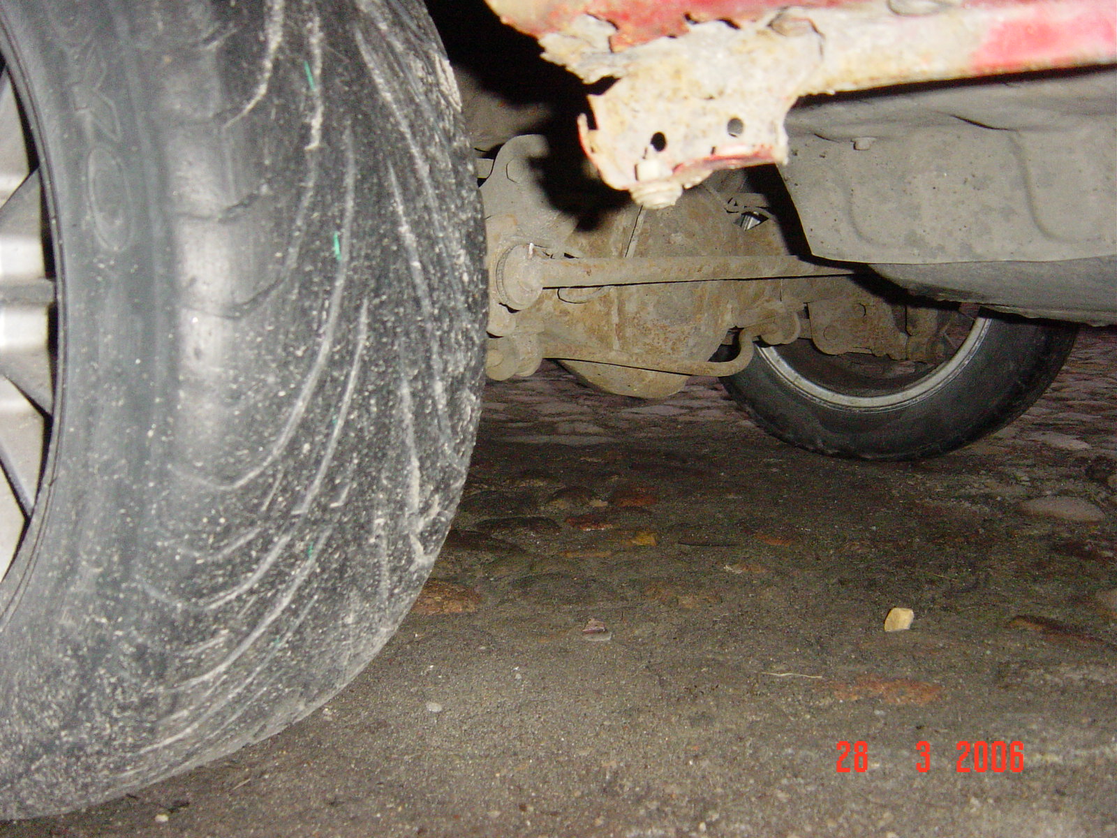

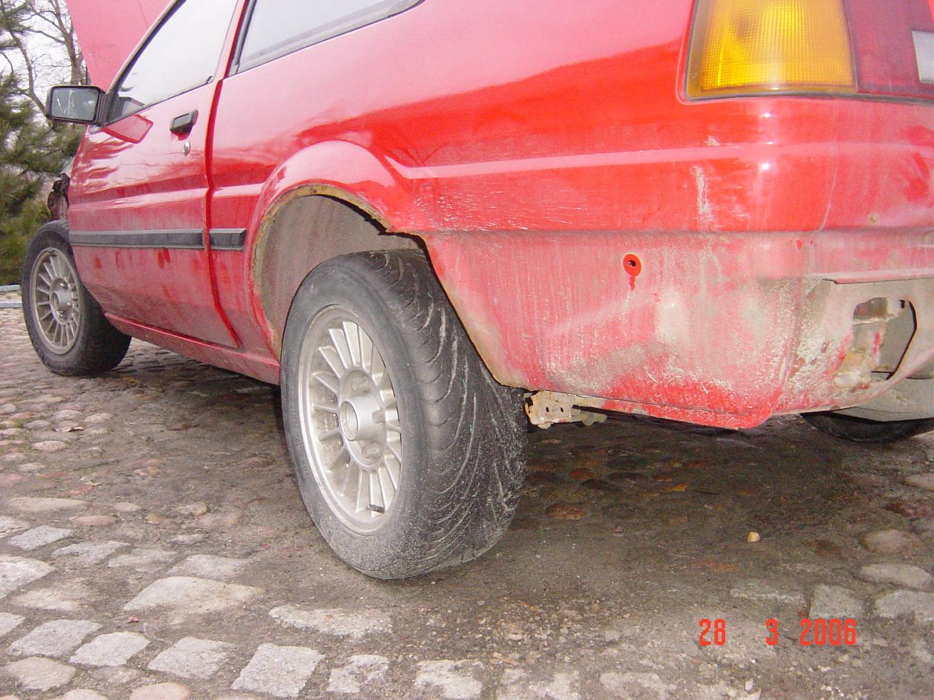

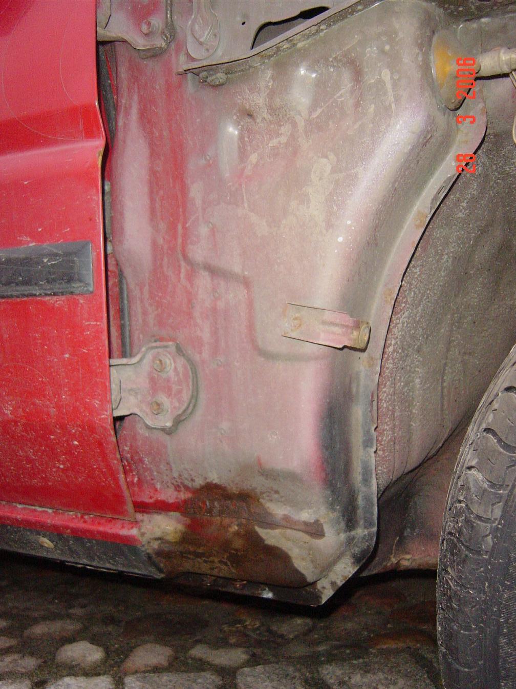

it's a '86 model, has 160k on the engine and chassi. The engine looks untouched(runs great), gearbox needs fixing(2 & 3 gear), some noise from the diff. everything else works. one corner light is missing,so is the left door panel and has funny pins on the hood(by the way it needs fixing too, cuz I think the holes for the pins where made with a screwdriver!) the previous owner did some work on it: indicator switch=made of heavy iron!, home made corner light, front & rear sus(front is damage now) and he also poured litres of silicone to seal the sunroof. The car had some minor body work done on the left side, which needs to be fixed. ...I think that's all yeah..no rear corner screen but thanks to dAYTONA, problem solved. here's some pics Philip |

Have you got a picture of the car before you pulled it apart??
If you dont, I have two ;-) taken BEFORE you bought it ;-) it has less rust behind the bumpers then i expected. Very niiiice. ![]() Always remember: Rev it till it blows, then back off a bit... Zenkis - Orange, Red/Black, Silver/Black, Maroon/Blue Koukis - Red, Silver/Gray, |
