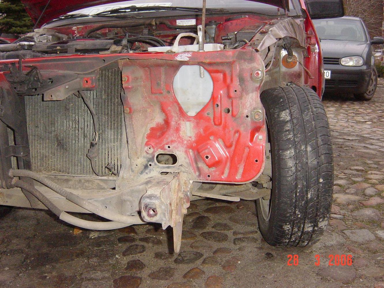

it looked like shit, but turned out be not so bad after all.
it's a '86 model, has 160k on the engine and chassi. The engine looks untouched(runs great), gearbox needs fixing(2 & 3 gear), some noise from the diff. everything else works. one corner light is missing,so is the left door panel and has funny pins on the hood(by the way it needs fixing too, cuz I think the holes for the pins where made with a screwdriver!)
the previous owner did some work on it: indicator switch=made of heavy iron!, home made corner light, front & rear sus(front is damage now) and he also poured litres of silicone to seal the sunroof.
The car had some minor body work done on the left side, which needs to be fixed.
...I think that's all
yeah..no rear corner screen but thanks to dAYTONA, problem solved.
here's some pics

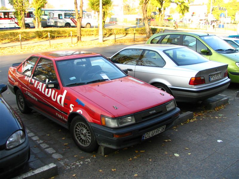

Have you got a picture of the car before you pulled it apart??
If you dont, I have two ;-) taken BEFORE you bought it ;-)
it has less rust behind the bumpers then i expected. Very niiiice.

This is his car when my friend spotted it before cannabolic bought it...
[Image: AEU86 AE86 - cannabolics hachi...]

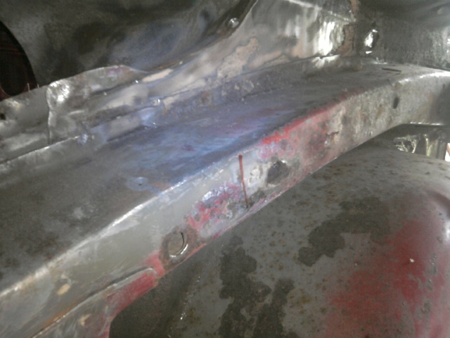

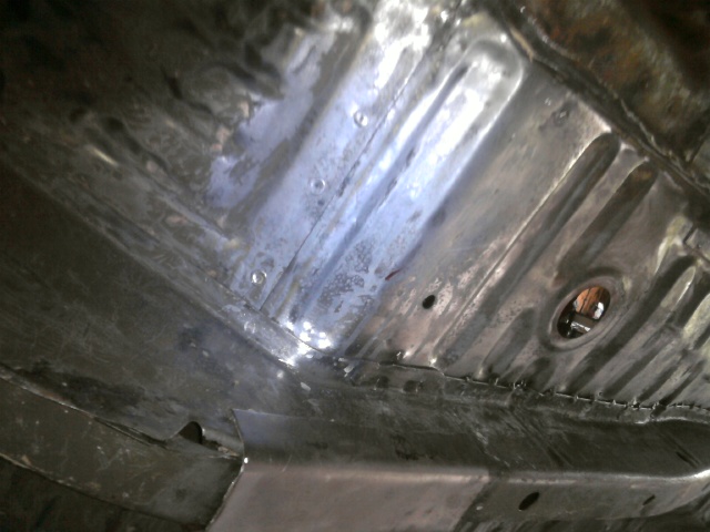

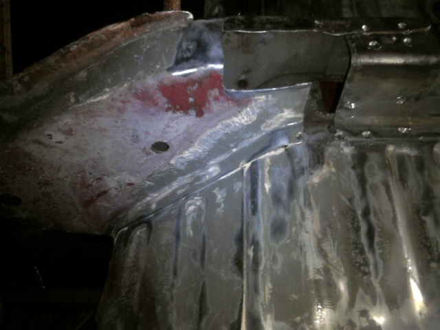

I've totally striped it and put it on a jig. Started to spot weld and fixing the rusty bits. waiting for U-Pol's weld 2 primer to be delivered and will weld those reinforcement in.

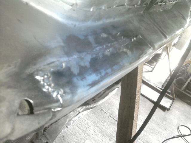

I've pick up pol's Weld 2 (weld through primer) which suppose to be one of the best Thumbs up!
Firstly, I cleaned and sprayed some phosphoric acid where I could.
Wiped the acid and painted two layers of Weld 2. Welded the first reinforcement
Then some more cleaning and on with the primer again.
...and the next reinforcement
I know, I need some welding practise Big Grin
Hopefully will get better later on Thumbs up!
Position while welding is the key thing...
Got to learn somehow :wink:
