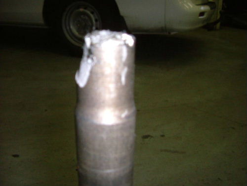

last year this happened 2 times with my rear axles Banging head
is this an material problem or can i get stronger axels
this happened while drifting at high speed and the engine has only 130 wheel hp and now i have a blacktop in my ae86 and this engine has more power Confused
anyone ever has this kind of axle problems????? Dumb question
[Image: AEU86 AE86 - axle problem,anyone????]

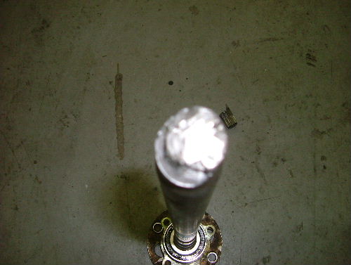

ouch Huh are thise zenki or kouki axels ?

Seen this before, on a car fitted with paddle type clutch.
Can also happen when changing down gears, too fast off the clutch when there is plenty of grip.... :wink:

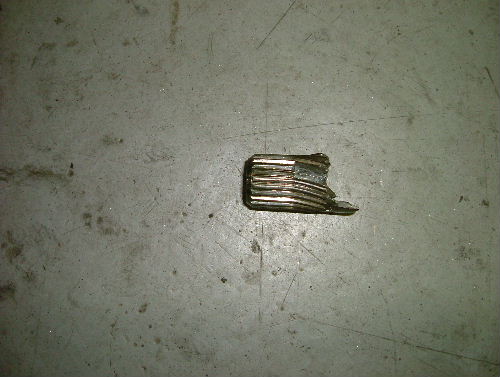

its a driftcar so to mutch grip isen't the problem i think
BUT i do have a "paddle type" clutch we call it sinterbrons overhere or 4 puck,but yes it dont have the springs in the middle
(and i use the clutch A LOT, i dont have a e-brake in my car.... Smile )

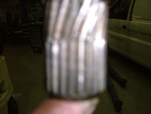

Jasper, give a call to arnout at supras.nl, he probably can source you a Supra mark II rear axle hopefully for a decent price. That should be able to take a little more beating.
02-04-2006, 12:35 PM
OMG! Huh
