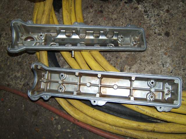

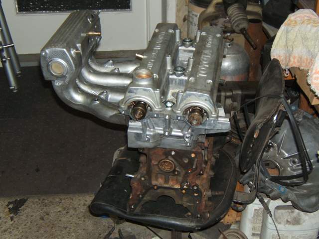

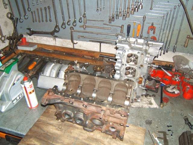

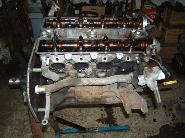

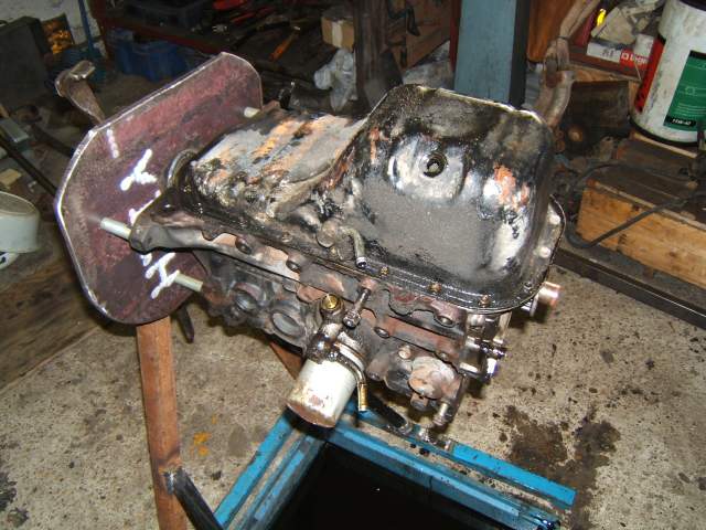

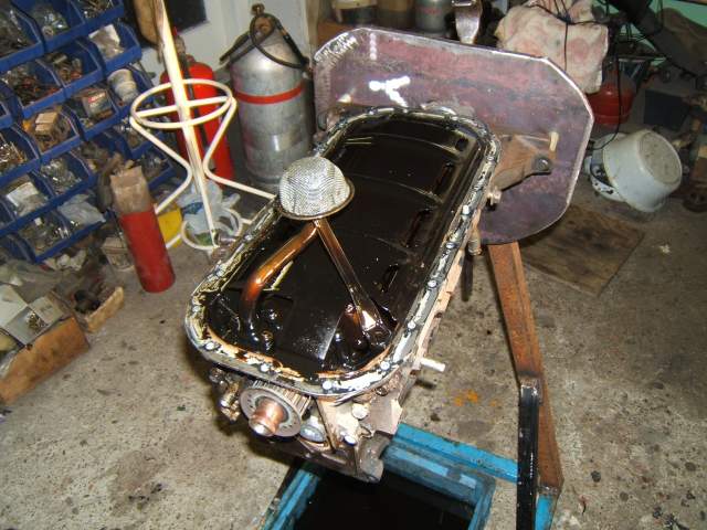

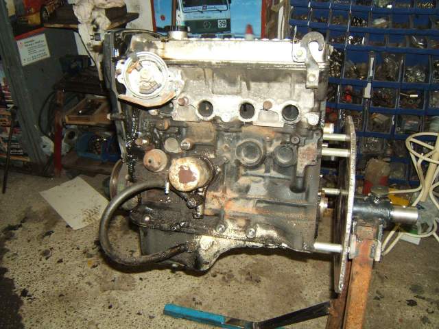

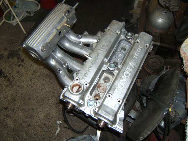

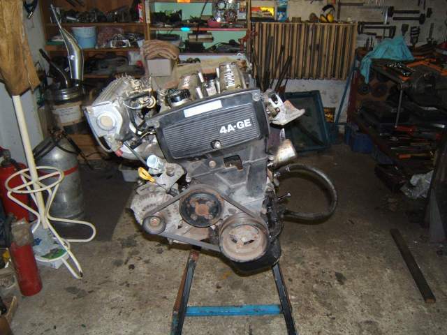

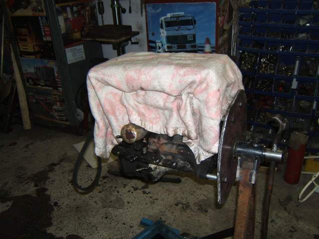

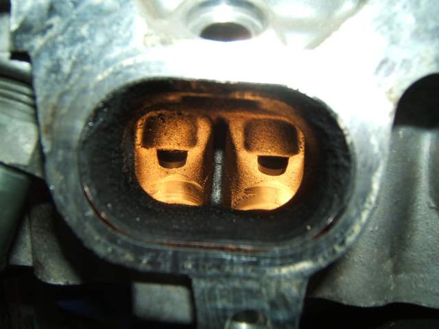

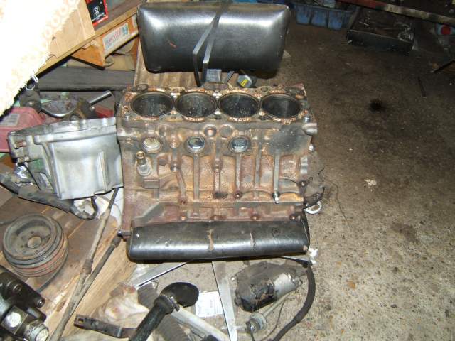

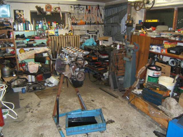

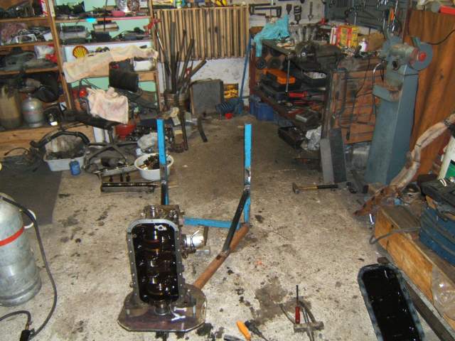

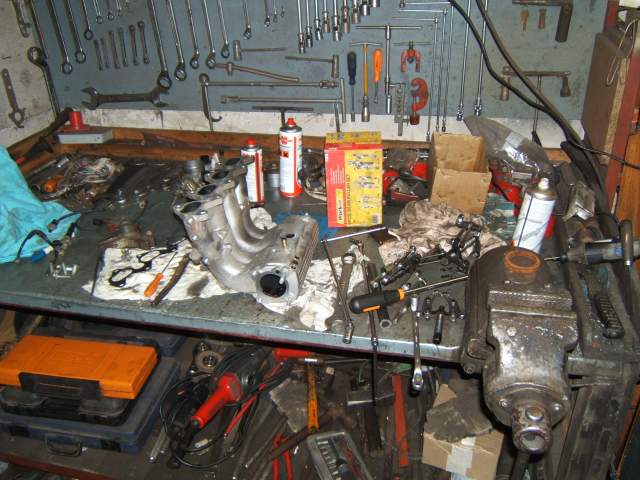

I took a look around my workshop. found some metal parts and welded an engine stand of them

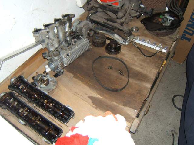

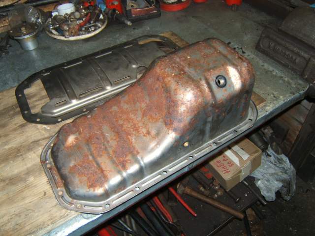

![]() ![]() and then I started to part the engine (4.2.2006) The intake manifold also had the coal-tar?/coat: ![]() ![]() ![]() ![]() ![]() ![]()

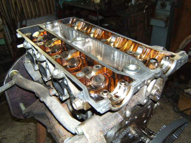

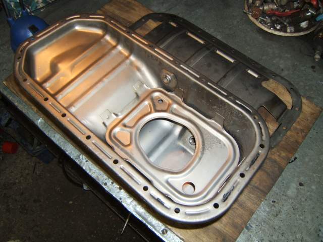

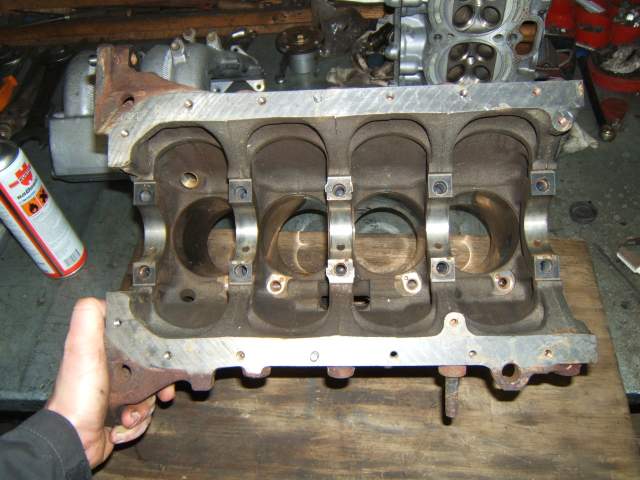

5.2.2005

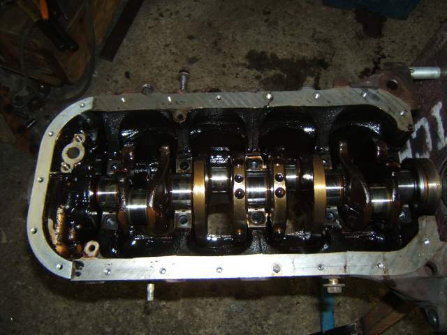

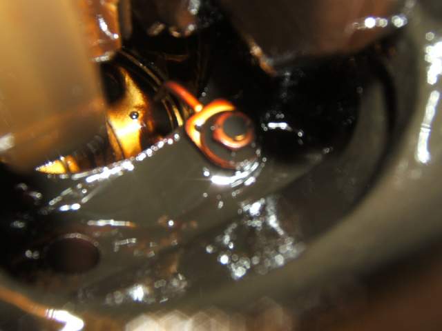

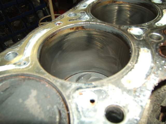

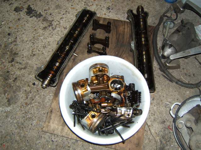

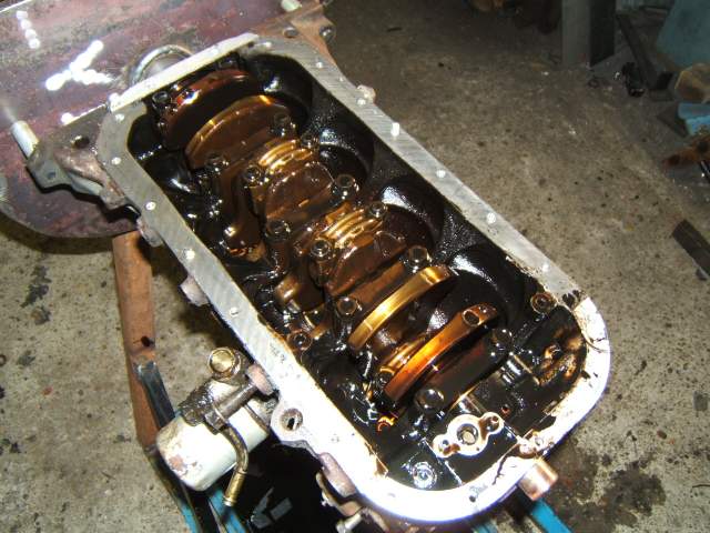

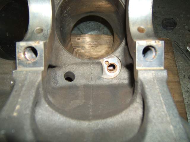

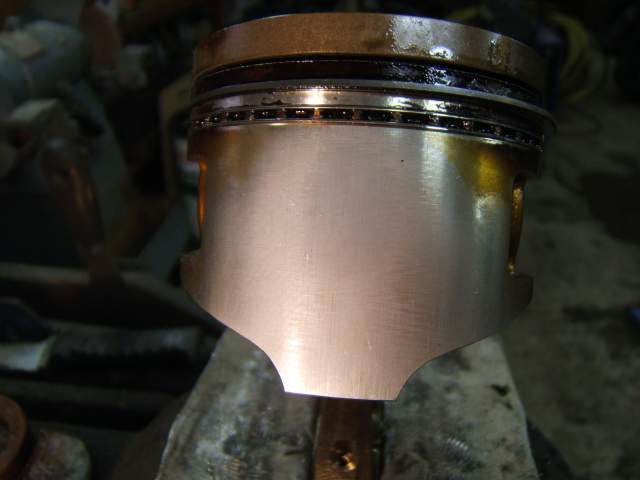

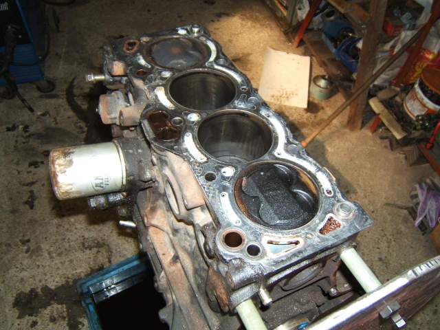

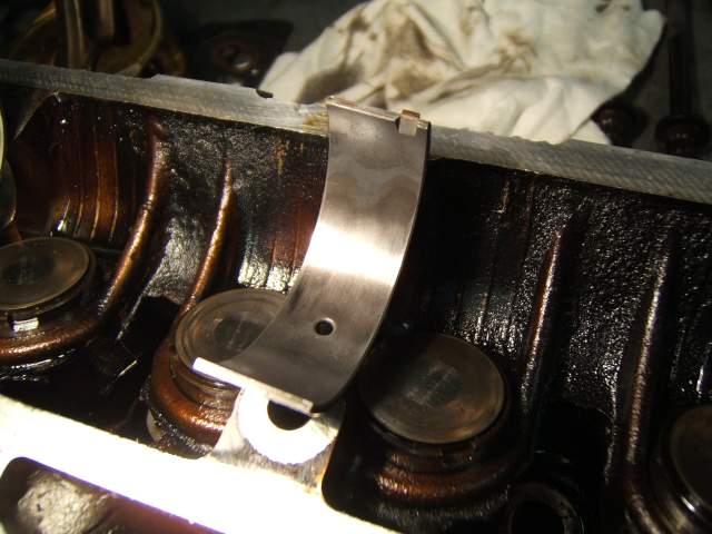

![]() ![]() ![]() ![]() ![]() ![]() ![]() oil squirter ![]() Piston and cylinder seemt good at this point I didn't know why had compression lost from the engine ![]() But the conrod bearings were worn.

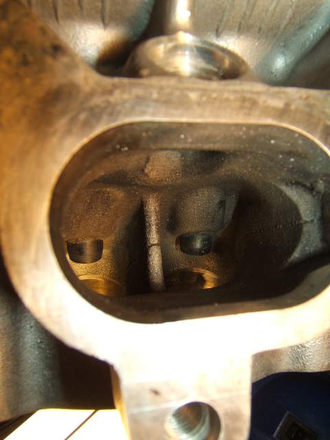

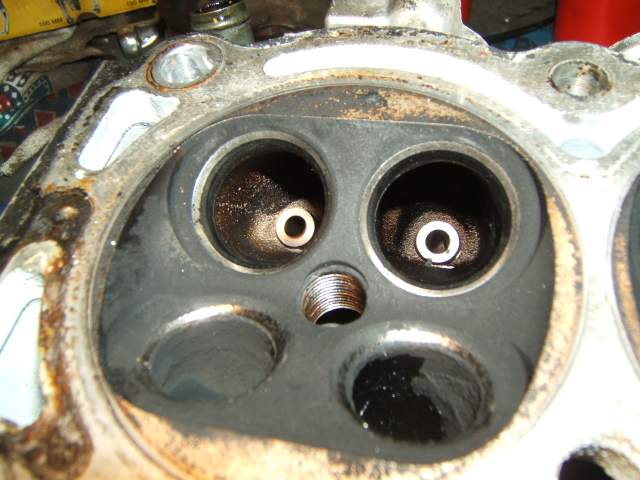

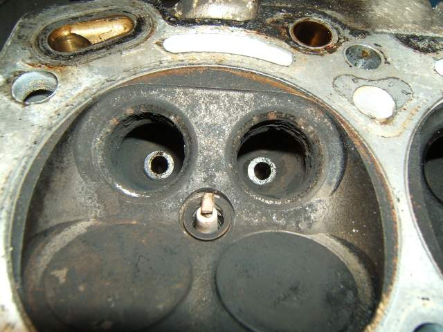

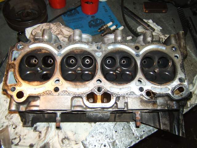

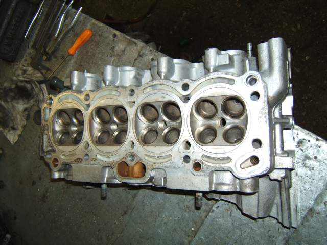

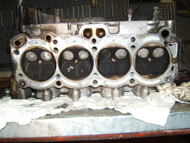

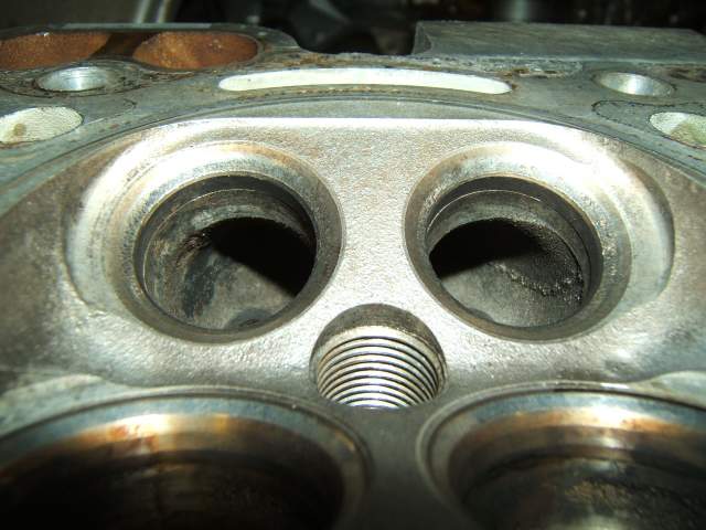

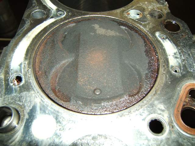

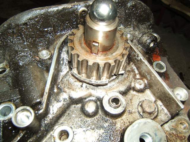

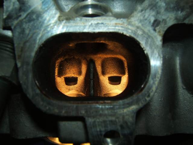

![]() ![]() ![]() Maybe this was the problem with the compression: ![]() Some coal was on the exhaust valve seats. But on all of the 8 valves so I don't know why just the cyl 2-3 had comp loss... :roll: ![]() ![]() ![]() ![]() ![]() I had a big trouble with the crank timing pulley, I wasn't able to pull it down. ![]() Finally I drilled a hole and broke it down...

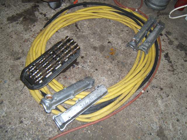

I've sent the main parts to hot leaching/lixiviation bath
results were ![]() ![]() ![]() ![]() ![]() ![]() ![]() ![]() ![]() ![]() ![]() ![]() ![]() ![]()

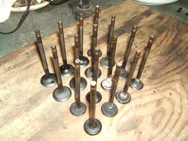

The exhaust valves had some kind of coat. It was very hard on the valves I tried some kind of chemicals but no one made anyting. finally I removed them with Flex (angle grinder?) and steel brush...

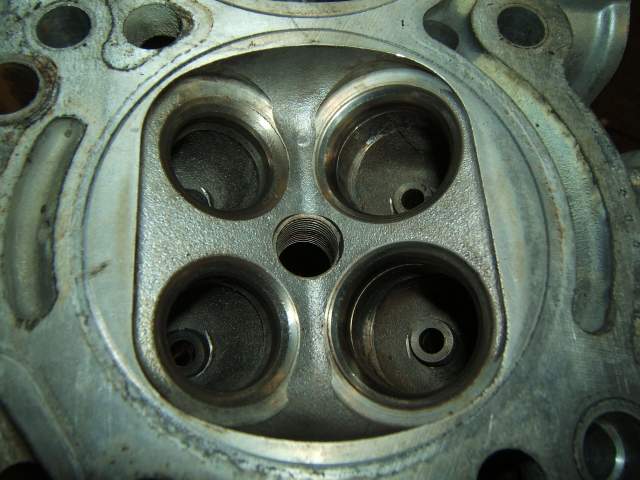

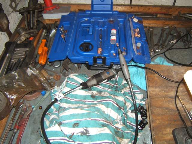

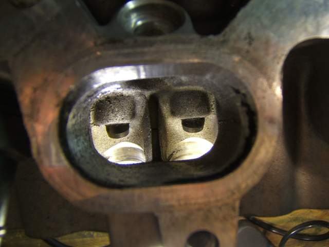

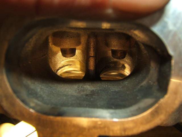

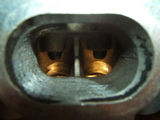

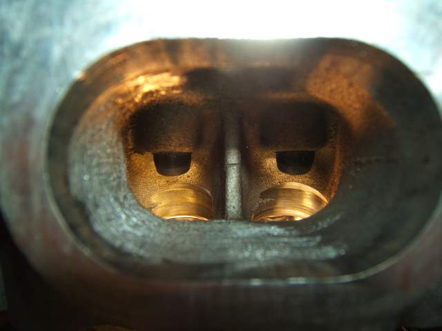

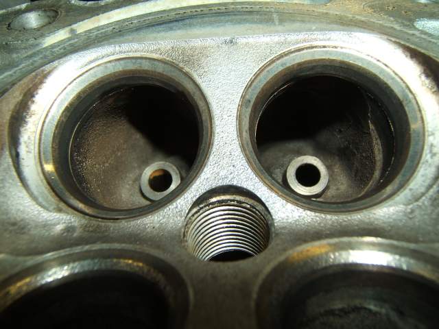

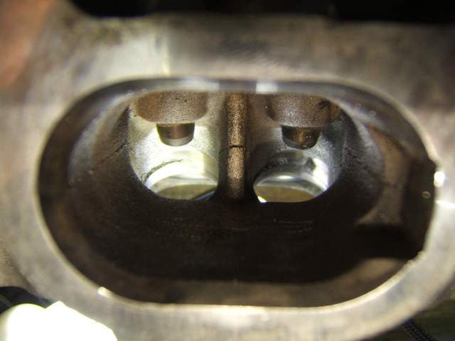

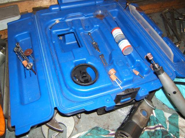

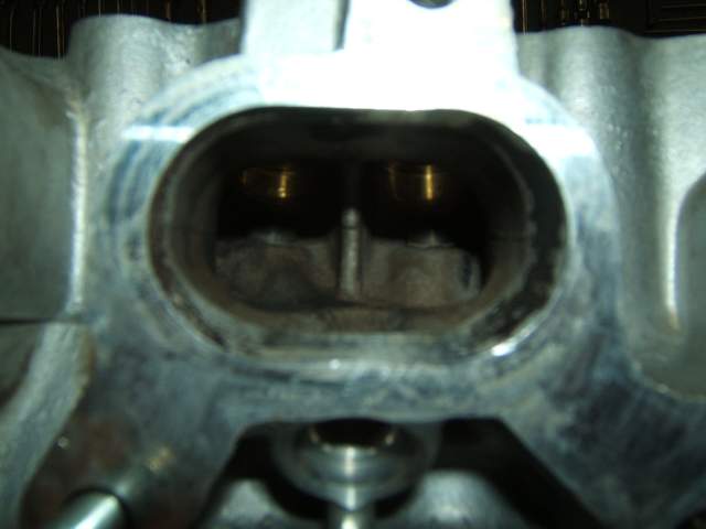

![]() So here I started some head porting. I just wanted to remove the big materials that 100% not needed and are in the way of the air. Nothing serious... The "tools" ![]() ![]() The base again on the intake side: ![]() ![]() ![]() First steps: ![]() ![]()

![]() second step ![]() ![]() from the combustion chamber side: ![]() ![]() ![]() ![]() ![]() ![]()
