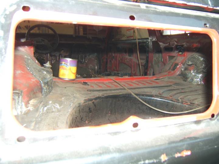

13.02.2006 at the body workshop:
![]() ![]() ![]() ![]() ![]() ![]() ![]() ![]() ![]() I tried to use the AE92 GTi front seats but they were too high. I was able to look out on the sunroof ![]()

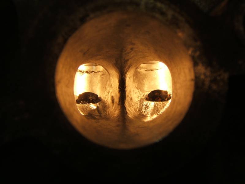

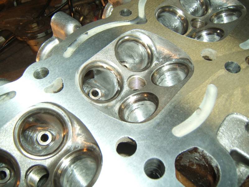

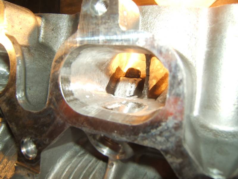

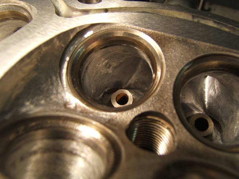

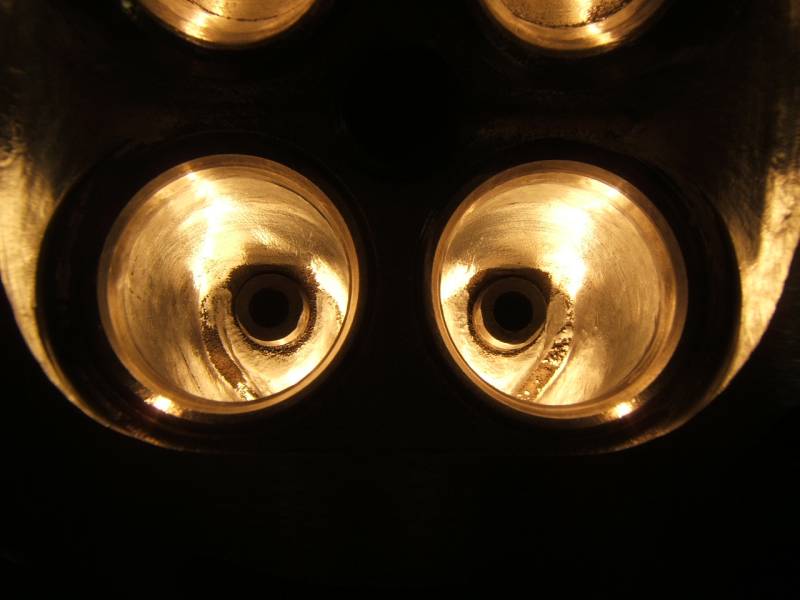

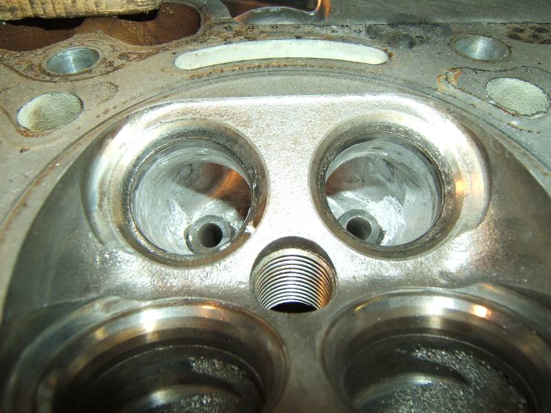

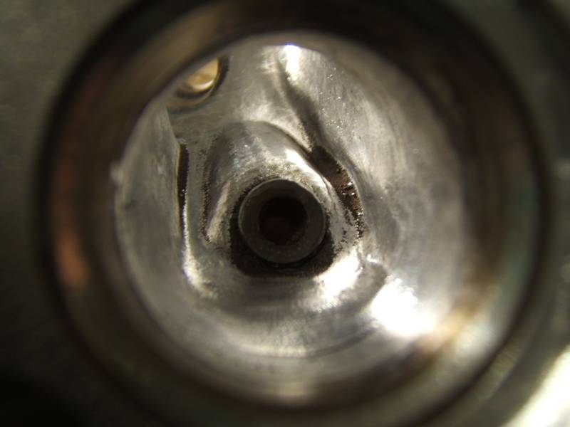

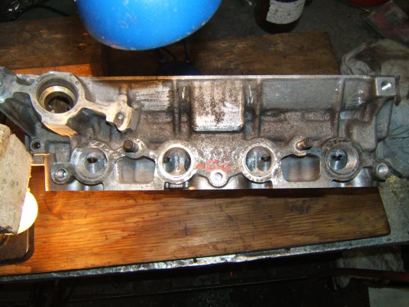

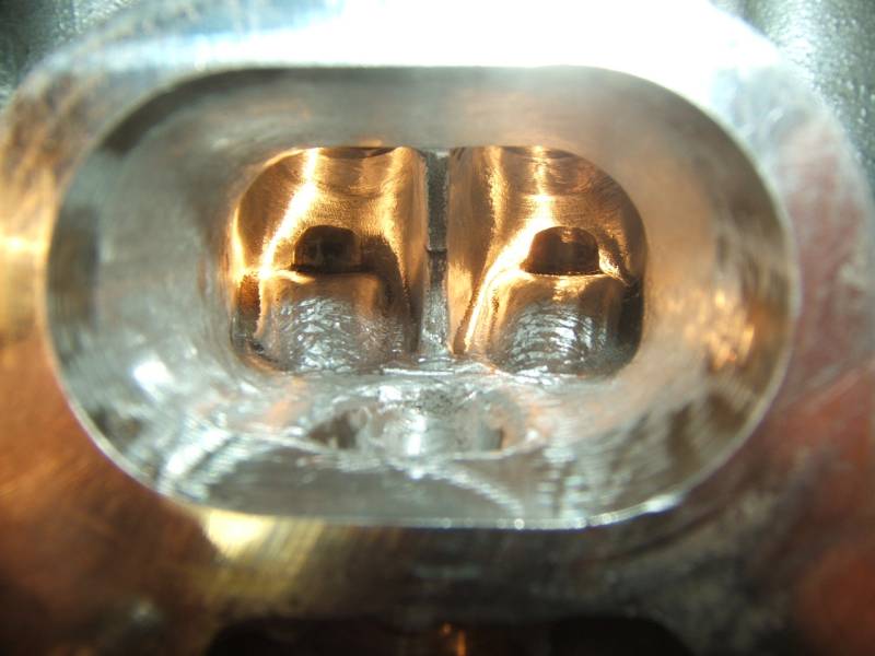

last taken pictures of the cyl head without valves (but it's not ready!)
![]() ![]() ![]() ![]() ![]() ![]() ![]() ![]() ![]() ![]() Sorry nowadays I don't have time to post here, but when the christmas comes I hope I'll have more... |

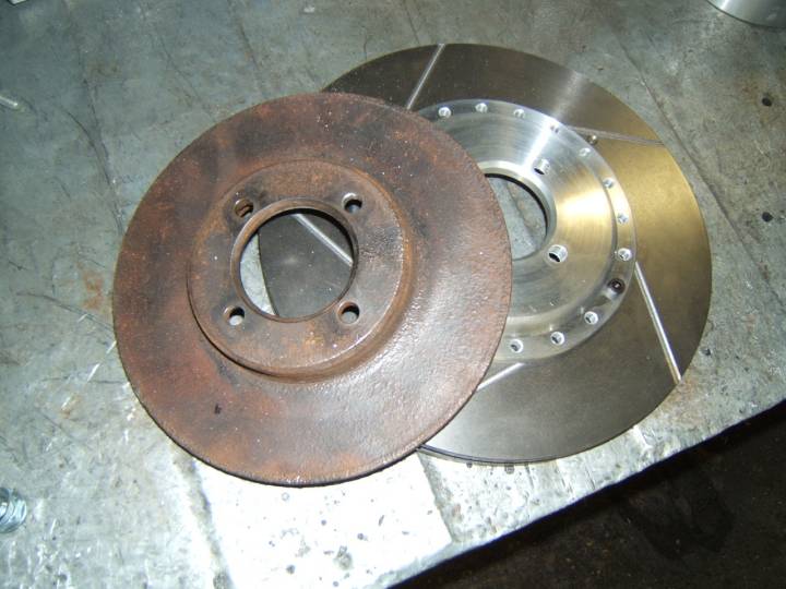

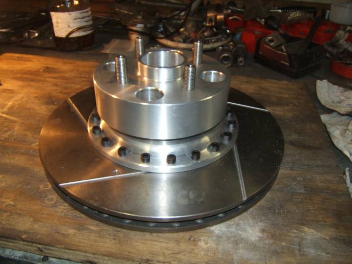

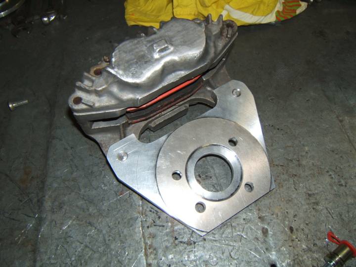

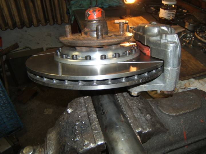

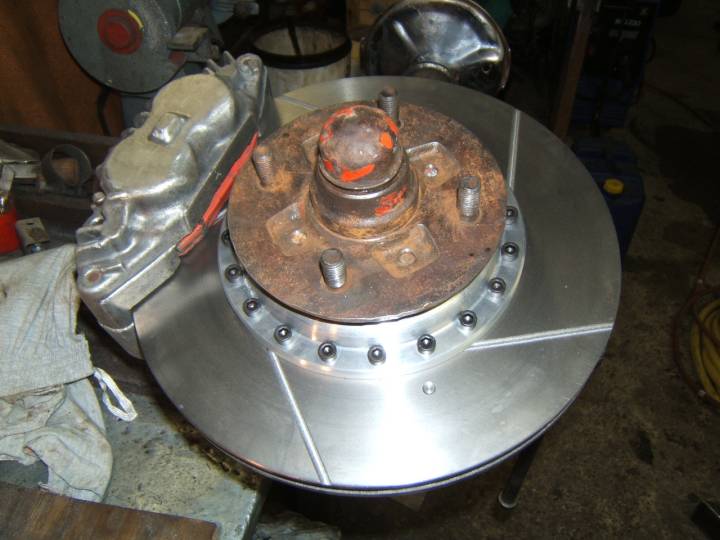

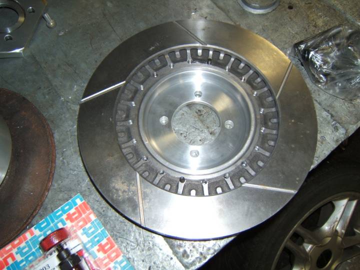

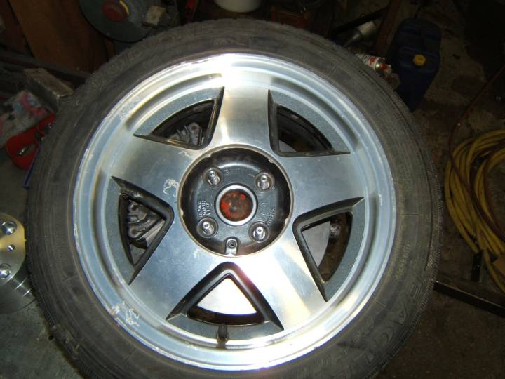

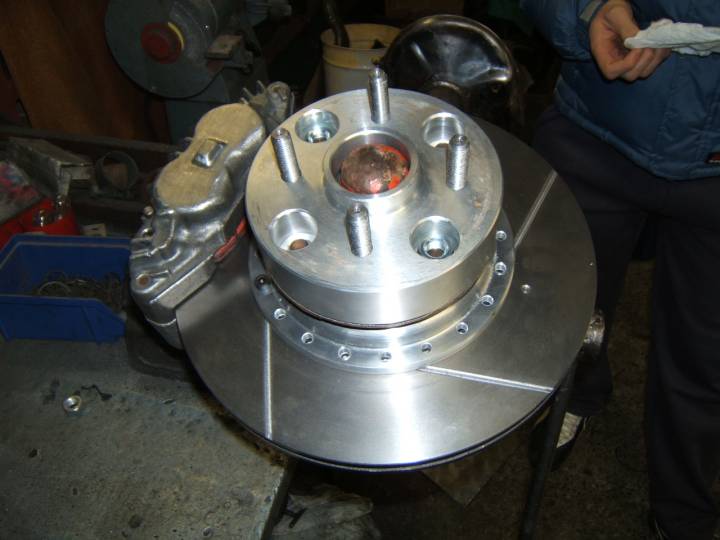

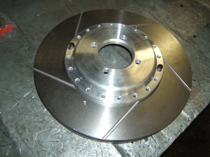

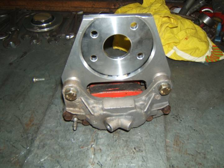

On 17. 02. 2006 I got the big brake parts from the machine shop.

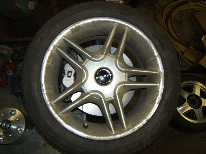

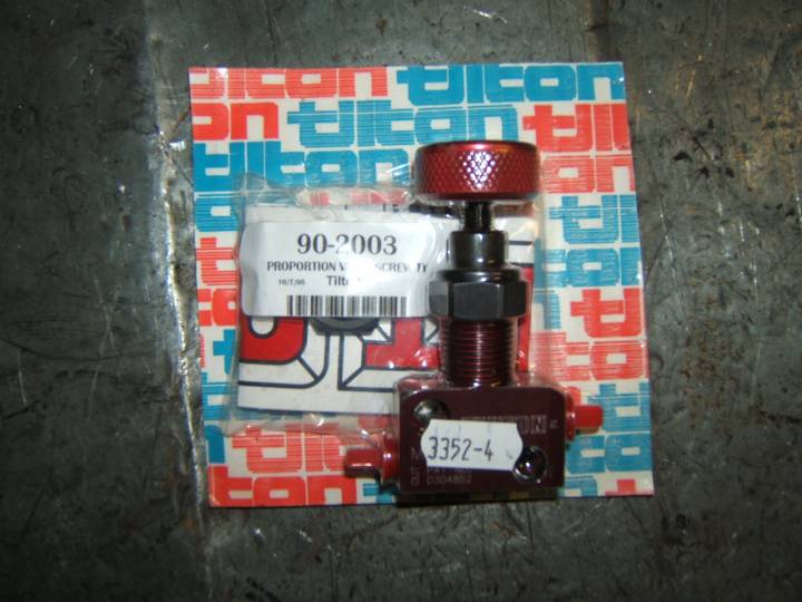

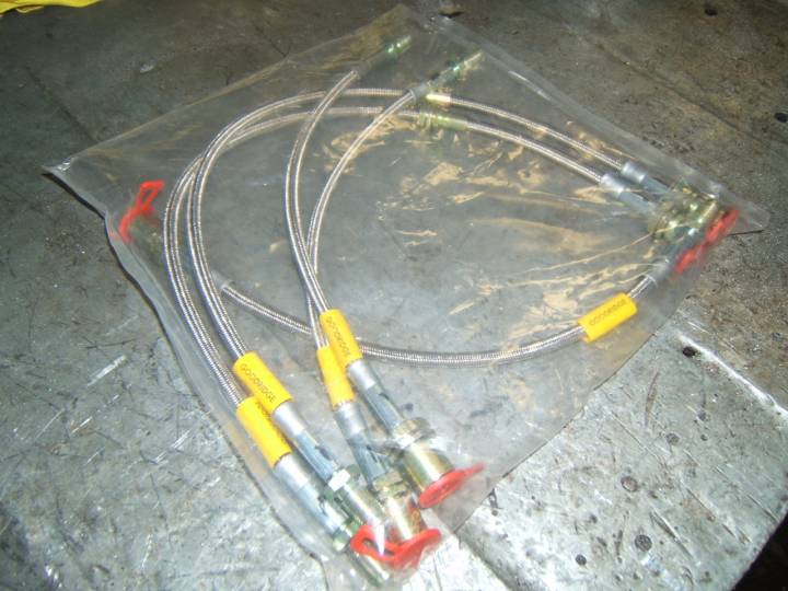

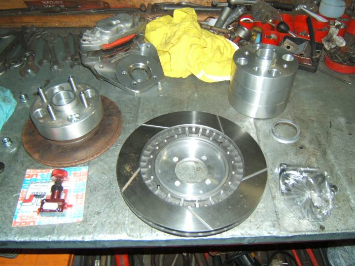

![]() ![]() ![]() The disc is from a BMW 5 series, the diameter is 296mm and 22mm thick. The aluminium things are from the Alcan the material is Certal. ![]() ![]() I bought a set of Goodridge braided brake lines and a Tilton brake ?balancer? ![]() ![]() The wheel spacers are 40mm wide and has a PCD 4*100 ![]() ![]() ![]() Check them on 15 inch wheels. just fit, 4-5mm from the caliper to the wheel ![]()

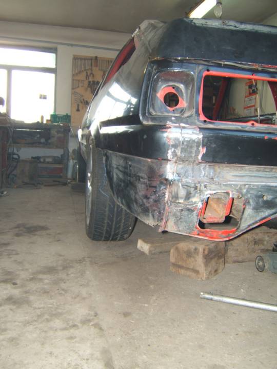

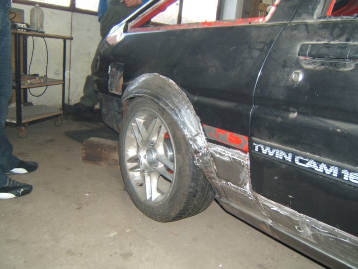

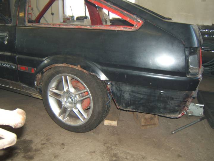

18.02.2006 at the bodyworkshop

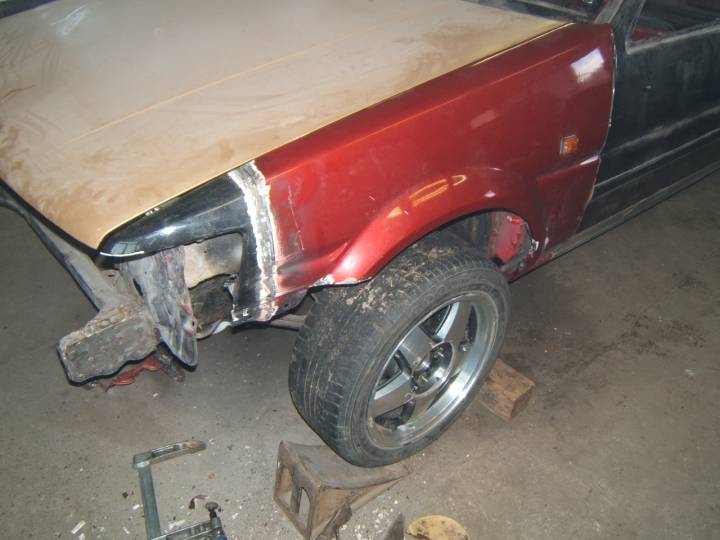

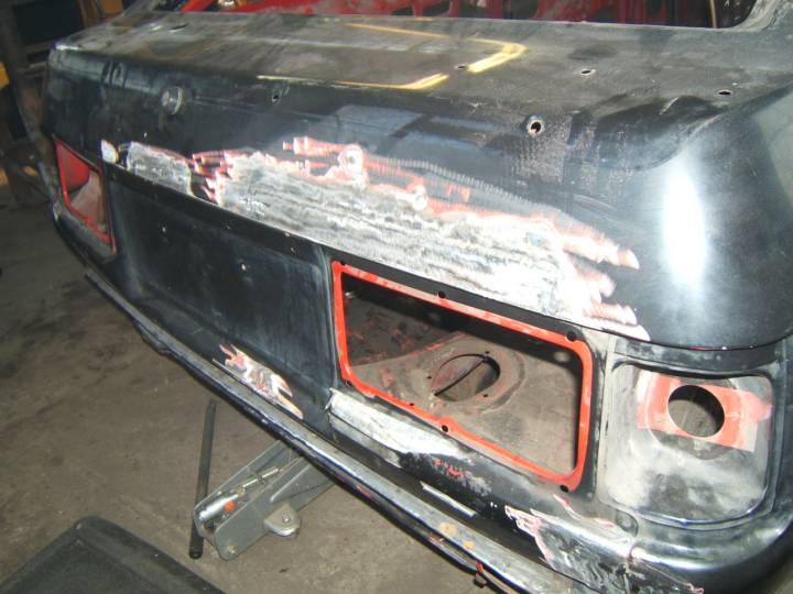

I got zenki fenders but it turned out that they were damaged once so we had to use a part from the original one ![]() check if the wheels has space with the 40mm spacers (ET-5) ![]() ![]() ![]() ![]() Another try for a rear arch, but this is also not the final one

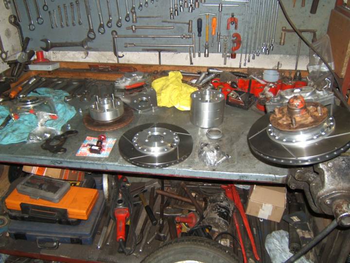

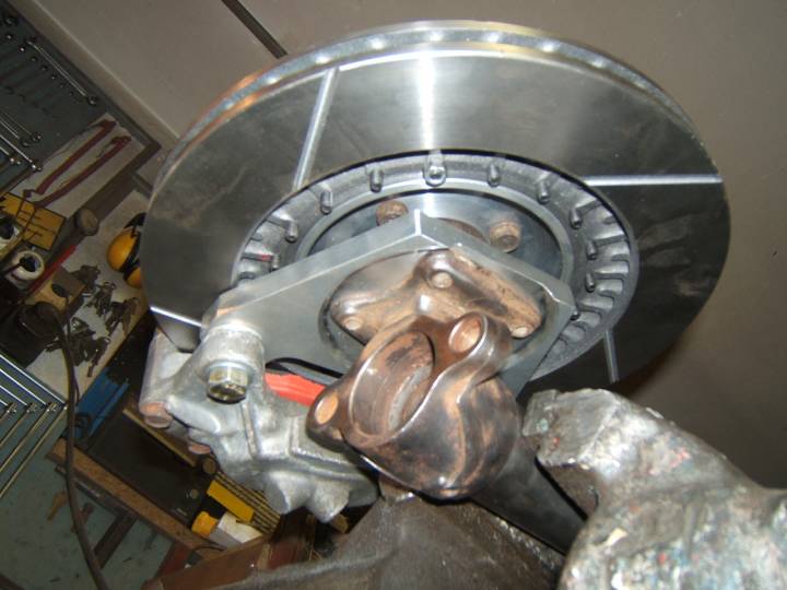

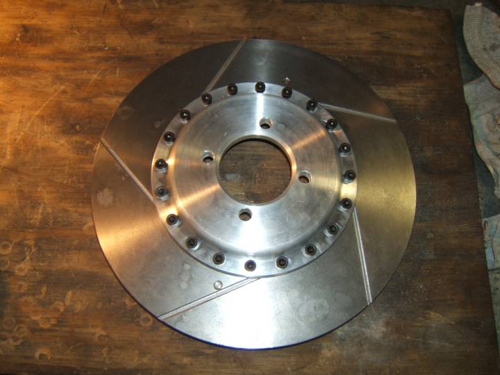

21.02.2006
New pics of the big brake ![]() ![]() ![]() ![]()
