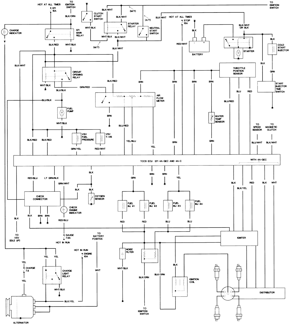

Joel here are some diagramms i think will help you :wink:

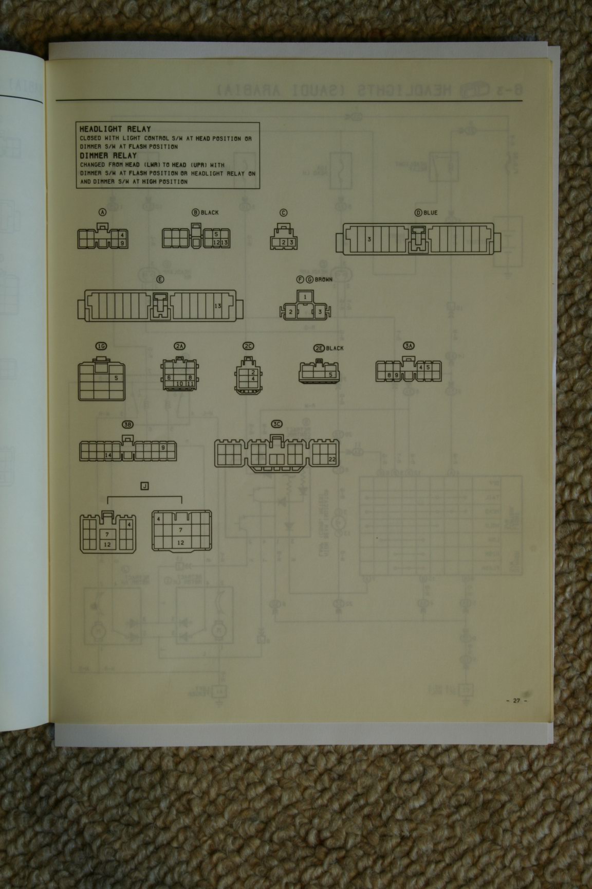

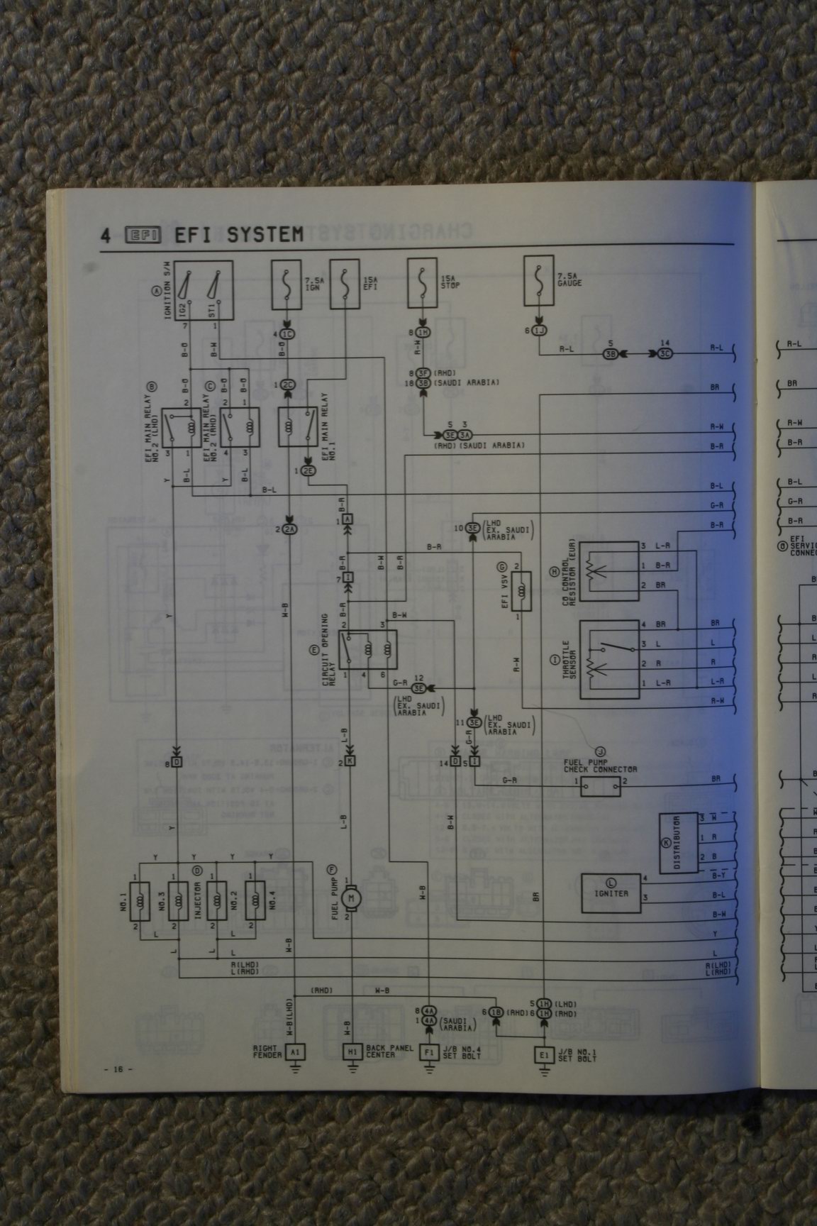

Okay. I've currently got the EFI system and the wiring routing, so roughly that's about 25 pages...
However they say nothing about color coding. Confused
