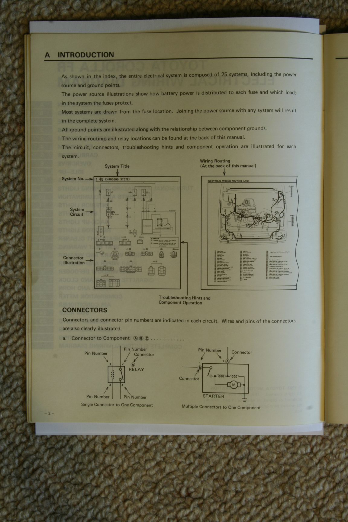

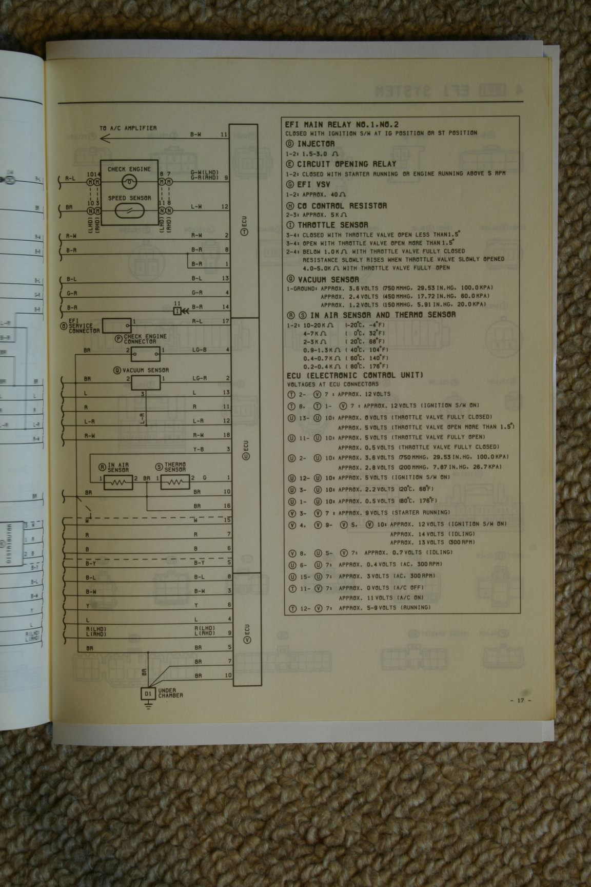

Okay. I've currently got the EFI system and the wiring routing, so roughly that's about 25 pages...
However they say nothing about color coding. Confused
[Image: AEU86 AE86 - Wiring Diagrams]

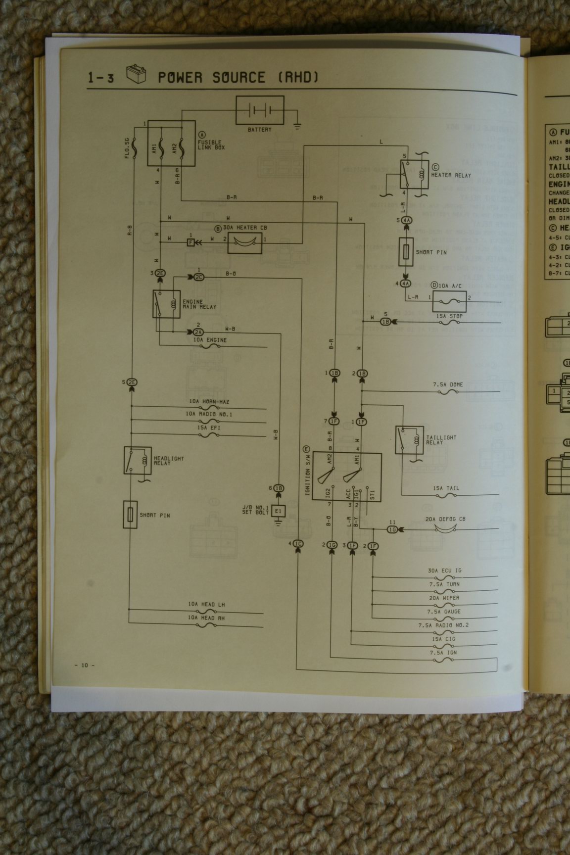

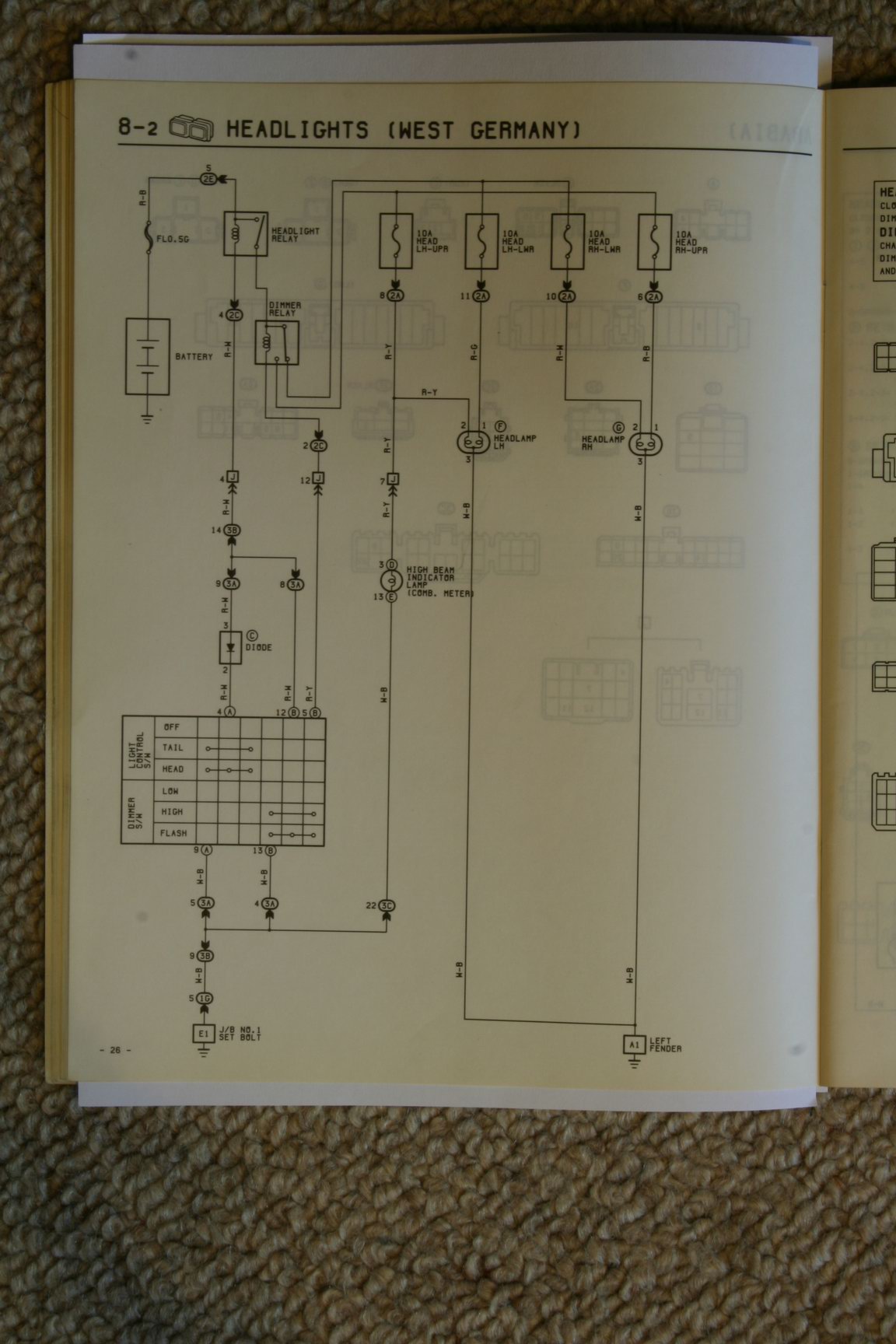

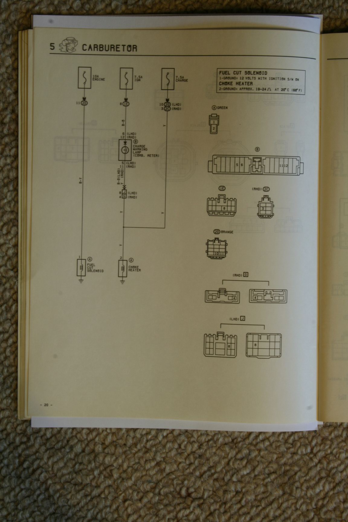

Wiring Diagrams

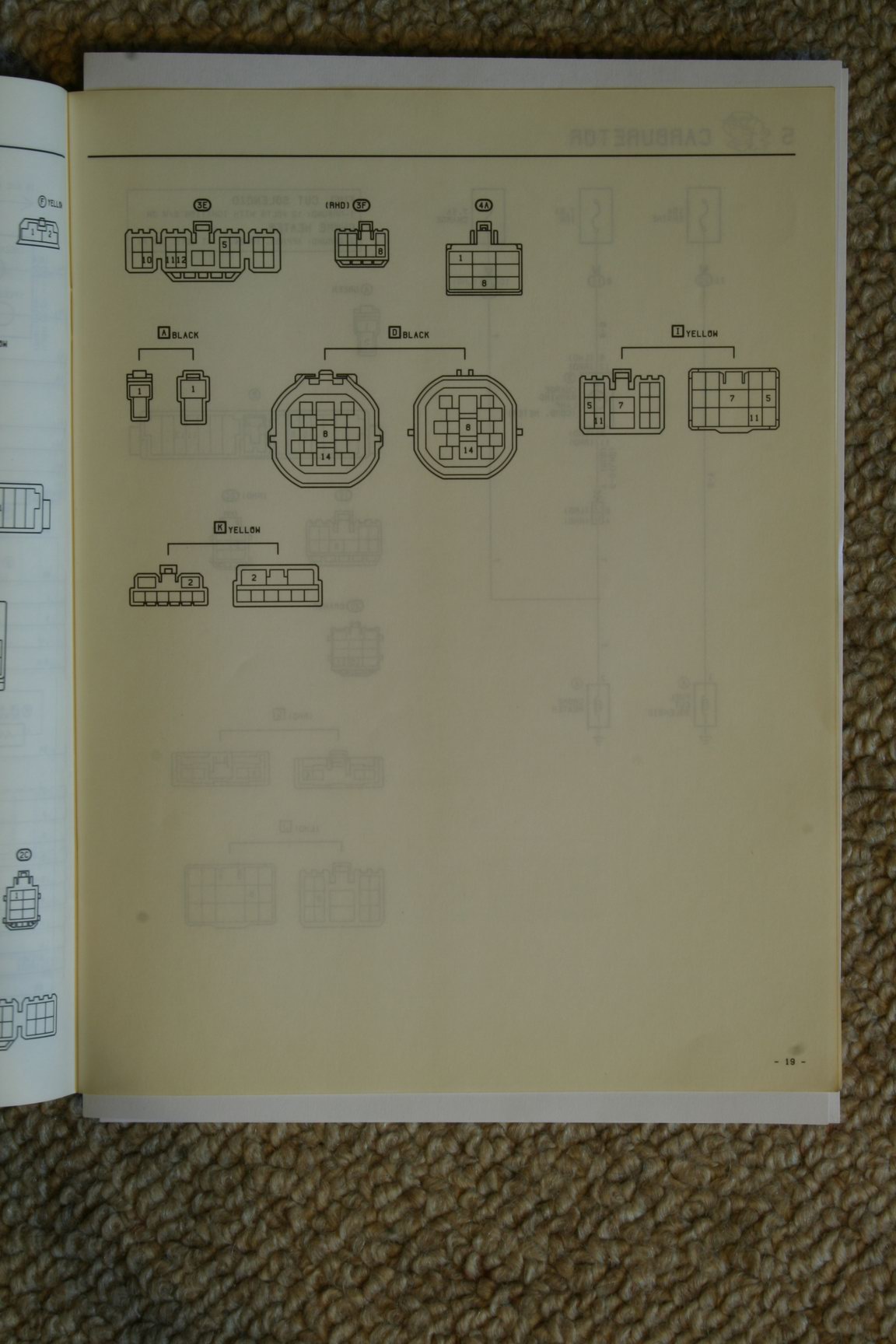

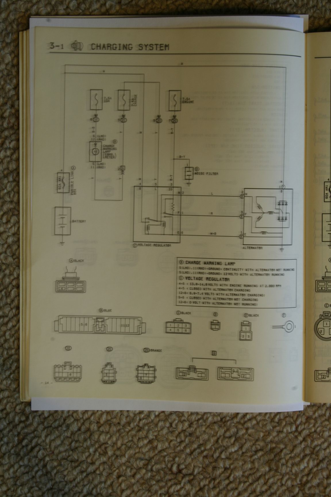

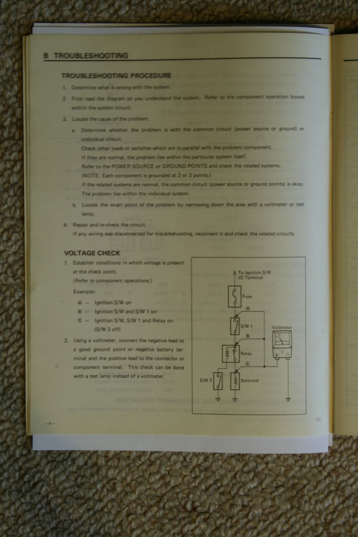

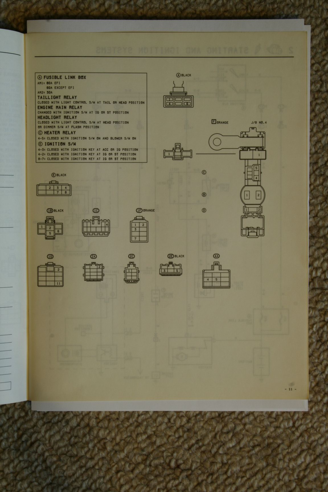

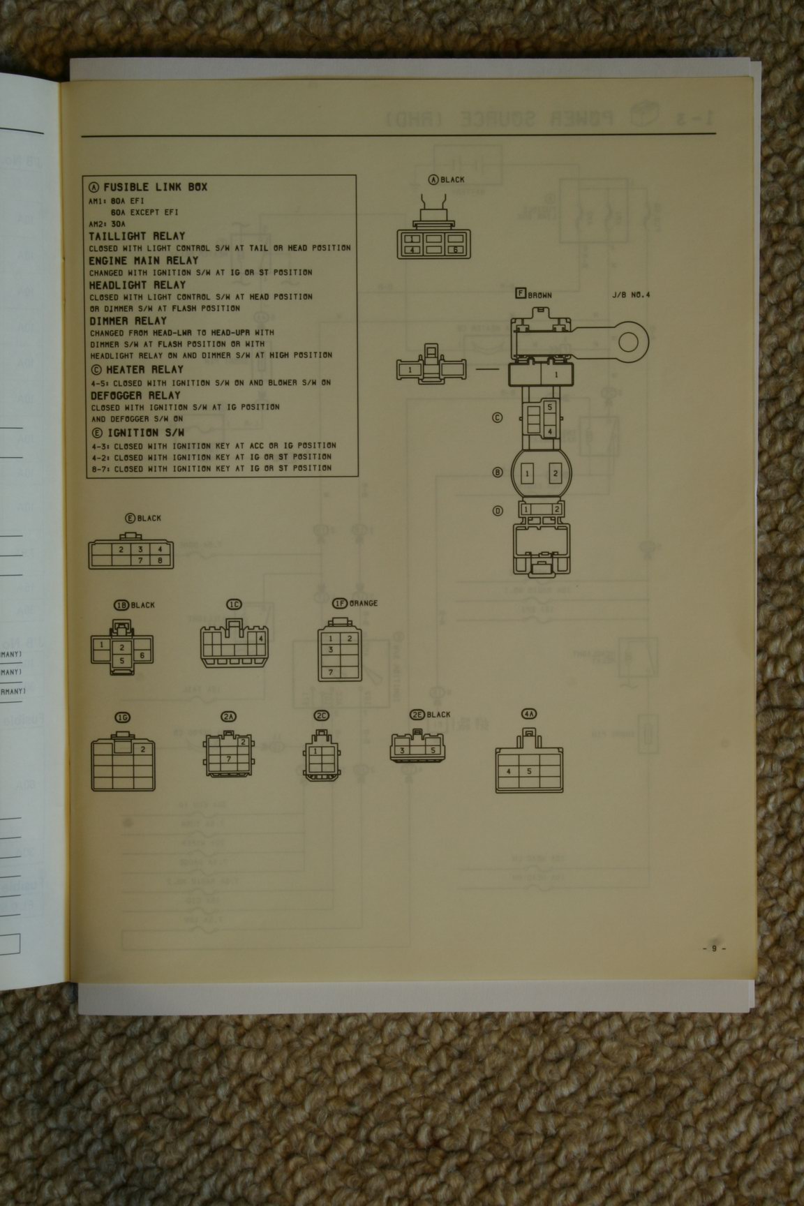

I'll post them tonight then. Smile
Edit: here they are. Hurray!
