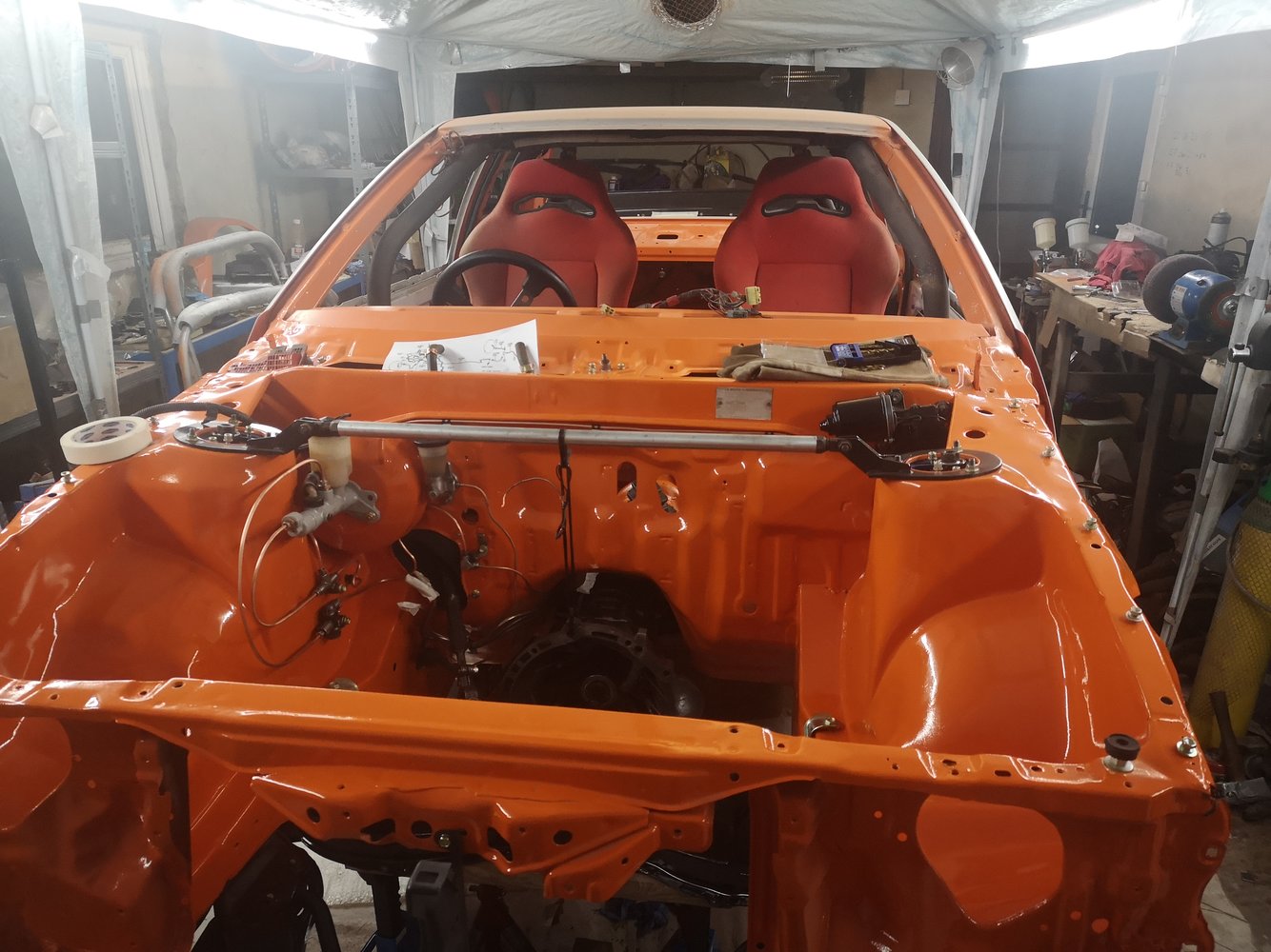

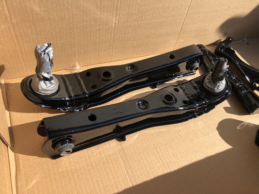

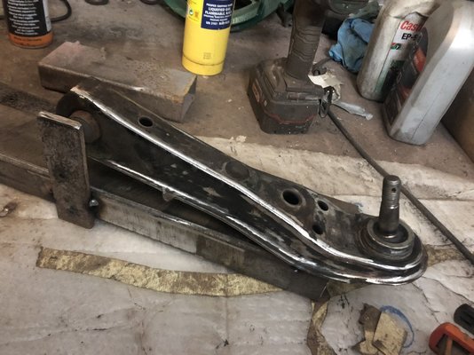

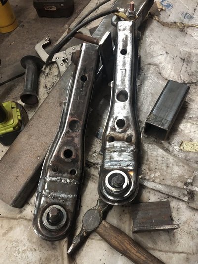

@Bean like this?
[Image: AEU86 AE86 - Wide Track 86]
...I wish I'd known more about wheels before I bought the 16x8 et20 and 16x9 et0 set, not ideal but I like how they look. Having added 25mm to the lower control arms, if I push the camber plates out fully I'm left with a small amount of negative camber. The positive offset means I need 5mm minimum spacers to allow the to clear the struts, if I don't set the coilovers too low
