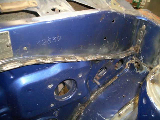

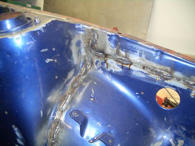

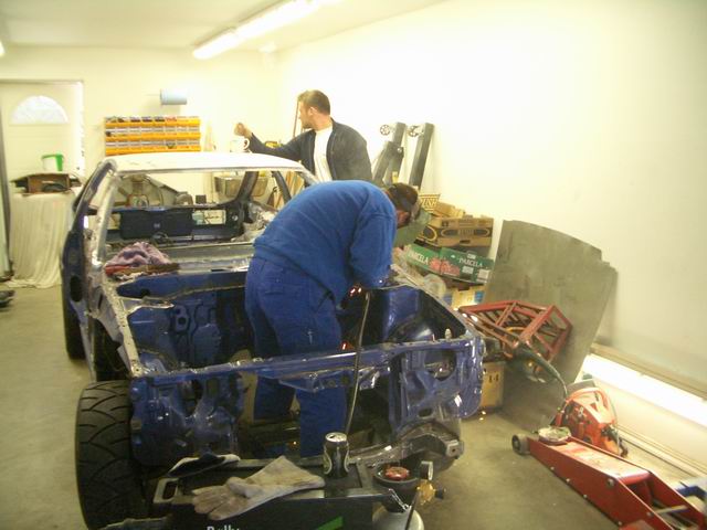

Ok, guys...talked to a previous Hachi rally driver today, and he recommended doing 2-3cm seam welds, with a gap between them of apprx the same length. Had a pro. welder do it for me, and i´d say it turned out pretty well. He´s not quite finished yet, but you get the idea from the photo´s.
But thank for all the inputs so far Thumbs up!
Keep in mind, that this wont be anyway near a TRD project and is to be used as a daily driver during summer, so i may miss or skip a few of the regular welding spots, but i guess i wont feel the difference anyway.

02-25-2005, 06:57 PM
Post: #38
Wonderfull job man!

Man it hurts to hear the red/black one is going to become a parts car.
Did you also weld around the top of the strut tower?
You might as well weld all the simple stuff while you can instead of putting in reinforcements later. For instance putting in some triangular reinforcements shouldnt be to difficult and expensive and will earn you some extra bragging rights Wink.
Also all the seams around the doors, windows and hatch are also pretty easy to do while the car is apart. Just drill holes through the top layer of metal so the underlying layer of the seam is exposed and weld those holes shut.
