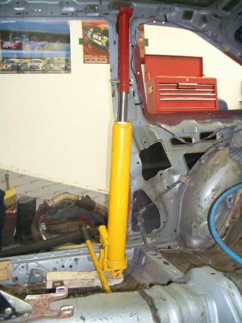

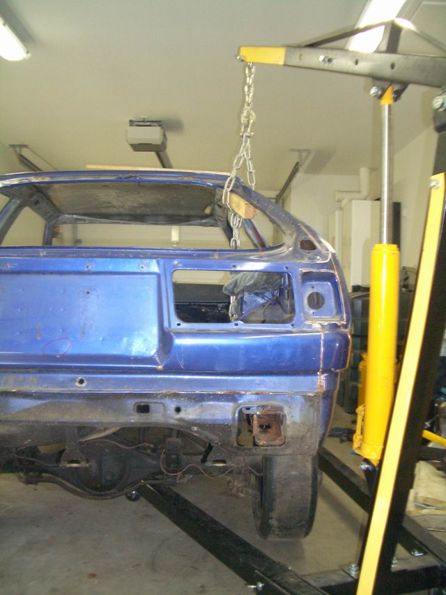

Ok, used 8 hours today on preparing the car for paint. Turns out that we couldnt fit the rear hatch, and spent better part of an hour to try and adjust. We then did a shitload of measuring, and it turned the roof has been damaged during the roll-over. Actually it was the "beams" that were out of shape, so after a couple of hours of fun in the sun trying to bend everything back into shape, i would say that we are in the clear. Everything fits perfectly now and the roof looks to be where it´s supposed to be, and the cross measurements confirm that impression.
Have a look at the pictures to see how we managed to succed with different tools and some lively imagination.
