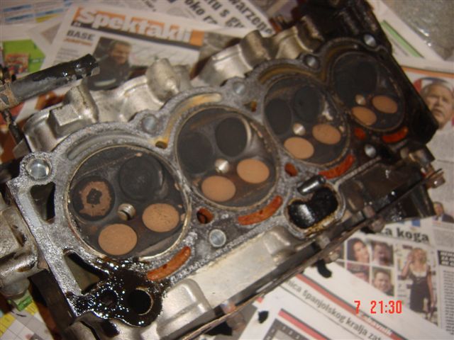

04-19-2007, 02:00 PM
Spark plugs oily?
The engine was running normaly like this ..
Is it smoking on the exhaust ?
I hope it isn't your case like this.

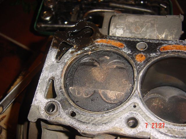

04-19-2007, 06:38 PM
Spark plugs oily?
Is this damaged gasket?
The engine should have new bottom end... gasket could be the problem. Did you have similar problems meshin?
I havent been drifting with it, is has only 130km and has not seen yet more that 4000rpm... But I can also imagine that if a piston ring is damaged or the gasket is damaged, more oil will go in the combustion chamber trough this ventilation and will oil the spark plugs too.

04-19-2007, 07:58 PM
Spark plugs oily?
El_Camino Wrote:The engine should have new bottom end... gasket could be the problem. Did you have similar problems meshin ?
Myself no... but here in Cro, yes.
Check the coolant water for oil, check for smoke on exhaust and colore of the smoke.. and it could be gasket just like on the pictures, only 1st cilinder.
