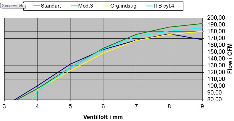

09-18-2015, 05:05 AM
OST-034: Noir Crowning
Can it really be the true that a stock head flow less @ 9mm than 8mm?
09-18-2015, 09:05 AM
highly unlikely, usually they just plateau i.e. no more useful gains. If you search google for flowbench and 4age you should come across a few other measurements incl. some from Orion (unfortuantely the original uploads aren't accessible anymore)
