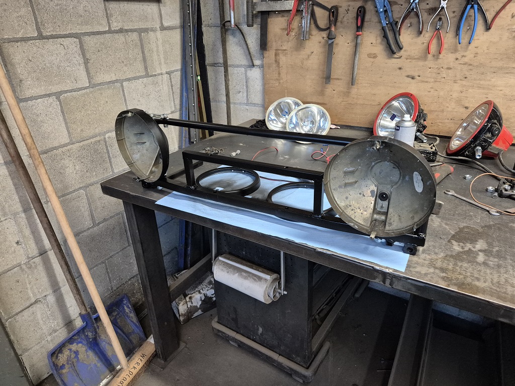

So did some work to the cars last month. Very busy so not a lot of time left. But I've signed up for a regularity at night for the end of this month (basically finding the correct road as designed by the organizers on an old fashioned paper map) so I have to add lights to the car (and it looks cool Cool)
The green car already came with a light bar when I bought it. I've never fitted it, so I took it it out storage.
[Image: AEU86 AE86 - Koen's 86 - every drive a new issue]
The brackets are there which saves a lot of time. And it probably gives a lot of light, but it's not very pretty in my opinion Crying

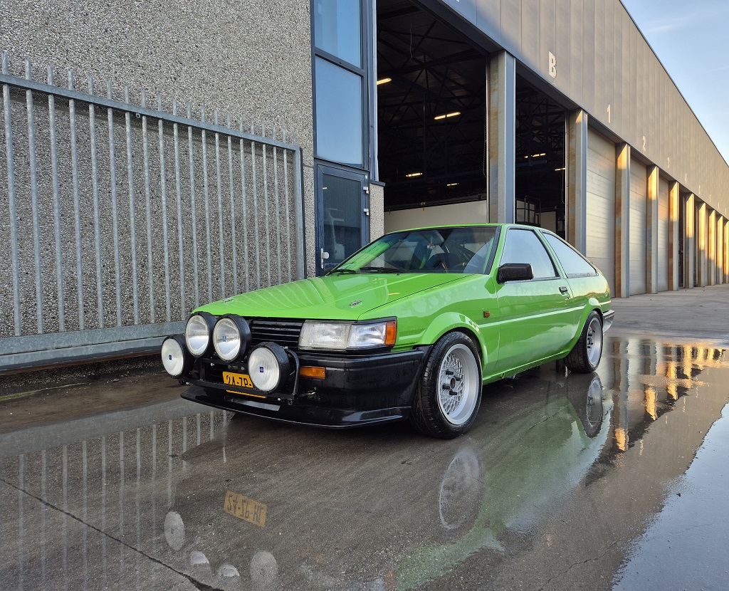

So did some modifying.
Some painting, added an extra "level", new wiring and installed fog's from marktplaats instead of two spotlights (also makes it 4x Hella 2000's)
And now it looks like this Smile
A lot better I think Smile of course it involved some changes to the loom to make everything switchable with the high-beam and it gave me the opportunity to install the interior lights which is quite handy at night. Everything works Smile Also switched to the Rial Mesh wheels because the Longchamps don't match with the lights Tongue but for some reason these need 25mm spacers (instead of 15mm) to clear the brakes which makes them rub. I guess I have to find some with a higher offset or change them again.

Yeah light setup looks way better now!
Only thing missing are the minilites or revolutions Tongue
