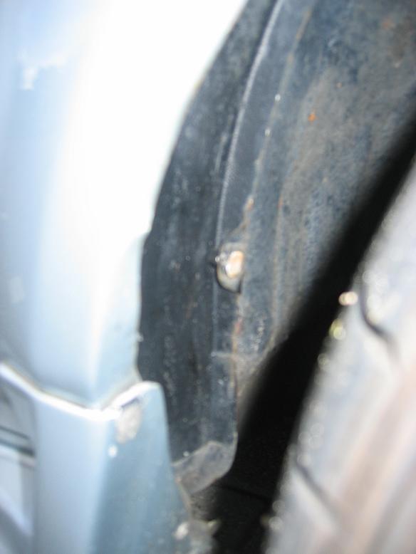

I mounted my SSR 15x8 off -2 in the front with toyo proxes t1r 195/50 but i cant steer fullout. It touches the place where two panels comes together (velsrand?). Are there people who have experience with this?

I don't know how much it rubs. Maybe that you can "hammer" that lip a bit?
Or adjust your caster? Only ideas though... |

ja gewoon platrammen een beetje,het komt omdat die wielen iets breder zijn

TE71corolla Wrote:ja gewoon platrammen een beetje,het komt omdat die wielen iets breder zijn ja zat ik ook al aan te denken maar wist niet of ik dan me body naar de maan zou helpen

I had the same problem with my set of Sportmax 15x8 offset 0. The tyres are the same.
Try heating up the plastic and then bend it a litle. Or, just wait until the tyre is able to bend the plastic... or break it.... like in my case!

I had the same problem on my car I just cut the seam back and re welded it..
