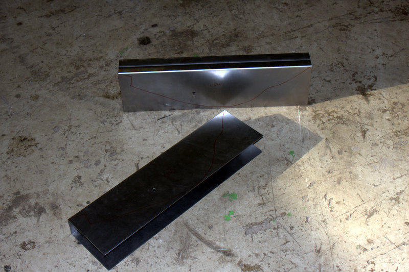

The housings for the upper links are now done and partially welded into place. The "humps" for the original brackets gave some of trouble but a bit of adjusting with an angle grinder fixed it. Although now I need to fill the gap I made with the MIG.
